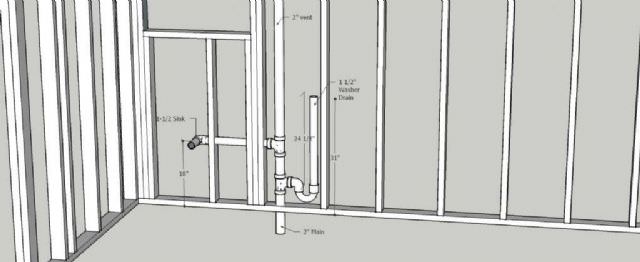

David Meiland Posted May 18, 2015 Report Share Posted May 18, 2015 Suggested as a possible answer on another forum... could the maximum clothes washer trap height be based on the strong possibility that the installation would also include a sink, and the sink trap could be siphoned if the clothes washer discharge is above it? Stole the attached pic from the web, showing a typical install with a sink. Imagine the laundry trap well above the sink tee... Click to Enlarge 24.74 KB Quote Link to comment Share on other sites More sharing options...

John Kogel Posted May 18, 2015 Report Share Posted May 18, 2015 Suggested as a possible answer on another forum... could the maximum clothes washer trap height be based on the strong possibility that the installation would also include a sink, and the sink trap could be siphoned if the clothes washer discharge is above it? Stole the attached pic from the web, showing a typical install with a sink. Imagine the laundry trap well above the sink tee... Click to Enlarge 24.74 KB That 2" vent stack provides plenty of air for the standpipe to drain, I think. There could be a sink on the floor below, not a problem with suction from the stack, I don't think. But I'm not plumber, so I'm open to correction. Quote Link to comment Share on other sites More sharing options...
Jim Katen Posted May 18, 2015 Author Report Share Posted May 18, 2015 Suggested as a possible answer on another forum... could the maximum clothes washer trap height be based on the strong possibility that the installation would also include a sink, and the sink trap could be siphoned if the clothes washer discharge is above it? Stole the attached pic from the web, showing a typical install with a sink. Imagine the laundry trap well above the sink tee... Click to Enlarge 24.74 KB Seems like a real stretch. Wet venting is either not allowed or allowed with caveats by the various plumbing codes. Quote Link to comment Share on other sites More sharing options...
