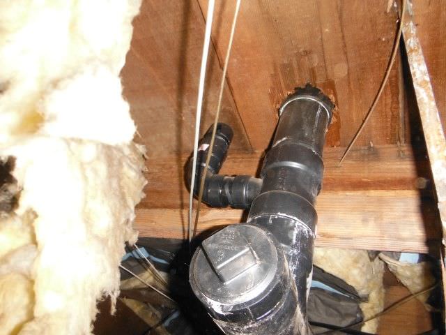

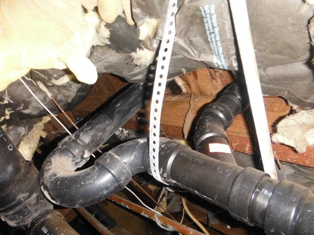

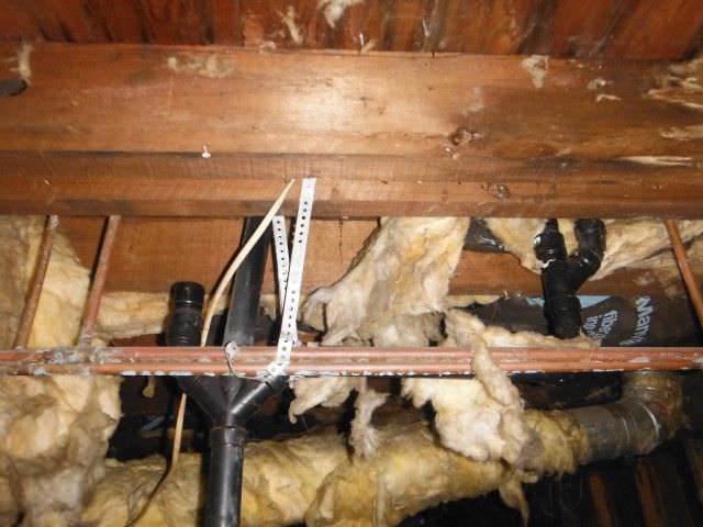

Denray Posted July 7, 2015 Report Share Posted July 7, 2015 S-traps above and mechanical vents below. Bogus? Toilet drain with mechanical vent. Bogus? A tub drain had a m vent too. Click to Enlarge 61.56 KB Click to Enlarge 57.99 KB Click to Enlarge 70.35 KB Quote Link to comment Share on other sites More sharing options...

inspector57 Posted July 7, 2015 Report Share Posted July 7, 2015 Those mechanical vents are totally OK to use... IF this is a MOBIL/Manufactured home. Otherwise it is no Bueno. Quote Link to comment Share on other sites More sharing options...

Tom Raymond Posted July 7, 2015 Report Share Posted July 7, 2015 An AAV has to be above the flood level of the fixture it is connected to. These are all wrong, regardless of what code the dwelling falls under. Quote Link to comment Share on other sites More sharing options...
Denray Posted July 7, 2015 Author Report Share Posted July 7, 2015 Found this: 918.4 Location. Individual and branch-type air admittance valves shall be located a minimum of 4 inches (102 mm) above the horizontal branch drain or fixture drain being vented. Stack-type air admittance valves shall be located not less than 6 inches (152 mm) above the flood level rim of the highest fixture being vented. The air admittance valve shall be located within the maximum developed length permitted for the vent. The air admittance valve shall be installed not less than 6 inches (152 mm) above insulation materials. Quote Link to comment Share on other sites More sharing options...
Bill Kibbel Posted July 7, 2015 Report Share Posted July 7, 2015 An AAV has to be above the flood level of the fixture it is connected to. These are all wrong, regardless of what code the dwelling falls under. Around here 'A' Rated AAVs are permitted below the rim but must be 6" above the trap. Quote Link to comment Share on other sites More sharing options...
mjr6550 Posted July 8, 2015 Report Share Posted July 8, 2015 An AAV has to be above the flood level of the fixture it is connected to. These are all wrong, regardless of what code the dwelling falls under. Around here 'A' Rated AAVs are permitted below the rim but must be 6" above the trap. Bill, I never heard of an A rated AAV. Is that an official designation? I thought that AAVs are AAVs and mechanical vents are not. Mechanical vents are only approved for manufactured homes and RVs. Quote Link to comment Share on other sites More sharing options...
Bill Kibbel Posted July 8, 2015 Report Share Posted July 8, 2015 An AAV has to be above the flood level of the fixture it is connected to. These are all wrong, regardless of what code the dwelling falls under. Around here 'A' Rated AAVs are permitted below the rim but must be 6" above the trap. Bill, I never heard of an A rated AAV. Is that an official designation? I thought that AAVs are AAVs and mechanical vents are not. Mechanical vents are only approved for manufactured homes and RVs. I'm specifically referring to AAVs, not mechanical vents for mobile homes. Quality AAVs for branch drains or fixture drains are not required to terminate above the flood rim. Only stack AAVs need to be above the flood level rim of the highest fixture being vented. Quote Link to comment Share on other sites More sharing options...
