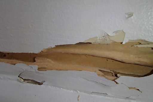

mjr6550 Posted September 22, 2015 Report Share Posted September 22, 2015 I performed a structural inspection today and this was identified as termite damage. The smooth channels look more like carpenter ants, but the frass makes me think this is some type of beetle. I mainly want to confirm that it is not termite damage. BTW, no drywood termites in this area. Click to Enlarge 18.6 KB Click to Enlarge 26.04 KB Click to Enlarge 18.46 KB Quote Link to comment Share on other sites More sharing options...

Bill Kibbel Posted September 22, 2015 Report Share Posted September 22, 2015 What's the shape of the pellets? Quote Link to comment Share on other sites More sharing options...
mjr6550 Posted September 22, 2015 Author Report Share Posted September 22, 2015 Cylindrical. Maybe about twice as long as the diameter. I could sent you a larger photo if you would like. Quote Link to comment Share on other sites More sharing options...
mjr6550 Posted September 23, 2015 Author Report Share Posted September 23, 2015 A couple more photos. Old house borers is a possibility. The pellets look a lot like photos of drywood termite pellets, but I have never seen them and they would be rare for this area. From what I have read they eat across the grain. This wood was channeled along the grain. Click to Enlarge 37.2 KB Click to Enlarge 23.39 KB Quote Link to comment Share on other sites More sharing options...
ghentjr Posted September 23, 2015 Report Share Posted September 23, 2015 Google Drywood Termite Frass Carpenter ants sometimes attack termite infestations. The last photo looks like carpenter ant damage except for the frass. Quote Link to comment Share on other sites More sharing options...
John Kogel Posted September 24, 2015 Report Share Posted September 24, 2015 I don't think you can say termites always cut across the grain, They can cut across, but will run with the grain if the wood tastes good that way. There's not enough clues in those pics to make a definite call. Quote Link to comment Share on other sites More sharing options...

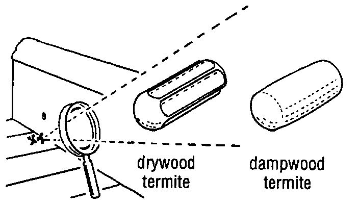

rdhutch Posted September 25, 2015 Report Share Posted September 25, 2015 That is not wood boring beetles. That frass is from Drywood Termites. Under a strong magnifying glass or microscope the fecal pellets look like this: Click to Enlarge 7.26 KB Quote Link to comment Share on other sites More sharing options...
