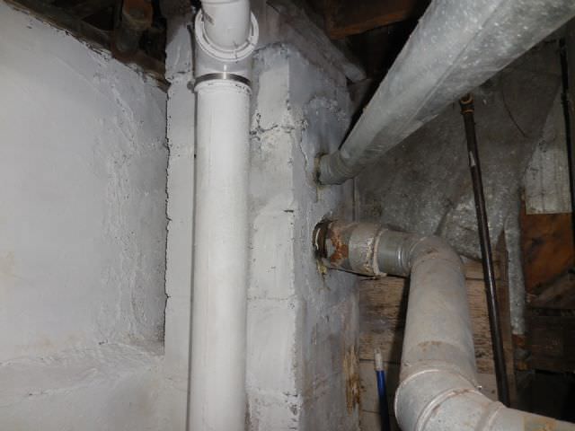

asihi Posted December 3, 2015 Report Share Posted December 3, 2015 I'm looking to see if I could get some clarification. I did an older building yesterday that had an interior flue that vents the Cat1 furnace and water heater made from chimney blocks. I couldn't get on the roof because of the snow, but there was a small opening at the base where I could see that it wasn't lined. Most unlined flues that I see are made of single wythe brick, which is an easy call, but this block kind of threw me for a loop. The Chimney Safety Institute defines a chimney liner as clay, ceramic or metal conduit, so I think I have my answer, but I want to check here just to get other opinions just to make sure. Am I correct? This flue is unlined? Thanks for your help Tony Click to Enlarge 39.1 KB Link to comment Share on other sites More sharing options...

asihi Posted December 3, 2015 Author Report Share Posted December 3, 2015 ...what I have heard called "flue block". I don't see why a liner is needed if the venting is only for gas furnace/appliance. A solid fuel chimney would of course want clay liner as well as a clay thimble at the connection. I guess why I'm having a hard time with this is because of the furnace. Category 1 gas fired furnaces aren't allowed to vent into an unlined flue. Would a flue made of this block considered to be lined? Link to comment Share on other sites More sharing options...
kurt Posted December 3, 2015 Report Share Posted December 3, 2015 Tony, you're overthinking it. It's completely reasonable and smart to indicate there should be a liner in any masonry combustion gas vent, regardless of the building material. Any mildly competent heating tech will tell you a liner is, at minimum, desirable, even if they don't say it's "required". I always tell folks to put a liner in these things. If someone finds a moron that says it's not required, that's their prerogative. Their prerogatives do not change my opinion. Link to comment Share on other sites More sharing options...
Bill Kibbel Posted December 4, 2015 Report Share Posted December 4, 2015 The blocks used for that chimney are intended to contain a terra cotta tile liner. There's no doubt that chimney needs to be lined. When I can't see the interiors of chimneys any other way, it's amazing how often vent connectors just happen to come apart all by themselves (when nobody is looking). Link to comment Share on other sites More sharing options...

mjr6550 Posted December 4, 2015 Report Share Posted December 4, 2015 Just chimney block=unlined flue. Needs a lining. If you are not sure, say that it does not appear to have a lining, and call for relining if that is confirmed. Link to comment Share on other sites More sharing options...
kurt Posted December 4, 2015 Report Share Posted December 4, 2015 When I can't see the interiors of chimneys any other way, it's amazing how often vent connectors just happen to come apart all by themselves (when nobody is looking). Exactly. That top water heater connector looks like it would come out easy. Link to comment Share on other sites More sharing options...

Hearthman Posted February 15, 2016 Report Share Posted February 15, 2016 Chimney block are just a simplified way of meeting the minimum 4" nominal masonry unit chimney thickness. However, ALL chimneys must be lined and has been a code requirement since 1927. The chimney must be suitable for the class of service, too. The flue must be properly sized for the attached appliances. Since this is an interior chimney, it should have a 2" clearance to combustibles and firestopping at each floor/ ceiling. In the photo provided, the vent connectors are not properly supported, are not properly sealed to the chimney, do not appear to have a thimble or sleeve and there is no cleanout 12" below the breeching. A Level II inspection is triggered here per NFPA 211. Link to comment Share on other sites More sharing options...

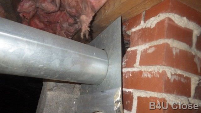

Erby Posted February 17, 2016 Report Share Posted February 17, 2016 Timely. Ran into this one today. Click to Enlarge 37.9 KB Link to comment Share on other sites More sharing options...
