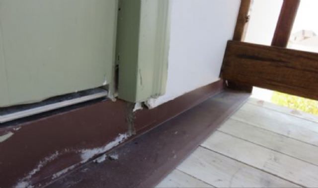

Marc Posted September 13, 2016 Report Share Posted September 13, 2016 These balconies are showing up by the hundreds in new subdivisions around me. I had thought that it was not possible to properly flash a deck that sits on joists that are simply extensions of interior joists. Click to Enlarge 35.7 KB Click to Enlarge 21.42 KB Has there been a breakthru in deck flashing? Marc Quote Link to comment Share on other sites More sharing options...
John Dirks Jr Posted September 13, 2016 Report Share Posted September 13, 2016 Even though the joists may penetrate the wall, I see what looks like a ledger of sorts above the joists. Is it possible that could be flashed well enough to prevent water intrusion? Quote Link to comment Share on other sites More sharing options...
Marc Posted September 13, 2016 Author Report Share Posted September 13, 2016 Even though the joists may penetrate the wall, I see what looks like a ledger of sorts above the joists. Is it possible that could be flashed well enough to prevent water intrusion? That's a flashing/counterflashing pair. The flashing part is a pan. The counterflashing does not extend horizontally beyond the threshold of the door. Perhaps the reasoning is that it acts as a narrow roof of sorts to keep rainwater from reaching the unflashed areas beneath it. It doesn't inspire me and I can't decide whether to write it up. Marc Quote Link to comment Share on other sites More sharing options...
kurt Posted September 13, 2016 Report Share Posted September 13, 2016 We call it a horse collar; it's just like a horse collar with flanges, and you bring the cladding over the flanges to counter flash it. The top inside of the horse collar is reglet-ed into the joist, or caulked. Quote Link to comment Share on other sites More sharing options...
Marc Posted September 13, 2016 Author Report Share Posted September 13, 2016 We call it a horse collar; it's just like a horse collar with flanges, and you bring the cladding over the flanges to counter flash it. The top inside of the horse collar is reglet-ed into the joist, or caulked. Anyone writes that up? Marc Quote Link to comment Share on other sites More sharing options...
kurt Posted September 13, 2016 Report Share Posted September 13, 2016 I do. No one does it though. We've done them on a couple repairs. About the most you're ever going to find is what you got now. Quote Link to comment Share on other sites More sharing options...
Jim Baird Posted September 13, 2016 Report Share Posted September 13, 2016 ...I agree it looks like best thing going for a penetrating floor member. It means it will last a little longer. Quote Link to comment Share on other sites More sharing options...
BADAIR Posted September 14, 2016 Report Share Posted September 14, 2016 no worries gap @ brick mold will be blamed when the rot appears Click to Enlarge 22.32 KB Quote Link to comment Share on other sites More sharing options...
Marc Posted September 14, 2016 Author Report Share Posted September 14, 2016 I wrote it up: An inspection once every three years by a licensed contractor, licensed architect or licensed engineer. Hopefully it'll intercept the rot before it causes a collapse but more likely it'll just end up as a CYA on my part for the day when a balcony does collapses, folks get hurt and the lawyers come running. Marc Quote Link to comment Share on other sites More sharing options...

Mike Lamb Posted November 19, 2016 Report Share Posted November 19, 2016 I had thought that it was not possible to properly flash a deck that sits on joists that are simply extensions of interior joists. After framing, before moisture barrier and siding is installed, a header flashing gets installed over the joists. Then the siding, etc. becomes the counter flashing. Then the deck boards get put on. Doors need their own pan flashing. Coordinating everything right during construction is a perfect storm. Most thru wall joists I see have no flashing and get caulked all around. I'm not that concerned about rot. They leak into the building. Quote Link to comment Share on other sites More sharing options...
