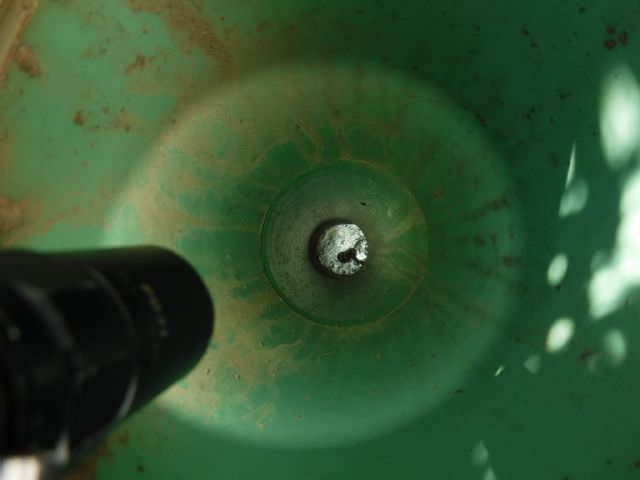

Mike Lamb Posted September 16, 2016 Report Share Posted September 16, 2016 If I can open up an exterior sewer clean-out without too much difficulty, I do. Sometimes I find a couple few inches of water in them meaning poor drain but today I saw pure funk. I ran the house water and it sounded like water was flowing beneath the funk. Click to Enlarge 68.33 KB Click to Enlarge 24.22 KB Click to Enlarge 41.53 KB Link to comment Share on other sites More sharing options...
Jim Katen Posted September 16, 2016 Report Share Posted September 16, 2016 What you've got there is your basic belly, or low spot, in the sewer line. The product sits in the low spot and floats on water as it goes by. Just about every inspection I do also has a sewer scope done at the same time. It's amazing what those guys find. Link to comment Share on other sites More sharing options...

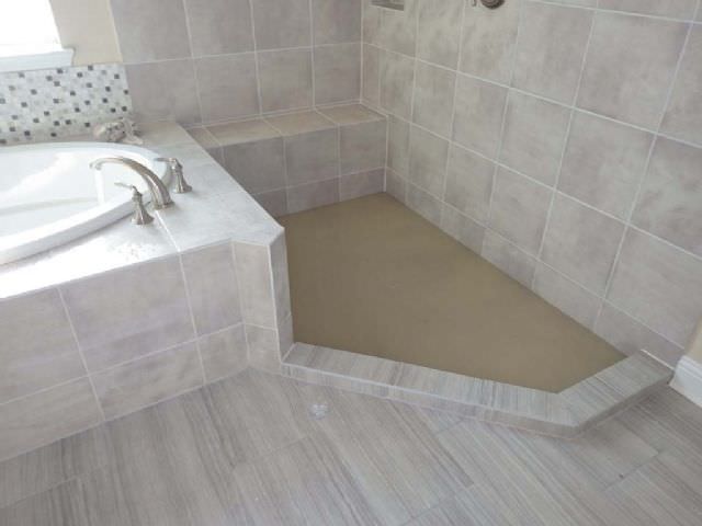

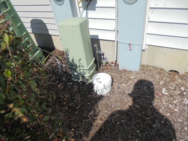

BADAIR Posted September 19, 2016 Report Share Posted September 19, 2016 it's not just older systems around here that get the sewer scope recommendation a good percentage of my biz is new construction phase inspections i often find blocked drain lines within the structure & out to & including the city tie in much is caused by the trades stepping on improperly supported piping during the foundation pour or dumping unused materials down the drains during construction a few deficiencies from recent new construction inspections were backing up at shower pans, clean outs damaged/broken during snaking attempts and shower pan/dwv leakage i have to attempt to remove all clean out covers & often find detached or broken pipes Click to Enlarge 31.28 KB Click to Enlarge 52.86 KB Click to Enlarge 55.91 KB Link to comment Share on other sites More sharing options...
