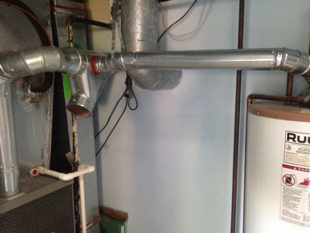

JayCarey Posted September 27, 2016 Report Share Posted September 27, 2016 Please see attached picture. A furnace (on left) and water heater (on right) are connected to a single single wall pipe which feeds directly into B vent pipe at a distance of about a foot from the single wall pipe. The B vent pipe cannot be seen in the picture but runs behind the furnace for about 6 feet to a newly installed B vent chimney flue (run inside an old clay lined chimney). Is it okay to connect both the furnace and water heater to a single pipe as shown in the picture? When both appliances are running will a backdraft be created through the water heater? Is this safe? Thanks for your help Download Attachment: IMG_0116.JPG 1511.28?KB Click to Enlarge 44.77 KB Quote Link to comment Share on other sites More sharing options...
Charlie R Posted September 27, 2016 Report Share Posted September 27, 2016 From what I can see, I would like to have the furnace running for a few minutes, the water heater not, and see if I am getting any back-draft at the water heater hood. Certainly looks like a possibility. Any soot at the hood, or other discoloration, or rusting? Quote Link to comment Share on other sites More sharing options...
Bill Kibbel Posted September 28, 2016 Report Share Posted September 28, 2016 You can combine 2 vent connectors into a common vent connector, provided it is sized and installed correctly. What's shown in the picture, with the WH vent connector shoved into a hole cut in the side of a wye, is just really wrong. The slope of the 2 vent connectors doesn't look right from this angle. I'd like to see the rest of the vent system to see what else was done. 1 Quote Link to comment Share on other sites More sharing options...
Jim Katen Posted September 28, 2016 Report Share Posted September 28, 2016 That's a seriously wrong installation done by someone who didn't have a clue. Yes, it could be dangerous. Quote Link to comment Share on other sites More sharing options...
Chad Fabry Posted September 28, 2016 Report Share Posted September 28, 2016 In case you think the comments are directed at your specific concern only, the installation is wrong in just about every regard. Quote Link to comment Share on other sites More sharing options...
kurt Posted September 28, 2016 Report Share Posted September 28, 2016 Do they get extra credit for cutting that nice round hole in the side of the wye? You gotta admit that took some creative interpretation and skill. Quote Link to comment Share on other sites More sharing options...
JayCarey Posted September 28, 2016 Author Report Share Posted September 28, 2016 I had a chimney company run a new stainless steel liner down my chimney and this is how they connected the furnace and water heater to connect to the liner in the chimney. At the time, I suspected there may be something wrong with this setup but not being an expert, did not question. Further research, on sites such as this, made me suspect potential problems. Previously, the water heater and furnace had 2 separate vent pipes running to a clay lined chimney with the water heater vent pipe above the furnace vent pipe. I believe this was a good venting situation. Now, there is only one connection into the stainless steel chimney liner and the picture posted is how the chimney lining company solved the venting of 2 units (furnace and water heater) into 1 liner opening. I have no intention of going back to the chimney liner company for a solution to this issue. I suppose my path forward is to call my HVAC company and have them examine and correct the issue. Do you have ideas as to how I will be able to successfully vent both water heater and furnace into one chimney liner opening? Any help would be appreciated. I just want to be able to speak intelligently with whomever I hire to resolve this issue. Thanks. Quote Link to comment Share on other sites More sharing options...
kurt Posted September 28, 2016 Report Share Posted September 28, 2016 Run them both into a (new) wye and increase the size of the "exhaust" side the next size up. An HVAC tech may determine that they need to resize both flue connectors, and I hate to say it, but possibly even the liner. Anyone that would mangle together an assembly like that might not know they have to size everything based on the output of the appliances. Quote Link to comment Share on other sites More sharing options...

Jim Katen Posted September 29, 2016 Report Share Posted September 29, 2016 There's nothing fundamentally wrong with venting them together into the chimney. It's just that this guy did everything wrong. From what I can see in the pictures, it looks like the biggest problem will be height. The two vent connectors should join high in the room. Also, the water heater vent connector needs to go up about 12 inches vertically before it turns to run horizontally. Quote Link to comment Share on other sites More sharing options...
Mike Lamb Posted October 3, 2016 Report Share Posted October 3, 2016 Also, the water heater vent connector needs to go up about 12 inches vertically before it turns to run horizontally. I have read about a 12" minimum rise for priming but can't find the coded reference. Is this something you would find in the tables? Quote Link to comment Share on other sites More sharing options...
Jim Katen Posted October 4, 2016 Report Share Posted October 4, 2016 Also, the water heater vent connector needs to go up about 12 inches vertically before it turns to run horizontally. I have read about a 12" minimum rise for priming but can't find the coded reference. Is this something you would find in the tables? Yes but, as I recall, it only applies when venting the water heater with another appliance. Quote Link to comment Share on other sites More sharing options...
Marc Posted October 4, 2016 Report Share Posted October 4, 2016 I've seen it as instruction from the manufacturer. From Duravent: 8. Connector Rise. Plan a minimum of onefoot vertical connector rise coming out of each appliance. Marc Quote Link to comment Share on other sites More sharing options...
