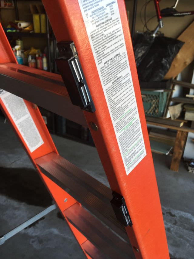

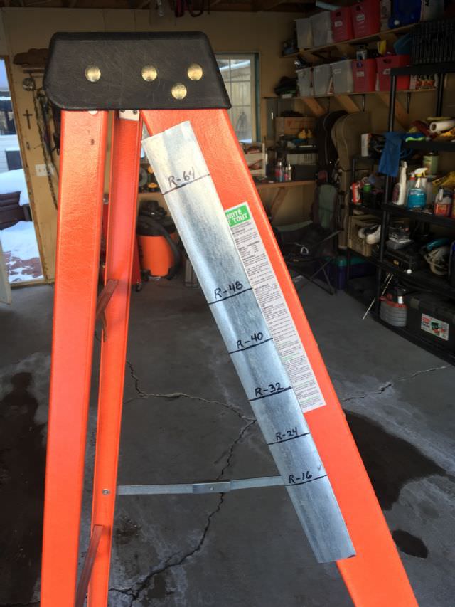

Leighton Jantz Posted January 13, 2017 Report Share Posted January 13, 2017 I made my own insulation measuring tool, maybe some of you have been doing this for years. Took a piece of sheet metal, folded edges over (stiffens tool and prevents getting cut). Then attached a couple of cabinet door magnets to the rail of my "indoor" ladder, always handy! Do I need a patent? Click to Enlarge 80.14 KB Click to Enlarge 75.05 KB Quote Link to comment Share on other sites More sharing options...

Leighton Jantz Posted January 14, 2017 Author Report Share Posted January 14, 2017 Only 1 of 3 ladders I have on truck. This can be attached to any size ladder for half pints. And 6' ladder is all that's required for 10' ceilings as I am almost 6'8. Me and crawlspaces don't get along well. Quote Link to comment Share on other sites More sharing options...
Mark P Posted January 14, 2017 Report Share Posted January 14, 2017 I don't get it, besides the R factor will differ depending on the type on insulation. Quote Link to comment Share on other sites More sharing options...
Leighton Jantz Posted January 14, 2017 Author Report Share Posted January 14, 2017 It's set up for blown-in fibreglass insulation which is most common in my area. I find it handy, 4 out of 6 or 7 inspections it works. Older homes with multiple layers of different insulation- it won't work either. You kind of need to use your judgment. It's a tool, you have to be smarter than the tool. Anyone know how I can delete "epiphany" from thread title? Quote Link to comment Share on other sites More sharing options...

Leighton Jantz Posted January 14, 2017 Author Report Share Posted January 14, 2017 How can that work, 1" of blown in can have R-value of 2.2-4.3 depending on settlement. If you have 10" of insulation that could be R-value of anywhere from R-22 to R-43? My point is this isn't exact, it's handy. Quote Link to comment Share on other sites More sharing options...

John Kogel Posted January 15, 2017 Report Share Posted January 15, 2017 Good idea, the depth gauge. Take a pic, there's your insulation depth. The varying R value maybe would require a sliding scale on there, like a slide rule. Then you'd have something to patent.[:-magnify Quote Link to comment Share on other sites More sharing options...
Leighton Jantz Posted January 16, 2017 Author Report Share Posted January 16, 2017 After Mark P's post I was thinking about working on the slide rule. This just stands up in blown-in Fiberglas on its own for pictures. The wheels are turning. Quote Link to comment Share on other sites More sharing options...
John Kogel Posted January 16, 2017 Report Share Posted January 16, 2017 Since there are 4 sides to a piece of angle sheet metal, you could draw 4 different scales on there and just face the correct one to the camera. Fiberglass, cellulose, Rocksul, uh ....shredded bark? [] Now about your choice of ladders: Fiberglass is heavy but you are a big boy. I used one of those for a portable desk, added a plywood tray with 2 zap straps. I did the odd attic hatch but was not thrilled stepping down onto the top step, which is not a step. My conclusion is that you are not venturing into the attic. Your choice, but walking or crawling the attic reveals stuff nobody sees such as mold, loose pipes, wasp nests, cracked rafters and more. Fire damage. If Telesteps is too light duty for you, an aluminum extension ladder can slide into a closet, past the clothes pole, easier than any step ladder. Quote Link to comment Share on other sites More sharing options...
