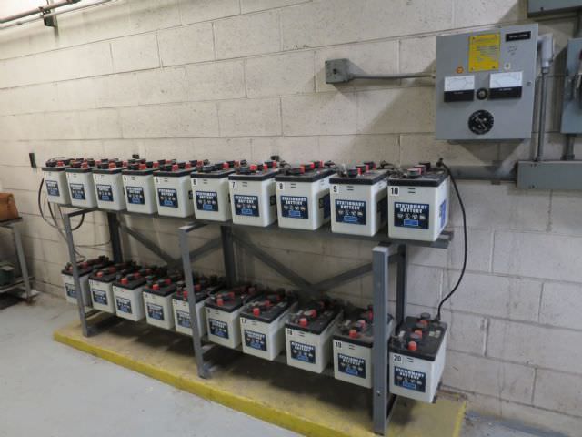

MPdesign Posted January 30, 2017 Report Share Posted January 30, 2017 You could always build- it yourself. Buy some batteries and the right trickle charger.... I will admit - this is 120 V DC not AC Click to Enlarge 48.69 KB Quote Link to comment Share on other sites More sharing options...
