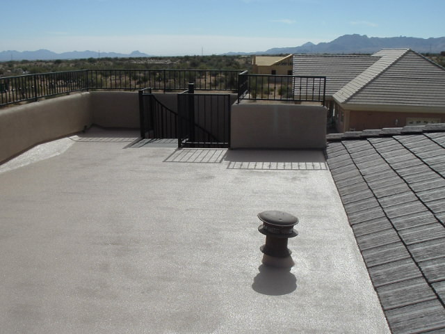

chrisprickett Posted February 9, 2006 Report Share Posted February 9, 2006 One of my guys just sent me this pic. I'm looking it up but so far can't find anything in the 03' IRC. I'm thinking there's got to be something related to a burn hazard. (I could se a toddler sitting on it) I did note the lack of safety rail at the right side of the pic. Any assistance (quickly) would be appreciated. I've got several other things to get done before my eyeballs explode! Download Attachment: Stupid vent termination.jpg 128.15 KB Quote Link to comment Share on other sites More sharing options...
hausdok Posted February 9, 2006 Report Share Posted February 9, 2006 Hi Chris, I dunno, it looks like it meets the 1ft height rule and I touch them all the time and I rarely find 'em hot enough to burn my hand. Still, it is puzzling. Wonder if one could legally fabricate a box out of wire mesh and put it around that thing to keep curious little hands and fingers off? ONE TEAM - ONE FIGHT!!! Mike Quote Link to comment Share on other sites More sharing options...
kurt Posted February 9, 2006 Report Share Posted February 9, 2006 Mfg. sez 1" clearance to combustible; it looks like you do because they got the collar for a standoff. Never found a B vent hot enough to burn anything, & I see several each week in this same general arrangement. This is Chicago, & they're cooking all the time; I always touch 'em to see, & they're always touchable. If you got clearance to combustible, I wouldn't worry about it. Quote Link to comment Share on other sites More sharing options...
randynavarro Posted February 9, 2006 Report Share Posted February 9, 2006 Only thing I can think that might be comparable from a common sense standpoint is the 7' rule for plumbing vent terminations on a rooftop / deck. Why would a plumbing vent need to vent this high? I guess so that nobody sucks down sewer gas. One might make the argument that a person shouldn't be exposed to the exhaust gasses spewing out the top of the B-vent either. Other than than, I couldn't find any thing specific in writing saying this configuration is dis-allowed. Quote Link to comment Share on other sites More sharing options...
Jim Katen Posted February 9, 2006 Report Share Posted February 9, 2006 G2427.6.5 says that gas vents have to terminate above a roof surface. Is that a roof or a deck? What's the listing sheet call it? If that's a deck, I'd say that the vent's in the wrong place. - Jim Katen, Oregon Quote Link to comment Share on other sites More sharing options...
kurt Posted February 9, 2006 Report Share Posted February 9, 2006 Ya know, it should be considered a deck because of the stair access, no? There is, of course, the fact that it's never, ever, ever going to be moved, altered, or anything else. Quote Link to comment Share on other sites More sharing options...
chrisprickett Posted February 9, 2006 Author Report Share Posted February 9, 2006 Originally posted by Jim Katen G2427.6.5 says that gas vents have to terminate above a roof surface. Is that a roof or a deck? What's the listing sheet call it? If that's a deck, I'd say that the vent's in the wrong place. - Jim Katen, Oregon thanks, Jim, I thought of that too. The problem is that I'm not doing the inspection, and that call can be seen as splitting hairs- the AHJ blessed it. I had my guy call it out as a potential burn hazard-from a common sense POV. (BTW Kurt- I have felt those puppies get very hot!) Quote Link to comment Share on other sites More sharing options...
gbrasseur Posted February 1, 2007 Report Share Posted February 1, 2007 i know this is an old post, but figured I would respond. From the pic it looks like a roof. There sould be no less than 3 feet of clearance above the roof surface, and no less than 2 feet clearance above any surface less than 10 feet away. Quote Link to comment Share on other sites More sharing options...
rjw Posted February 1, 2007 Report Share Posted February 1, 2007 Originally posted by gbrasseur i know this is an old post, but figured I would respond. From the pic it looks like a roof. There sould be no less than 3 feet of clearance above the roof surface, and no less than 2 feet clearance above any surface less than 10 feet away. Is that 3' rule local or new? As I understand the GAMA rules, it's 2' above any vertical surface within 10' and distance above the roof depends on pitch, with the minimum being less tahn 3' (I don't have my table with me right now) Quote Link to comment Share on other sites More sharing options...
