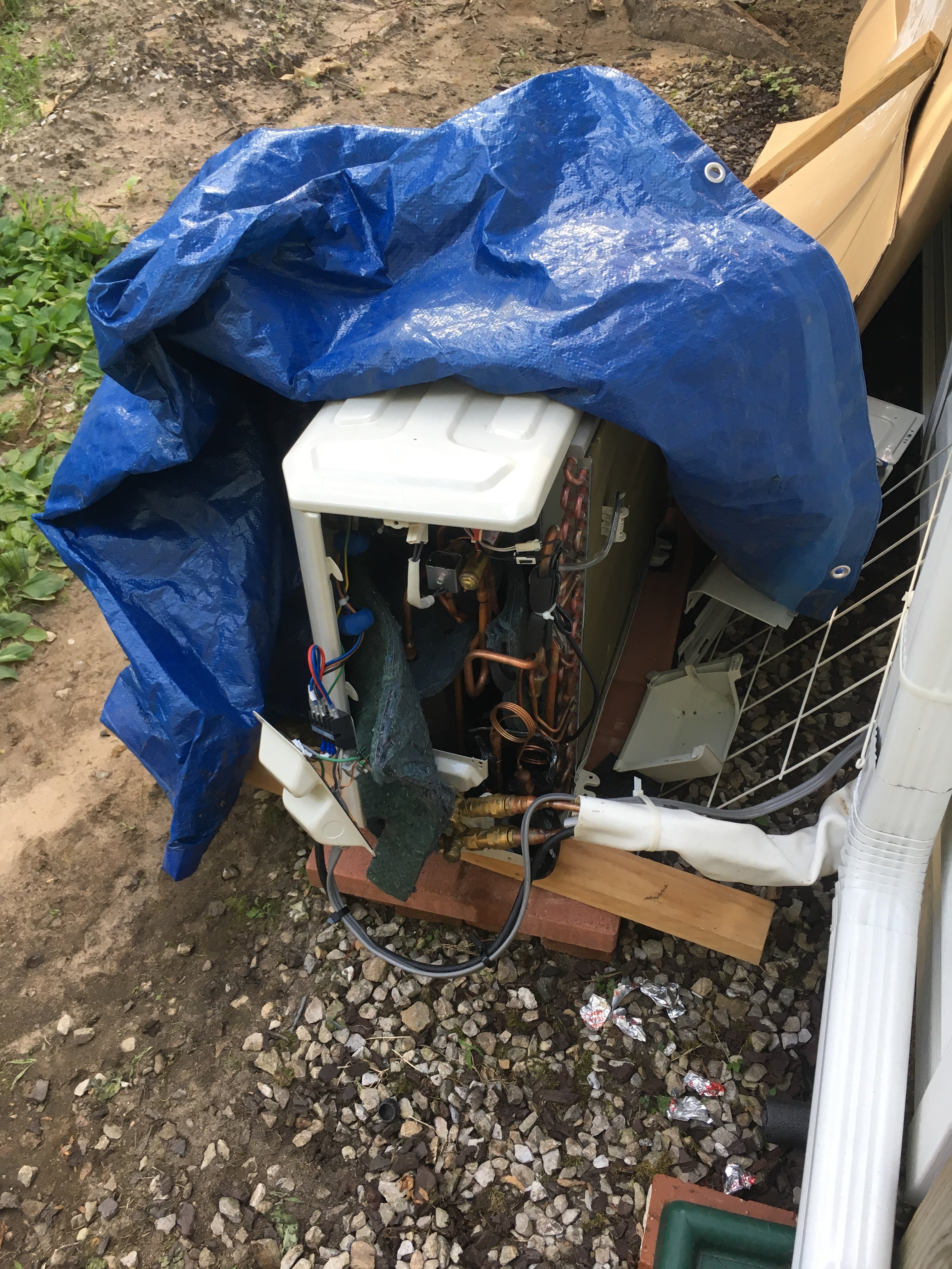

John Dirks Jr Posted June 8, 2019 Report Share Posted June 8, 2019 (edited) Hi folks, I recently installed a Mr Cool DIY mini split system. This one It comes with a pre charged line set. The installation went well and the system worked fantastic for a few weeks but then the cooling performance dropped substantially. I noticed the the high side line frosting up and a little research tells me that blockage in the line set is a likely culprit. I removed the panel to observe the innards and ran the system to watch. Now, please understand that on this system, the high side line exists of two very small lines that run the distance from the evap to the condenser. The only exception is these two tiny lines come together into a larger line at the fitting connection to the condenser unit. Then, they split back into two tiny lines inside of the condenser body. From there, one of the tiny lines loops back to the junction and the other goes through what looks like a small inline filter or dryer. At the other side of this little inline thing, the line gets larger and runs directly to the bottom of the condenser core. In the pictures below you'll see the tiny high side line spun in a coil. During my observations, one side of the coiled line frosts up during the heat cycle, and the other side frosts up during the cooling cycle. This makes me think there is a blockage in this coiled portion of high side line. What do you think? Blockage here or possibly something else to consider? If it is a blockage here, is there a way to clear it up or am I left with hiring a pro to cut out and replace the blocked portion? First pic shows frosting during heat mode. Second picture shows frosting during cooling mode. I'm thinking theres blockage in the tiny coiled line. Edited June 8, 2019 by John Dirks Jr Quote Link to comment Share on other sites More sharing options...
Marc Posted June 8, 2019 Report Share Posted June 8, 2019 This is the first I've ever heard of a liquid line divided between two smaller lines, unless there is more than one indoor section to the single outdoor section. The coiled tubing looks exactly like capillary tubes, which take the place of an expansion valve. They will frost up in high humidity. I'd check temperature differentials to confirm that you do indeed have a problem. Assuming you do have an issue, the most useful diagnostic move towards isolating the issue is to put the gauges on the system and see what the pressures are. If I were to take a guess, you either don't have an issue or you've a low refrigerant charge resulting from a refrigerant leak. Quote Link to comment Share on other sites More sharing options...
John Dirks Jr Posted June 8, 2019 Author Report Share Posted June 8, 2019 No doubt there is a problem. I can get a 20+ degree differential in the heat mode. 70 in 93 out. In the cooling mode, very little temp drop, especially after the line frosts up. And it is the high line frosting up. Cooling diff just a few degrees at best. While it was working good prior to the issue, condensate would be coming out the drain line and running down the driveway in a stream. Now, it still comes out but only in a faint trickle. Again, good exchange on heat cycle, poor exchange in cooling. The head unit does not have electric backup heat so the exchange in the heat cycle suggests that maybe the refrigerant charge is ok. But I’m not sure of that. Quote Link to comment Share on other sites More sharing options...
Marc Posted June 8, 2019 Report Share Posted June 8, 2019 You can get a heating differential with low refrigerant charge on account of that heat coming from the compressor discharge but cooling differential depends on having enough charge to hold off expansion of the liquid until it reaches the capillary tubes. I think that might be what's happening; the liquid is evaporating before it reaches the capillary tubes in the indoor section. A single lo-side gauge connected to the vapor line, with the system in cool mode, might be all you need to identify a low refrigerant charge. Charging it requires gauges. I looked at the two photos again. The first one shows liquid returning to the outdoor section evaporating before it even reaches the capillary tube. It's supposed to remain liquid until it passes the tube. The tube is the constriction device that creates the pressure differential across the compressor. The second photo shows liquid exiting the condenser coil evaporating already, still inside the condenser section. It's supposed to remain liquid until it arrives at the capillary tube in the indoor section. Low refrigerant charge. Quote Link to comment Share on other sites More sharing options...

John Dirks Jr Posted June 8, 2019 Author Report Share Posted June 8, 2019 I used dish washing detergent on the fittings both while shut down and in operating modes. No signs of leaks at the fittings whatsoever. When put in cooling mode, the frosting of the high side line happens really quick. Like 30 seconds it begins and by one minute it’s frosted over totally. It’s not humid at all here today. Are we sure there’s no chance of an internal blockage? Quote Link to comment Share on other sites More sharing options...

Marc Posted June 8, 2019 Report Share Posted June 8, 2019 (edited) Let the gauges speak first. Give me the readings, along with indoor and outdoor temps. The symptoms shown in the two photos don't suggest a blockage. A blockage would have frost immediately adjacent to it. Course, I could be wrong. Edited June 8, 2019 by Marc Quote Link to comment Share on other sites More sharing options...
John Dirks Jr Posted June 9, 2019 Author Report Share Posted June 9, 2019 Well, one side of that tiny coiled high line frosts in the heat cycle, and the other side in the cooling cycle. I can duplicate over and over and it happens quickly. Like nothing is passing through that tiny coil. Quote Link to comment Share on other sites More sharing options...
Marc Posted June 9, 2019 Report Share Posted June 9, 2019 I see two coiled lines and the refrigerant isn't taking the same path on both photos. One of the small tubes is used for cooling mode, the other for heating mode. Quote Link to comment Share on other sites More sharing options...
John Dirks Jr Posted June 9, 2019 Author Report Share Posted June 9, 2019 (edited) The second coiled line you see in the back loops right back to the high side line. It’s like this. There’s larger line that comes through the case from the fitting (high side). This line goes into a bubble like thingy. Then the two tiny coiled lines come out of the other side of the bubble. One of the coiled lines goes to the evap core. The other coiled line just returns to this bubble thingy that it came from. So, the way I see it, both tiny coiled lines are on the high side. Because one just comes from the high line, then returns right back to it. So, for any refrigerant to pass through the evap, no matter what direction or mode, it has to pass through the tiny coiled line in the foreground of the pictures. Edited June 9, 2019 by John Dirks Jr Quote Link to comment Share on other sites More sharing options...
Marc Posted June 9, 2019 Report Share Posted June 9, 2019 Could that bubble like thingy be a check valve? Quote Link to comment Share on other sites More sharing options...
John Dirks Jr Posted June 9, 2019 Author Report Share Posted June 9, 2019 3 minutes ago, Marc said: Could that bubble like thingy be a check valve? I think its purpose is simply to transition from the larger diameter portion of the high side line back into the two smaller ones, just like in the line set. As I said before, the line set high side is comprised of two very small lines that transition into on larger line at the attachment to the evap and the fitting at the condenser. Then, after going through the fitting and into the condenser case, it splits back into the two smaller lines. Quote Link to comment Share on other sites More sharing options...
John Dirks Jr Posted June 9, 2019 Author Report Share Posted June 9, 2019 7 hours ago, John Dirks Jr said: The second coiled line you see in the back loops right back to the high side line. It’s like this. There’s larger line that comes through the case from the fitting (high side). This line goes into a bubble like thingy. Then the two tiny coiled lines come out of the other side of the bubble. One of the coiled lines goes to the evap core. The other coiled line just returns to this bubble thingy that it came from. So, the way I see it, both tiny coiled lines are on the high side. Because one just comes from the high line, then returns right back to it. So, for any refrigerant to pass through the evap, no matter what direction or mode, it has to pass through the tiny coiled line in the foreground of the pictures. I made a mistake in this post. I mentioned evap core in two places. In both instances I meant to say condenser core. Also, I cant believe I have not mentioned this yet but the system has built in leak detection which shows "EC" on the indoor unit display when leakage is detected. Considering my lost performance, if refrigerant loss were the cause, that's a substantial amount of loss. Surely enough loss to trigger the detection system to signal loss, I would think. I've gotten no "EC" display signals. Quote Link to comment Share on other sites More sharing options...
Marc Posted June 9, 2019 Report Share Posted June 9, 2019 (edited) John, where's the reversing valve on this thing? Is the compressor inverter-fed? Edited June 9, 2019 by Marc Quote Link to comment Share on other sites More sharing options...
John Dirks Jr Posted June 9, 2019 Author Report Share Posted June 9, 2019 The reversing valve is in the condenser just above the little coiled lines we’ve been discussing. I don’t know how to determine if the compressor is inverter-fed. Quote Link to comment Share on other sites More sharing options...
