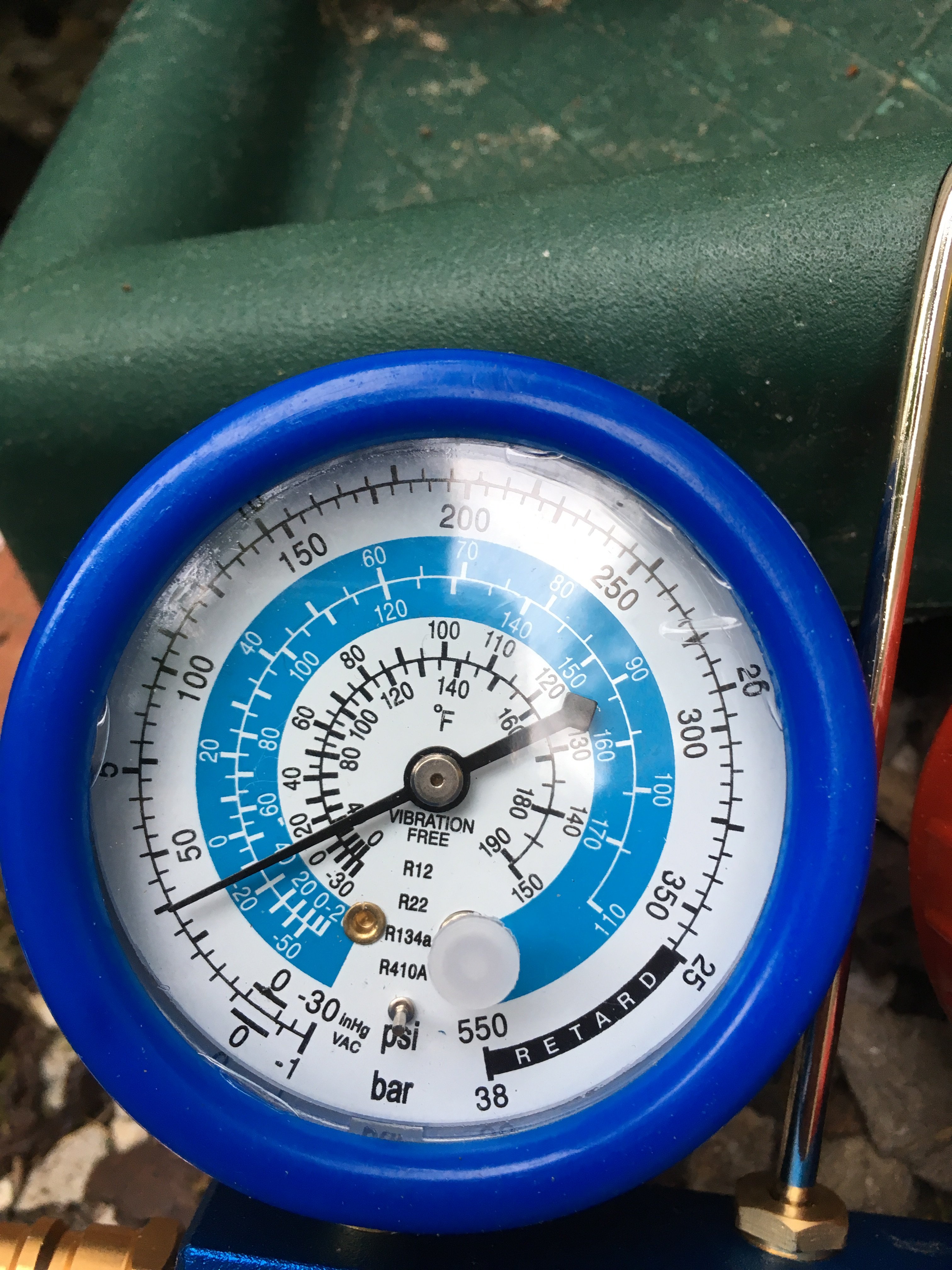

John Dirks Jr Posted June 12, 2019 Author Report Share Posted June 12, 2019 72 degree ambient. System hasn’t been run in two days. Vapor side reading 150psi at idle (not running) So, this indicates there has not been a loss of refrigerant. Am I correct? Quote Link to comment Share on other sites More sharing options...
John Dirks Jr Posted June 12, 2019 Author Report Share Posted June 12, 2019 Wait. When running it drops to 35psi. Quote Link to comment Share on other sites More sharing options...

Marc Posted June 13, 2019 Report Share Posted June 13, 2019 (edited) The photo, when the unit isn't running, indicates 150 psi which, for 410A corresponds to a saturation temperature of 52 degrees (look at the R410A temperature saturation scale, the outer blue one). If I assume that both indoor and outdoor temps are at 72 degrees, this means there is no longer any liquid refrigerant left in the system. When there is at least some liquid and some vapor in the system, no matter how little or how much, pressure will be at saturation. So your system is all vapor, unless its 52 degrees outside. That would mean it has lost most of its refrigerant, I'd guess about 90% at least. That's a really fast leak and, in my book, a good sign because it'll make it easier to find. Edited June 13, 2019 by Marc Quote Link to comment Share on other sites More sharing options...
Marc Posted June 13, 2019 Report Share Posted June 13, 2019 I would not run this system anymore until its fixed. When refrigerant is low, oil circulation, which prevents the compressor from overheating and failure, suffers. Quote Link to comment Share on other sites More sharing options...

John Dirks Jr Posted June 13, 2019 Author Report Share Posted June 13, 2019 Thanks Marc, what would be a normal “resting” pressure at 75 degrees ambient? Ball park Quote Link to comment Share on other sites More sharing options...
Marc Posted June 13, 2019 Report Share Posted June 13, 2019 (edited) 220. Its on your gauges. Edited June 13, 2019 by Marc Quote Link to comment Share on other sites More sharing options...

John Dirks Jr Posted June 14, 2019 Author Report Share Posted June 14, 2019 Jim, An acquaintance of mine is EPA certified to handle refrigerants and has begun helping me service this system. We discovered a poorly connected fitting which has been fixed. Although the system had leaked down, any remainder was evacuated, the system vacuumed and recharged by weight according to the information on the data plate. The repaired fitting was tested and verified leak free. The system is working great again so l'm hoping there are not other leaks. I was not here the entire time he did the work so if anything is missing from my description, I'm sure he did it correctly. We'll see how things go and if needed, I'll call him back. Quote Link to comment Share on other sites More sharing options...
