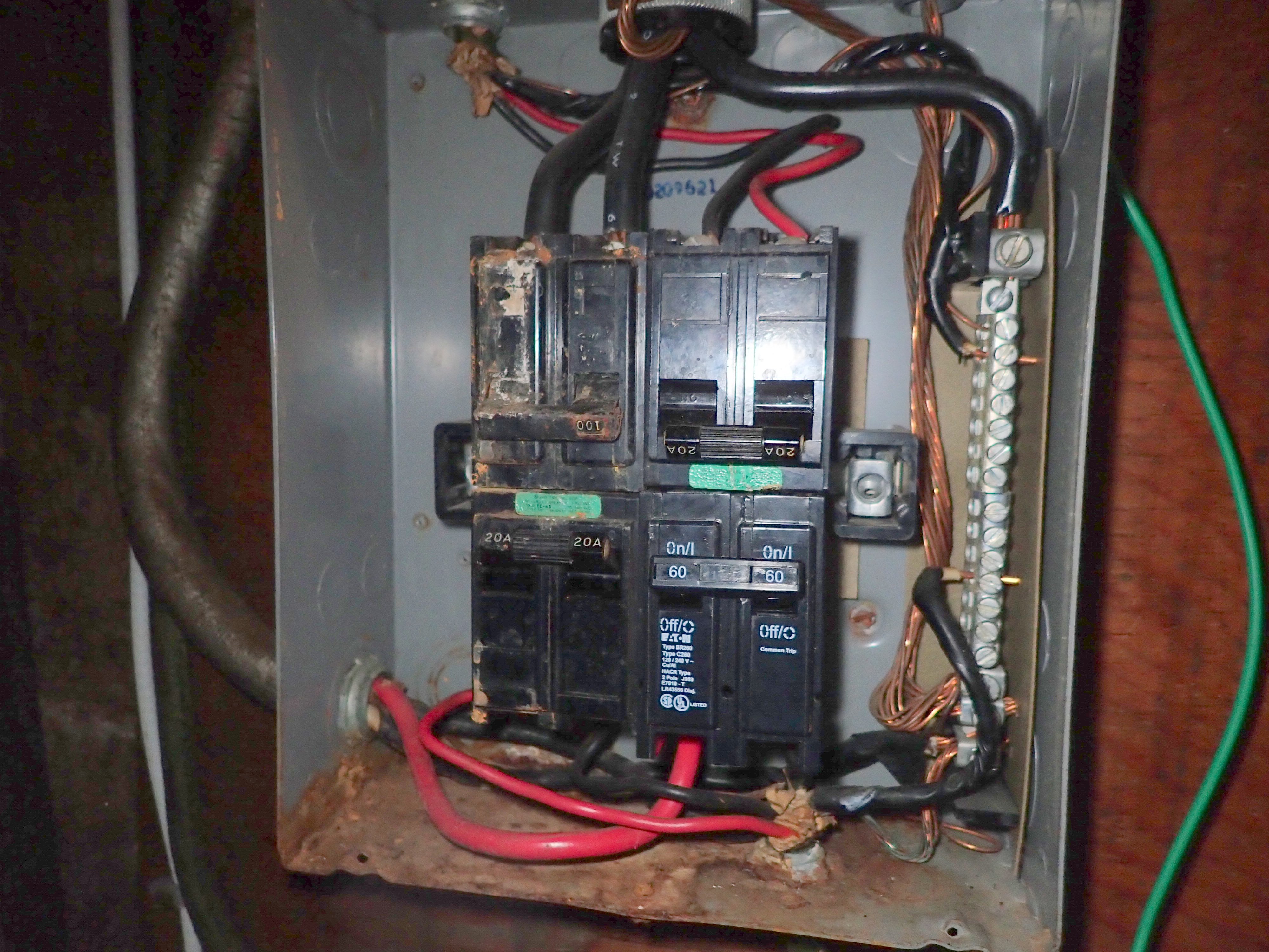

Chad Fabry Posted December 3, 2019 Report Share Posted December 3, 2019 Corner grounded three phase in a single phase panel. Notice they re-identified the grounded conductor black. 1 Quote Link to comment Share on other sites More sharing options...
Marc Posted December 4, 2019 Report Share Posted December 4, 2019 13 hours ago, Chad Fabry said: Corner grounded three phase in a single phase panel. Notice they re-identified the ground wire black. No 120 V loads? Quote Link to comment Share on other sites More sharing options...
mtwitty Posted December 4, 2019 Report Share Posted December 4, 2019 1 hour ago, Marc said: No 120 V loads? Marc, no 120 volt is available in a 240 volt corner grounded delta configuration. 240 volts from each phase to the other, including the grounded phase. Quote Link to comment Share on other sites More sharing options...
mtwitty Posted December 4, 2019 Report Share Posted December 4, 2019 15 hours ago, Chad Fabry said: Corner grounded three phase in a single phase panel. Notice they re-identified the ground wire black. Yep, the grounded conductors should be identified white or gray. They are not neutrals, but are required to be identified as current carrying grounded conductors. Quote Link to comment Share on other sites More sharing options...
Chad Fabry Posted December 4, 2019 Report Share Posted December 4, 2019 3 hours ago, Marc said: No 120 V loads? No 120 v loads, it served only roof top HVAC Equipment. It made my brain smoke when I got to the basement and didn't find any 3-phase panels. Quote Link to comment Share on other sites More sharing options...
Chad Fabry Posted December 4, 2019 Report Share Posted December 4, 2019 Quote Marc, no 120 volt is available in a 240 volt corner grounded delta configuration. 240 volts from each phase to the other, including the grounded phase. That's what threw me for a loop. I metered the panel and there was 240v between any of the terminals. Luckily, Douglas Hansen answered his phone and told me what I was looking at- once he explained it, I sort of understood it- I had to see the schematic to get it. 1 Quote Link to comment Share on other sites More sharing options...
