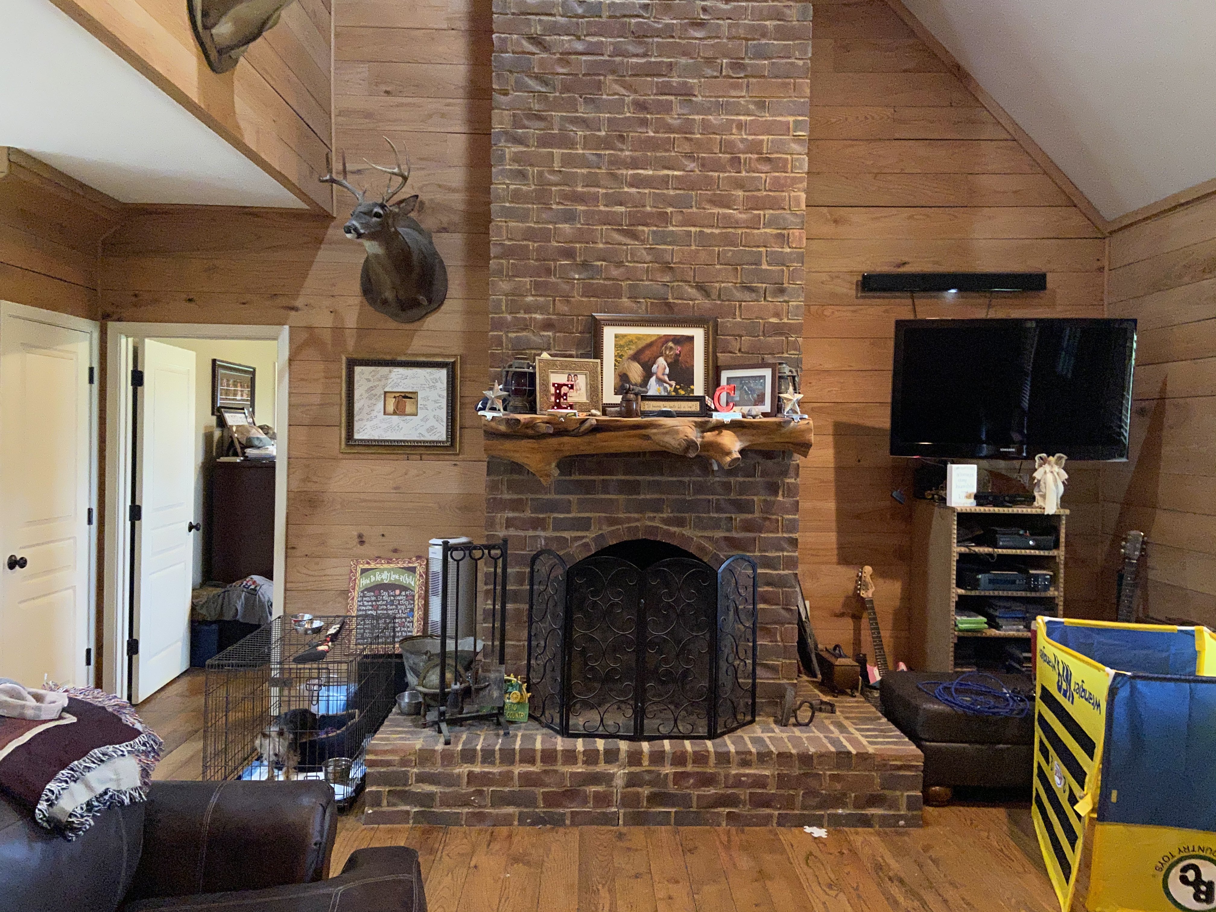

Bobby Jim Posted March 5, 2020 Report Share Posted March 5, 2020 I have a house that I’ve inspected on a pier and beam foundation. A tornado was close but the building was not damaged (there was no shifting of the foundation, no shingle creasing/tearing, all soffit/fascia is tight and the building columns and walls are plumb) the chimney brick above the roof line is not cracked, the chimney brick in the attic is not cracked. The chimney brick in the interior of the building is cracked in several places. Is there ANY WAY that the wind forces from the tornado could have caused the chimney to crack in the interior of the home? I can’t think of how but homeowner insists the tornado was the cause of the cracking. Quote Link to comment Share on other sites More sharing options...
Les Posted March 5, 2020 Report Share Posted March 5, 2020 yes the tornado could have been culprit. the house envelope can and will rack with the storm forces and it can crack a chimney like that. because it is interior only the racking would only impact interior brick. tornadoes are much like explosions - you can believe anything. Quote Link to comment Share on other sites More sharing options...
Bobby Jim Posted March 5, 2020 Author Report Share Posted March 5, 2020 Thanks Les, should I then expect to see the building racked? Is there any other corroborating evidence I should have looked for? Quote Link to comment Share on other sites More sharing options...
Les Posted March 5, 2020 Report Share Posted March 5, 2020 any interior indicators of racking: interior doors, wall corners at ceiling, and window openings. location of cracks below the roof line on the chimney. 1 Quote Link to comment Share on other sites More sharing options...
Jim Katen Posted March 6, 2020 Report Share Posted March 6, 2020 The building frame might also have distorted and then sprung back to its original position. Just because it racked doesn't mean that it stayed racked. 1 Quote Link to comment Share on other sites More sharing options...
Les Posted March 6, 2020 Report Share Posted March 6, 2020 31 minutes ago, Jim Katen said: The building frame might also have distorted and then sprung back to its original position. Just because it racked doesn't mean that it stayed racked. True. If it was racked enough to crack chimney it is pretty likely there would be other clues. I have seen that phenomena when there was an explosion on the first level of a house with a basement. I have no experience with a house on crawl or slab. Extreme event(s) require a little more investigation and experience than a typical home inspection. Could be a simple masonry issue and nothing exotic at all. 1 Quote Link to comment Share on other sites More sharing options...
Marc Posted March 6, 2020 Report Share Posted March 6, 2020 I doubt the crack is a result of direct impact on the chimney by the wind, since a large portion of the chimney is indoors. As others have said, the house can tolerate some movement but the brick is unforgiving and will crack should the house move and generate enough force against the chimney at the roof level. I think the most important question here is whether the flue liner is also cracked. Just my two-bits. 1 Quote Link to comment Share on other sites More sharing options...
Les Posted March 6, 2020 Report Share Posted March 6, 2020 is the first photo the lower left of the last photo on the hearth? Quote Link to comment Share on other sites More sharing options...
Bobby Jim Posted March 8, 2020 Author Report Share Posted March 8, 2020 On 3/5/2020 at 6:29 AM, Les said: On 3/6/2020 at 9:25 AM, Les said: is the first photo the lower left of the last photo on the hearth? Yes it is. Another note...all the cracking is in the bottom few courses of brick Quote Link to comment Share on other sites More sharing options...
John Ghent Posted March 9, 2020 Report Share Posted March 9, 2020 "I have a house that I’ve inspected on a pier and beam foundation." That's probably something to consider as a possible cause. I have a fireplace that has settled, (cracks in the lower courses but not higher up) because it was built on a garage slab without a correct foundation. Quote Link to comment Share on other sites More sharing options...
