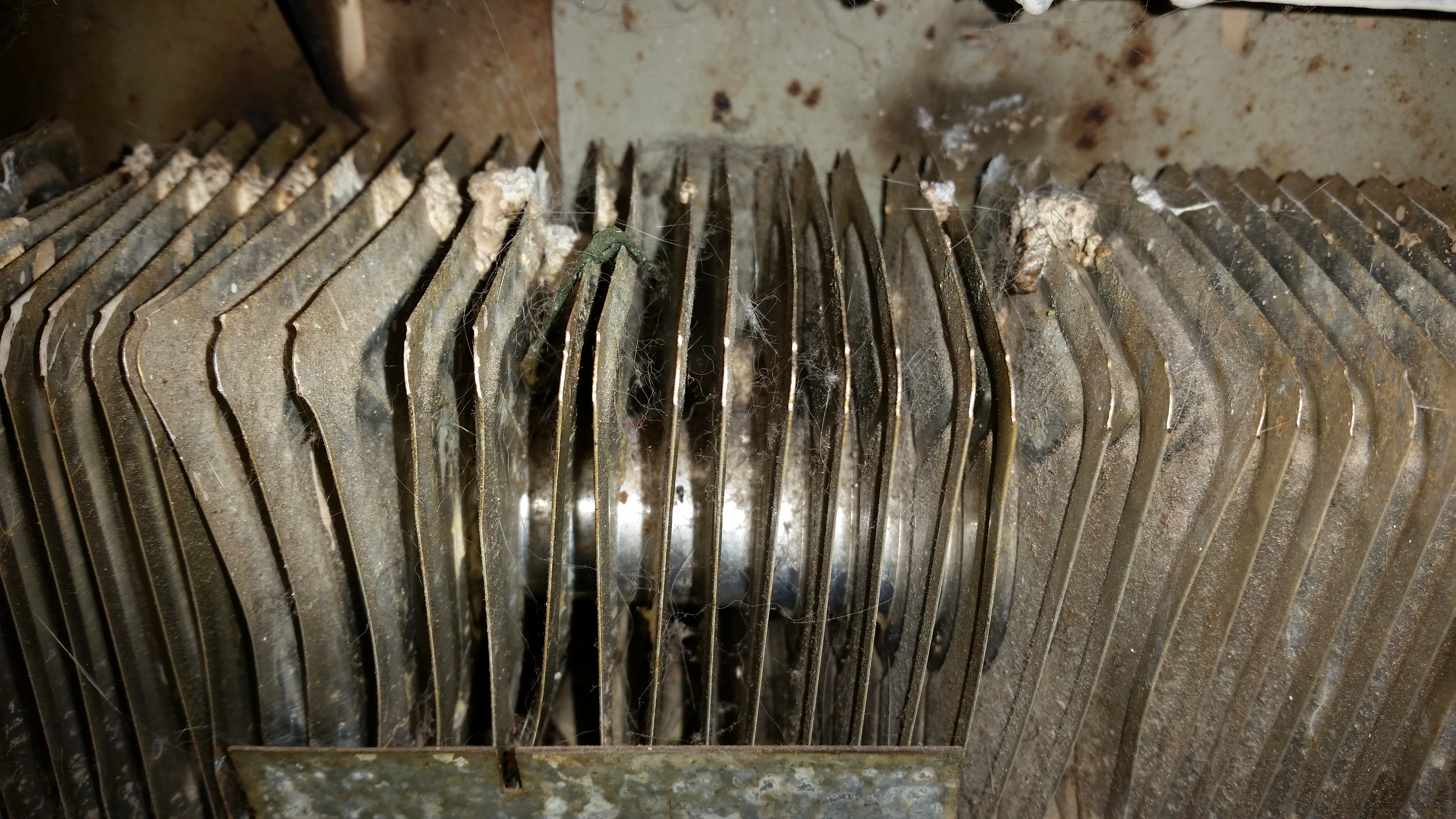

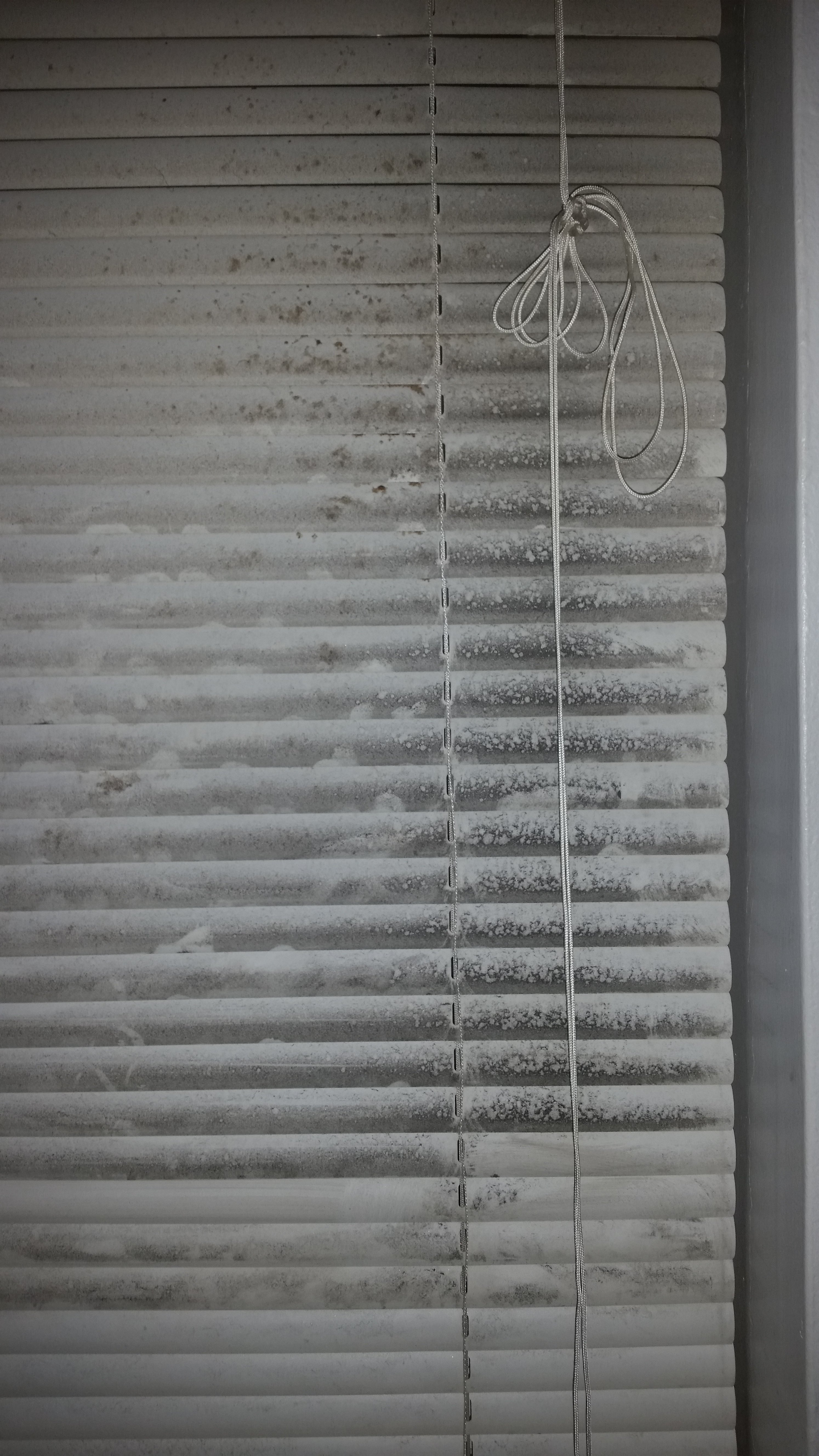

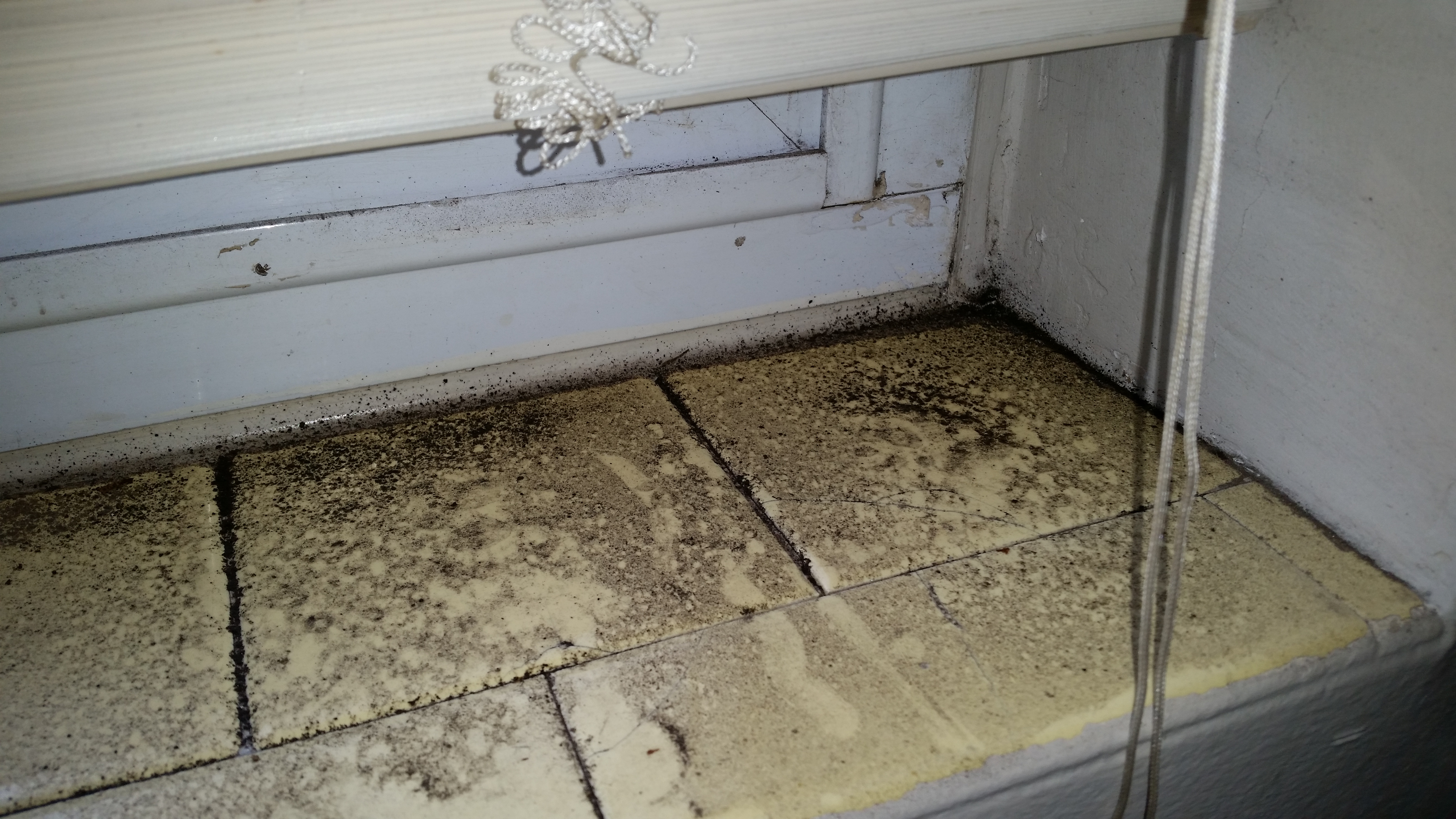

ArVandelay24 Posted September 30, 2020 Report Share Posted September 30, 2020 Wondering if this looks ok Quote Link to comment Share on other sites More sharing options...
Marc Posted September 30, 2020 Report Share Posted September 30, 2020 (edited) I don't think so. Just dirty. Only a lab knows for sure. Edited September 30, 2020 by Marc Quote Link to comment Share on other sites More sharing options...
Les Posted October 1, 2020 Report Share Posted October 1, 2020 12 hours ago, Marc said: I don't think so. Just dirty. Only a lab knows for sure. Marc, if you tried hard enough, I am sure you could find mold. Probably twenty or thirty varieties. Quote Link to comment Share on other sites More sharing options...
Tom Raymond Posted October 1, 2020 Report Share Posted October 1, 2020 Yup. There are 40-60 million mold spores on every square inch of the planet, including you. Good news, cleaning up whatever that crud is will remove most of it. Quote Link to comment Share on other sites More sharing options...
John Kogel Posted October 2, 2020 Report Share Posted October 2, 2020 It all starts with dirt. Dust in the air mixed with moisture from poor air flow, and then not wiping away the algae that grows on the dirt. If those surfaces were clean, there'd be nothing there. Renters tend to blame their landlord for this type of thing, but it is often due to poor house-keeping and turning the heat down too much, allowing moisture to condense on the walls. Quote Link to comment Share on other sites More sharing options...

Jim Katen Posted October 17, 2020 Report Share Posted October 17, 2020 There's no need for anyone here to apologize to me. I welcome all feedback, especially when I slip over onto the assaholic side of my personality. So thanks for the reminder. I'll try to behave. ArVandelay24, if you haven't left in disgust, please accept my apology for the sarcastic and unhelpful comments. Perhaps it would help if you were to not think of mold as a problem. Instead, think of it as a symptom. Mold in a house is *always* and without exception, a symptom of a water problem. If your house was thoroughly clean before you left on vacation, then this mold is also a symptom of a dirt infiltration problem. That is, air pressure (including but not limited to wind) might be driving dirt into your house through the window weather seals and depositing a fine film of dirt on the surfaces. This would be simple to test. Thoroughly clean the ceramic tiles next to the window in your first picture and wait to see whether or not dirt accumulates over time. Once dirt accumulates, John Kogel's response, early in this thread, pretty much nailed what's going on. Keeping the house cool lowers the dew point of the air and makes condensation much more likely. Once condensation becomes chronic, everything stays damp and the mold grows. If you keep the place clean, warm, and dry, mold won't grow. Quote Link to comment Share on other sites More sharing options...

Jim Baird Posted October 19, 2020 Report Share Posted October 19, 2020 The photo of the tile on what looks like the sill of a window opening indicates a thickness of wall consistent with typical basement wall. There are two kinds of basements. Those that leak and those that will leak. If it is a basement dwelling it likely has always been a little dank, a little musty, even a little moisty. Quote Link to comment Share on other sites More sharing options...
