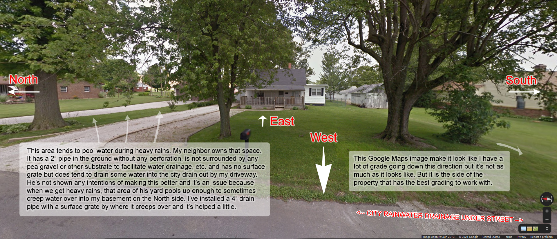

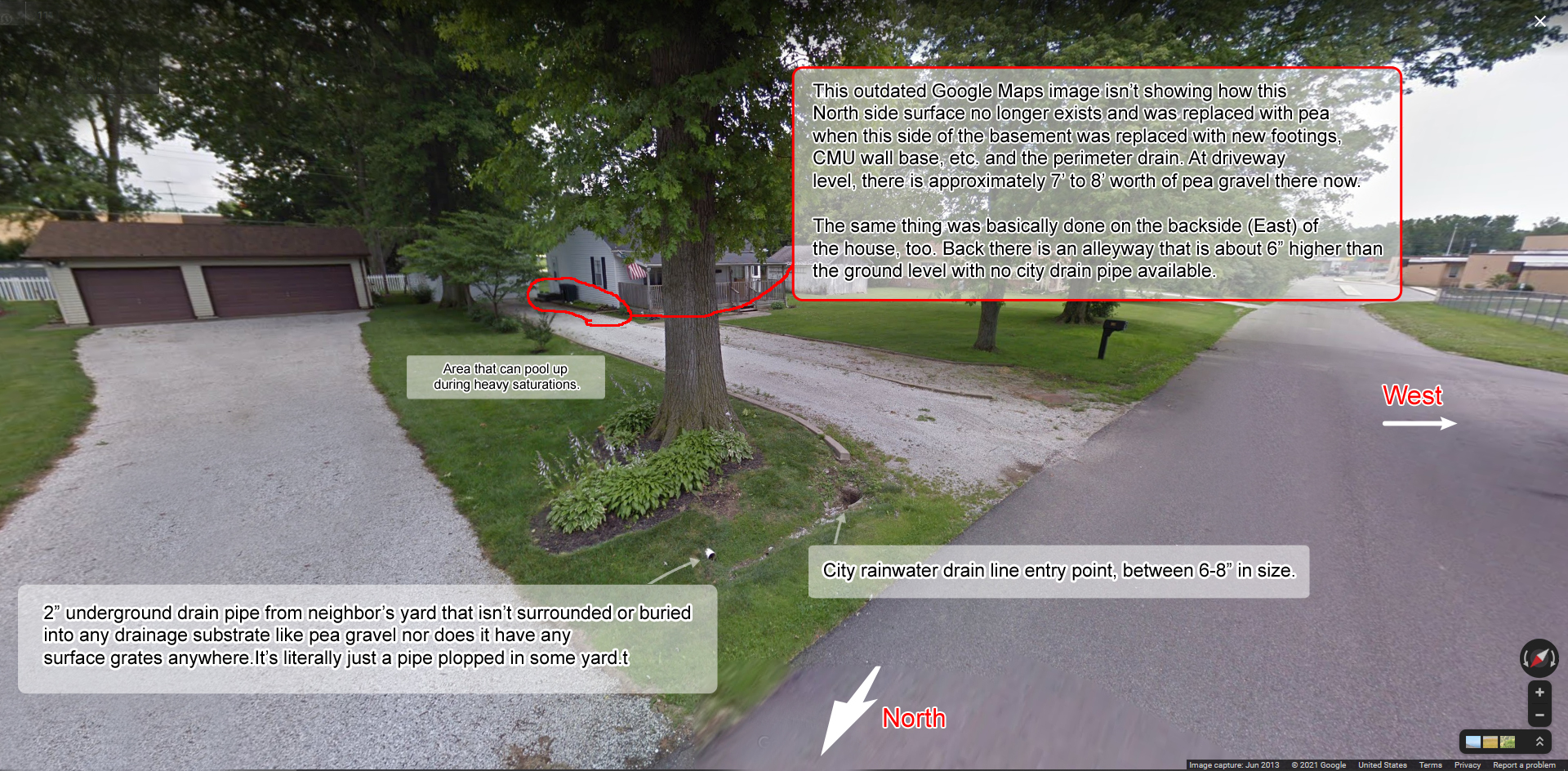

Wolf_22 Posted June 10, 2021 Author Report Share Posted June 10, 2021 Pretty much. Looking at it from the outside, you wouldn't really think it because it doesn't show an obvious bowl landscape but once you see how water behaves during rains, you realize it needs grading but because of the property itself, it's just not very possible. The closest I might be able to do is take down a tree by the city street and then bulldoze the heck out of the land to grade down the street direction, but I'm not convinced it would be impactful enough to merit the money and effort. I've attached 2 images: both basically show the house and the land it sits on. I'll try to find one that shows the rear of the home and lot, but these two might give you an idea of what I'm up against. The South face has the best options where grading is concerned but considering how my perimeter drain sits basically 7-8 feet below the driveway level, it's somewhat moot from what I can tell, which is why we decided to bring the water into the basement to be pumped out to the city rainwater drainage (the 2" discharge pipe currently runs through some crawlspace and travels underground from under the add-on master bedroom on the South side of the home). Both images I was able to grab from Google Maps but neither show the 20' 4" solid PVC downspout extensions I currently have attached to the downspouts, with one being on the South corner of the porch and 2 being behind the home on the East side. The place that I get the most water is right there on the North-West corner: water tends to come in at a corner in the basement where the old wall meets up with new. Some of this is because the contractor made no effort to compact dirt or cement anything where the old block was exposed which runs underneath the porch. Instead, they simply dumped pea gravel down into the trench after putting a thin layer of tar sealer on their new walls whereby their masonry guy tried to seal everything as well as he could from the inside using some cut-to-size CMU along with mortar. So it's no surprise that water comes in right there and I'm currently trying to get a quote about how much it would cost to dig up the pea gravel and redo that as a worst-case approach, but it still wouldn't do anything about the water coming in as there's nothing that I think can be done about it from the outside. Quote Link to comment Share on other sites More sharing options...
Marc Posted June 10, 2021 Report Share Posted June 10, 2021 (edited) Would you consider a small rainwater drainage pond to which you could drain two swales that begin on either side of the driveway, encircling the house and draining into the pond? Make the swales no more than 1 inch deep at the driveway, no more than about 10 inches deep where they dump into the pond. Perhaps 10 to 15' wide at the deepest point. Very mild, nothing ugly. Make the pond about 12' in diameter and deep enough to alleviate your issues. Make the pond as far away from the house as you can, and as close to the city rainwater drain line as possible. Cut a level swale from pond to city rainwater drain line. Edited June 10, 2021 by Marc Quote Link to comment Share on other sites More sharing options...

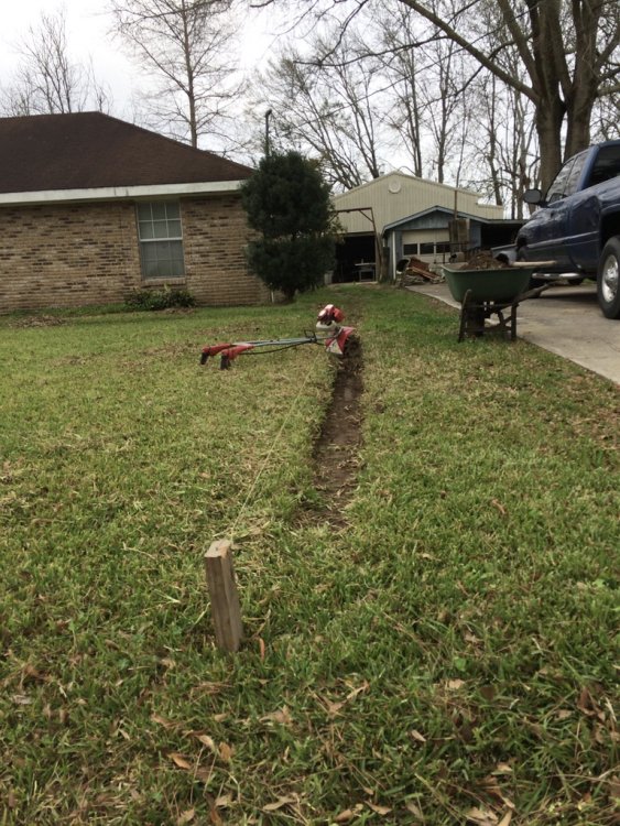

Marc Posted June 10, 2021 Report Share Posted June 10, 2021 (edited) 'Grassy trench path' doesn't quite cut it. A swale is like a ditch, only much more shallow and much more wide. Done correctly, you'll hardly notice it, but it'll drain the property. Did it myself years ago on my own property to carry water from the rear to the municipal ditch in front: Edit: You could do a dry well...same thing. Edited June 11, 2021 by Marc Quote Link to comment Share on other sites More sharing options...
Wolf_22 Posted June 10, 2021 Author Report Share Posted June 10, 2021 I see... If you did it yourself, how did you do it? If you hired someone, what kind of person did you hire to do it? Did it have that much of an impact on water and drainage to feel like it was worth doing? When I think about doing that with my yard, it's hard for me to believe it would put a dent in the amount of water I sometimes deal with in my basement, but I'm not at all dismissing this as a possible option... I guess a lot of it just depends on how it gets graded and how much gravity it gets to use. Quote Link to comment Share on other sites More sharing options...
Marc Posted June 11, 2021 Report Share Posted June 11, 2021 5 hours ago, Wolf_22 said: I see... If you did it yourself, how did you do it? If you hired someone, what kind of person did you hire to do it? Did it have that much of an impact on water and drainage to feel like it was worth doing? When I think about doing that with my yard, it's hard for me to believe it would put a dent in the amount of water I sometimes deal with in my basement, but I'm not at all dismissing this as a possible option... I guess a lot of it just depends on how it gets graded and how much gravity it gets to use. I ran a tight string along the middle at fender height (my tiller has fenders). I then cut a path the width of my tiller, removed the excess soil, then sloped the sides with tiller by swaying it sideways. Took two days. It's about 100' long, 12' wide. About 2 cubic yards of soil removed. Photo taken while standing in the ditch. Quote Link to comment Share on other sites More sharing options...

Wolf_22 Posted June 12, 2021 Author Report Share Posted June 12, 2021 I'm curious about any distinctions that exist between the swale + pond idea vs. French drain + dry well idea. The swale + retention pond sounds okay but it also sounds like it would be the most disruptive to a yard without providing the more efficient medium to transfer water. One difference I can see as being better with the swale + retention pond idea is that the final point where the water ends up would be open to daylight and more likely to dry up faster whereas a dry well would likely retain water longer due to its encapsulation and less air movement, etc... Both benefit from percolation, which is an issue with my yard due to it consisting of clay loam... Regardless, the swale + pond would require my yard to undergo major landscaping. I'd have to take down a tree over in a corner in the front yard, perform some massive grading with the dirt, then install the actual swales + pond and that would be only the front yard (albeit the area which would benefit the most from something like this if it does anything at all). However, with a dry well--assuming it's fairly close to the same functionality one gains with the swale + pond--would be completely hidden under the ground and still enjoy the drainage you'd observe with the swales emptying into the pond, only better because it would likely use a more efficient drain line with tarp and pea gravel on top of that covering the pipe, etc. With all these ideas being floated around, I'm almost tempted to consider taking tons of my yard out to be replaced with a better more percolating dirt in an effort to facilitate better absorption, only at a grade to motivate the absorption away from the house... I shudder at the cost of something like this. But again, the pond idea would benefit from daylight + wind movement, thereby increasing the likelihood and speed of drying, or at least, I'm assuming... I'm just not sure what to do and I'm worried that I'd just be chasing my tail with these suggestions. But whether anyone on here likes it or not, I'm definitely doing an internal drainage system before I do anything else as part of that project is going to entail joining my two sump pumps together via the trench to incorporate redundancy that I don't currently enjoy. In other words, right now, my perimeter drain pump is on it's own circuit. So this drain system will join the two so that if one goes out, the other one can keep the drainage going. I've got 2 water proofers and a plumber coming out to the house next week with another construction guy who did my 2 basement wall rebuilds coming out sometime after that. I plan on asking them all about these ideas to see what they say. I'm afraid they'll poo-poo it and say that it's unlikely to do much for me, especially considering subsurface water issues I have (i.e. - high water table). Not saying they'd be right to poo-poo it, but just saying that this has been a common reaction to similar ideas when they're floated to these kinds of guys that have been out to my place before to talk about things like this. Quote Link to comment Share on other sites More sharing options...
