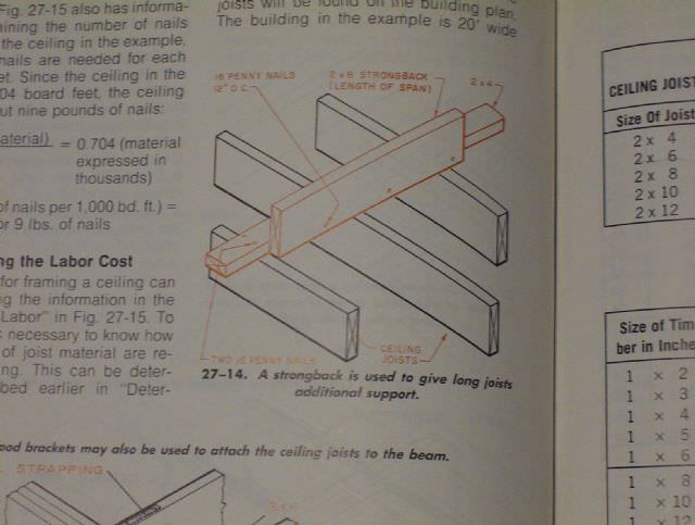

hausdok Posted August 23, 2006 Report Share Posted August 23, 2006 Hi, When I was coming up, my old man taught me that a strongback was used over wide-span ceilings to stop them from sagging under the weight of plaster and lath or drywall and the insulation above. They were typically secured to the top plate of bearing walls perpendicular to the ceiling joists at mid-span over either end of a room. They usually consisted of a couple of heavy planks secured right angles to one another in an L or T shape, so they'd be as rigid as possible and wood cleats or metal brackets completed the connection to the joists below. Sometimes they'd take the form of a fink or queen post truss that bore the weight on the lowest chord. I see them a lot in older construction but not so much anymore because most everything is trussed these days. ONE TEAM - ONE FIGHT!!! Mike Quote Link to comment Share on other sites More sharing options...
kurt Posted August 23, 2006 Report Share Posted August 23, 2006 In my world, they are exactly what Mike said; beams in the attic, usually over large LR or DR spaces, bearing on partitions or exterior walls, & w/the ceiling joists "hung" from them. They keep the ceilings from sagging. Quote Link to comment Share on other sites More sharing options...

Mike Lamb Posted August 24, 2006 Report Share Posted August 24, 2006 I was able to correct a seriously sagging ceiling by jacking it up fairly level and putting in a strong back after the fact. It worked. Download Attachment: 100_4782.JPG 503.32 KB Quote Link to comment Share on other sites More sharing options...
hausdok Posted August 24, 2006 Report Share Posted August 24, 2006 Originally posted by charlieb So, What is a fink or queen post truss? Go to the menu bar above, pass your cursor over 'resources' then choose 'downloads'. Scroll down to FM5-426 and download/save the Army carpentry manual and then look up those types of trusses. OT - OF!!! M. Quote Link to comment Share on other sites More sharing options...
DonTx Posted August 24, 2006 Report Share Posted August 24, 2006 My version of strongbacks are the same of Mike Lambs. I believe IRC 802.3.1 discusses their need in framing. It's a common problem in new construction here. Many trades do not understand them or do not care to use them properly. BTW, Mike, what book is that illustration out of? Quote Link to comment Share on other sites More sharing options...
Mike Lamb Posted August 24, 2006 Report Share Posted August 24, 2006 1986 John Feier and Gilbert Hutchings, "Carpentry and Building Constructuion" Quote Link to comment Share on other sites More sharing options...

kshepard Posted August 26, 2006 Report Share Posted August 26, 2006 If it is actually in the floor framing underneath the joists, it's a girder and it's purpose is to support floor joists that would otherwise be overspanned. As stated before me, if it's fastened to the top of ceiling joists, it's a strongback installed to prevent ceiling sagging. This can work, but it can become a problem because carpenters are tempted to install roof bracing so that the braces bear on this strongback. This is a defect. Over time it will cause the ceiling to sag again, since the ceiling joists that originally couldn't carry the load of the ceiling without sagging are now being asked to carry the ceiling and roof loads. Quote Link to comment Share on other sites More sharing options...
