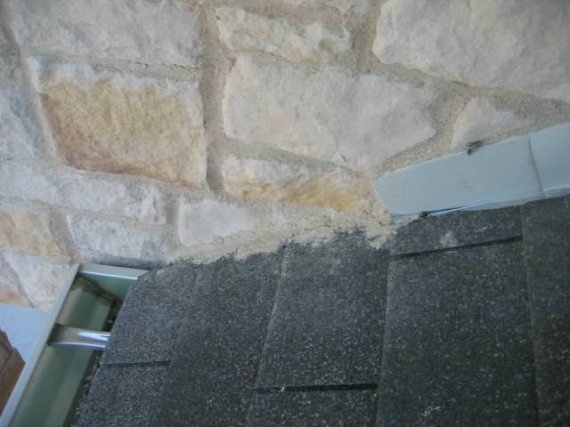

rlskfoster Posted September 17, 2006 Report Share Posted September 17, 2006 I recently inspected a new home and found thses two areas not flashed or not flashed over the soffit. Builder is giving the homeowner some flak on request to flash these areas. I feel that both areas should be flashed, what about ya'll. Admittedly roofing is not my strongest area of expertise, but, I feel I'm right. Pic #1 is on side of the front porch and they stopped the flashing as the roof gets to the soffit. Pic #2 is roof line of the garage as it meets the breakfast nook front wall. The soffit is directly over this area. Buster Download Attachment: Dearinger 034.jpg 51.05 KB Download Attachment: Copy of Dearinger 036.jpg 78.68 KB Link to comment Share on other sites More sharing options...
fqp25 Posted September 17, 2006 Report Share Posted September 17, 2006 About thew first picture: It just looks bad. They should of installed the counter flashing all the way down. It looks like there is a crack in the mortar, thats a vulnerable spot for a moisture leak. The second picture, it's hard to tell. I think it might be all right, since it's under the soffit. How wide is the soffit? And is this an area where rain could blow into? I think those would be 2 important issues. But this could come down to local roofing codes. I would of used something else than motor. And I would advise client if the builder refuses to add appropriate flashing, to monitor area for any future moisture problems. Link to comment Share on other sites More sharing options...

Bain Posted September 17, 2006 Report Share Posted September 17, 2006 Yup, I don't recall the exact language, but anytime shingles abut a side wall, the counter-flashing method MUST be used. Buster, check out my "Is it just my area" thread and look at the photo taken on a rainy day. The water is clearly seeping through and into the roof framing and decking. John Link to comment Share on other sites More sharing options...
hausdok Posted September 17, 2006 Report Share Posted September 17, 2006 No question, The roof-to-wall in both cases should be flashed all the way to the end of the roof with step flashings and there should have been a kickout used at the end where the gutter is. OT - OF!!! M. Link to comment Share on other sites More sharing options...
Mike Lamb Posted September 18, 2006 Report Share Posted September 18, 2006 Everything, including common sense to code to manufacturersââ¬â¢ instructions says there has to be wall to roof flashing. IRC 2000 R703.8 Flashing. Approved corrosionââ¬âresistive flashing shall be provided in the exterior wall envelope in such a manner as to prevent entry of water into the wall cavity or penetration of water to the building structural framing components. The flashing shall extend to the surface of the exterior wall finish and shall be installed to prevent water from reentering the exterior wall envelope. Approved corrosionââ¬âresistant flashings shall be installed at all of the following locations: â⬦ At wall and roof intersections.id="size5"> This link has good illustrations. http://www.ibacos.com/pubs/RoofFlashing ... lashing%22 Link to comment Share on other sites More sharing options...
rlskfoster Posted September 18, 2006 Author Report Share Posted September 18, 2006 Thanks guys, Both areas were definately vulnerable to driving rain and it had been properly flashed on the other side of the porch that had a similar roof to wall situation. I couldn't understand why they didn't flash these two areas. Buster Link to comment Share on other sites More sharing options...
