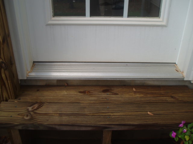

pi Posted November 16, 2006 Report Share Posted November 16, 2006 6 year old home, with rear patio and door about 18 inches the ground. Looks like the owner just built a nice new set of steps, actually very sturdy with a railing and all. Problem is, rise of 2 bottom steps is 8" and top step rise is only 4 inches. It's a code violation but I'm not a code inspector. Is this really a safety hazard warranting redoing steps. Opinions? Download Attachment: 061116dan 006.jpg 137.54 KB Link to comment Share on other sites More sharing options...
Jim Morrison Posted November 16, 2006 Report Share Posted November 16, 2006 My opinion is that since about 1 million people go to the ER every year because of a slip, trip, or fall, I'd tell my client that those stairs are is a tripping hazard and they ought to get them fixed for their own safety. Jim Morrison Link to comment Share on other sites More sharing options...
Neal Lewis Posted November 16, 2006 Report Share Posted November 16, 2006 Isn't a landing required at this door, not just steps? Link to comment Share on other sites More sharing options...
hausdok Posted November 16, 2006 Report Share Posted November 16, 2006 Yep, A landing is required at the top and bottom of the stairs (IRC 312.1/UBC1003.3.3.5)unless it's 2 or fewer risers (IRC311.4.3). OT - OF!!! M. Link to comment Share on other sites More sharing options...
Darren Posted November 17, 2006 Report Share Posted November 17, 2006 In NJ, a floor or landing is required on each side of an exterior door (except for the exterior of a sliding door)(no minumum # of risers). Also in NJ, a riser height shall not exceed 8 1/4 inches. Darren www.aboutthehouseinspections.com Link to comment Share on other sites More sharing options...
pi Posted November 17, 2006 Author Report Share Posted November 17, 2006 Thanks Jim, Answer is what I needed but I could just see guy out their building those steps with his kid and being so proud. This will be good learning experience for him. No landing required if door swings in in NC. Storms and screen doors are also exempt. Link to comment Share on other sites More sharing options...
randynavarro Posted November 17, 2006 Report Share Posted November 17, 2006 Originally posted by pi Is this really a safety hazard warranting redoing steps. Opinions? Download Attachment: 061116dan 006.jpg 137.54 KB Well, I can understand it seems hardnose and bullyish to make that recommendation but the simple fact is there are very specific rules on the construction of stairs - even down to the 1/4". As Jim Morrison said, powers far greater than us have determined that stairs actually do cause a lot of damage in this country. I wouldn't contradict that reality. Link to comment Share on other sites More sharing options...
Jim Katen Posted November 17, 2006 Report Share Posted November 17, 2006 Originally posted by pi 6 year old home, with rear patio and door about 18 inches the ground. Looks like the owner just built a nice new set of steps, actually very sturdy with a railing and all. Problem is, rise of 2 bottom steps is 8" and top step rise is only 4 inches. It's a code violation but I'm not a code inspector. Is this really a safety hazard warranting redoing steps. Opinions? I can't even begin to understand why you wouldn't call this an unsafe defect and in need of correction. By the way, the sentiment that "we're not code inspectors" is the biggest pile of manure that's ever been foisted upon us. First of all, there's no such thing as a "code inspector" it's a made-up term. Second of all, the code forms the backbone of knowlege that informs us. Don't fear it. Fear of the codes is a cancer. - Jim Katen, Oregon Link to comment Share on other sites More sharing options...
pi Posted November 17, 2006 Author Report Share Posted November 17, 2006 OK already, I recommended new stairs and even told them how to build them to comply with NC Res. Code. Thanks fot input. Link to comment Share on other sites More sharing options...
