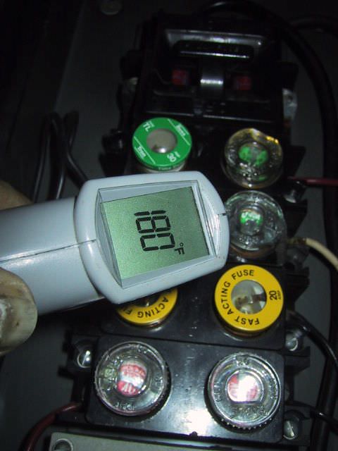

Jim Katen Posted November 29, 2006 Report Share Posted November 29, 2006 Les, I'm chagrined to report this, but I sifted through some old records and it seems that I did once encounter a Wadsworth panel that was in such bad condition that I considered it a hazard. It was a fuse panel and the temperature of the faceplate was 180 degrees. The main fuseblock was also cracked. I wouldn't tar the entire Wadsworth line because of this, but you asked for anecdotal stuff. - Jim Katen, Oregon Download Attachment: 162-6252_IMG.JPG 94.48 KB Quote Link to comment Share on other sites More sharing options...
