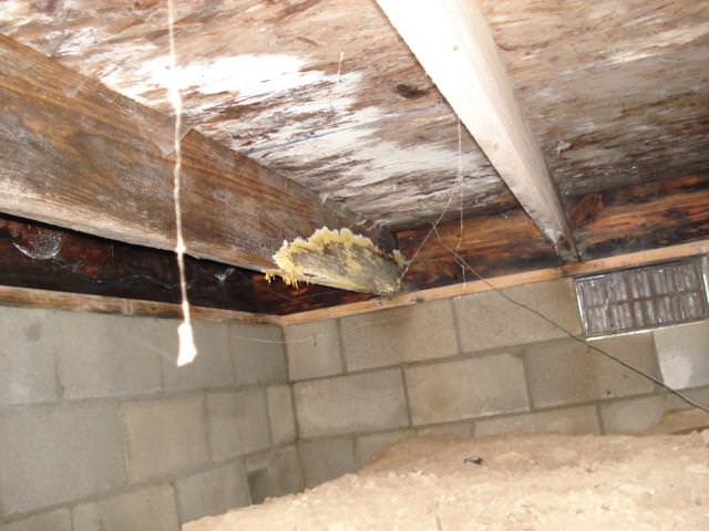

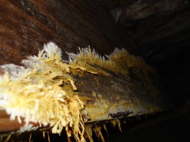

Erby Posted December 18, 2006 Report Share Posted December 18, 2006 Dang, if only I did mold/fungus testing I coulda made me some real money. Download Attachment: DSC03510.JPG 53.1 KB Download Attachment: DSC03512.JPG 41.72 KB Good thing I wear a mask. Another inspector I speak to occassionally told me he went in a good looking (?) crawl space a few days ago and that night his sinus were miserable. The next morning they were bleeding and he was in the doctor's office. Wear your breathing protection! Quote Link to comment Share on other sites More sharing options...

Bill01 Posted December 20, 2006 Report Share Posted December 20, 2006 What exactly is the white stuff covering the right side joist in the first picture? I've seen this before but didn't know the correct name. Looked almost good enough to eat. Quote Link to comment Share on other sites More sharing options...
Erby Posted December 21, 2006 Author Report Share Posted December 21, 2006 Sorry Bill, DDMG I just tell em" ============================= What appears to be mold or mildew is present. The identification of the organism(s) is beyond the scope of this home inspection. That means I think its mold but the only way to tell for sure is to test it. Testing is generally considered a waste of money by the Environmental Protection Agency (EPA) and the Centers for Disease Control and Prevention (CDC), unless the mold is causing health problems. See attachment " A Brief Guide to Mold, Moisture & Your Home" from the EPA. My basic recommendation is: The moisture source needs to be fixed and the mold needs to be cleaned up. Who does that is your decision. Do not spend money on testing. However, review the below information and recommendations before deciding on how to deal with this issue. If, after reviewing the below information, you have additional questions or want further investigation, I recommend that you contact a Certified Industrial Hygienist, usually listed in the yellow pages under "Industrial Hygiene Consultants" to determine if there exists an ongoing climate for incubation or microbial contamination and to obtain their recommendations for dealing with the issue. There is a lot of controversy over the issue of mold and mold testing. The EPA does not recommend measuring airborne fungal levels. The EPA publication "A Brief Guide to Mold, Moisture, and Your Home" states "Is sampling for mold needed? In most cases, if visible mold growth is present, sampling is unnecessary." The EPA also says ââ¬ÅYou should be aware that although a substance may look like mold, a positive determination of whether it is mold or not can be made only by an expert and may require laboratory analysis for final confirmation. For about $50, some microbiology laboratories can tell you whether a sample sent to them on a clear strip of sticky household tape is mold or simply a substance that resembles it.â⬠Quote Link to comment Share on other sites More sharing options...
Bain Posted December 22, 2006 Report Share Posted December 22, 2006 Yours is worse that what I saw this afternoon, Erby . . . still though, I thought I was gonna hurl just because of the stench. I found myself wishing I had one of Bill's masks, which I just ordered from Grainger this morning. I see this a couple of times a year. Want to destroy your house? Build a pretty brick planter around it. John Download Attachment: DSC06576a.jpg 248.11 KB Download Attachment: DSC06589a.jpg 247.56 KB Quote Link to comment Share on other sites More sharing options...
hausdok Posted December 22, 2006 Report Share Posted December 22, 2006 Hi John, Obviously, that wasn't the first time that they'd fixed the rot there. The ends of those joists have been sawn away and new ends cobbled on at least once. Wouldn't be surprised to learn that they'd replaced the rim joist as well. Around here, half of the yayhoos would have cut blocks and pounded 'em up between the ends of those joists to hide that rim. No support for those splices? Tsk, tsk. ONE TEAM - ONE FIGHT!!! Mike Quote Link to comment Share on other sites More sharing options...
