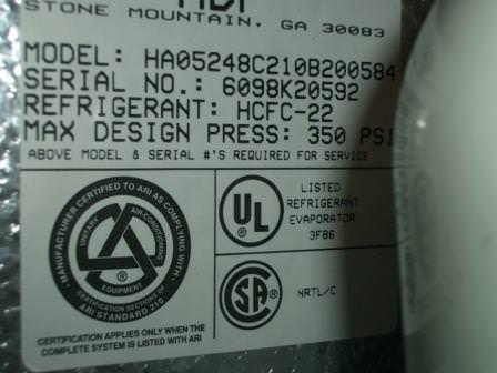

randynavarro Posted January 14, 2007 Author Report Share Posted January 14, 2007 Thanks all for the help. Still can't get online - one disadvantage of our e-age vs. just buying the book(s). I think 1998 sound sabout right. Also, I forgot to attach this pic of the evap. coil label that I also need to date - the serial # on this one has . . . 98 which lines up with age of furnace, but I still need to verify. Download Attachment: EvapCoilLabel.JPG 57.54 KB Can y'all assist once more? Mike, Got a second picture but not any better. Yes, once I get back online, I'll see what I can do to verify that information. Quote Link to comment Share on other sites More sharing options...
Bill Kibbel Posted January 14, 2007 Report Share Posted January 14, 2007 Trane/American Standard: 1st letter/number of serial #: W=83, X=84, Y=85, S=86, B=87, C=88, D=89, E=90, F=91, G=92, H=93, J=94, K=95, L=96, M=97, N=98, P=99, R=00, Z=01 2=02, 3=03, 4=04, 5=05, 6=06, 7=07 Randy, Evap Coil is also '98. I've never had to use Preston's. [:-graduat Quote Link to comment Share on other sites More sharing options...
