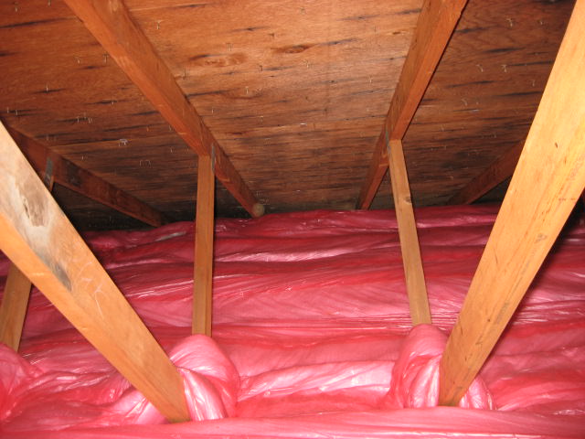

dtontarski Posted March 27, 2007 Report Share Posted March 27, 2007 I observed the bagged or plastic wrapped type batt insulation (I think its marketed as an itch-proof product for do-it-yourselfers) in an attic today installed over the original 40+ year old fiberglass batt insulation with a Kraft vapor retarder (oriented properly). I know that multiple vapor retarders are not recommended and it seems that this installation has actually create three. I realize that some vapor from the home may find its way up and get trapped in the original insulation. This will probably affect its thermal resistance value, but what is the worse case scenario here. Has any one seen water logged insulation and other related damage in this type of installation? What should I recommend to my client? That they remove the fancy new insulation and discard it? That the remove it and slit both sides of the plastic to prevent moisture from being trapped below? Anyone - what would you do/say? Thanks. Download Attachment: Insulation.jpg 119.29 KB Quote Link to comment Share on other sites More sharing options...
hausdok Posted March 28, 2007 Report Share Posted March 28, 2007 Hi, That sheath on that encapsulated information is not a vapor barrier. It's permeable, so you've only got the original barrier. Nothing to worry about. ONE TEAM - ONE FIGHT!!! Mike Quote Link to comment Share on other sites More sharing options...

Bill Kibbel Posted March 28, 2007 Report Share Posted March 28, 2007 I visited the J.M. site and I interpreted the information posted there as the sleeve did serve as a vapor retarder. O.C.'s Miraflex was targeted at homeowners adding additional insulation. J.M.'s Comfort Therm has 2 types; one has the plastic wrap that does not act as a vapor retarder. Quote Link to comment Share on other sites More sharing options...
Richard Moore Posted March 28, 2007 Report Share Posted March 28, 2007 I also found this... "Miraflex insulation maintains its insulating power over time, will not settle or deteriorate with age and is non-combustible. The new product is also enclosed on three sides with a poly wrap, allowing the insulation to resist the collection of moisture within the wrap. The remaining side uses a standard poly-faced vapor retarder with stapling flanges." From what I can find OC introduced Miraflex in 1994. If you go to their main site there is no mention of any plastic encapsulated batt insulation in their product lists. Anyone know why they discontinued it (assuming they did)? Was there a problem? Even with perforations it still seems like it would tend to trap some moisture in the insulation below, at least more so than unfaced batts or loose-blown. Quote Link to comment Share on other sites More sharing options...
hausdok Posted March 29, 2007 Author Report Share Posted March 29, 2007 Hi Richard, I've been seeing the sheath encapsulated stuff for about 10 years now and have never found it holding any moisture, regardless of brand used. Whatever the stuff is that they cover it with, it's able to release vapor and that's always a good thing. OT - OF!!! M. Quote Link to comment Share on other sites More sharing options...
