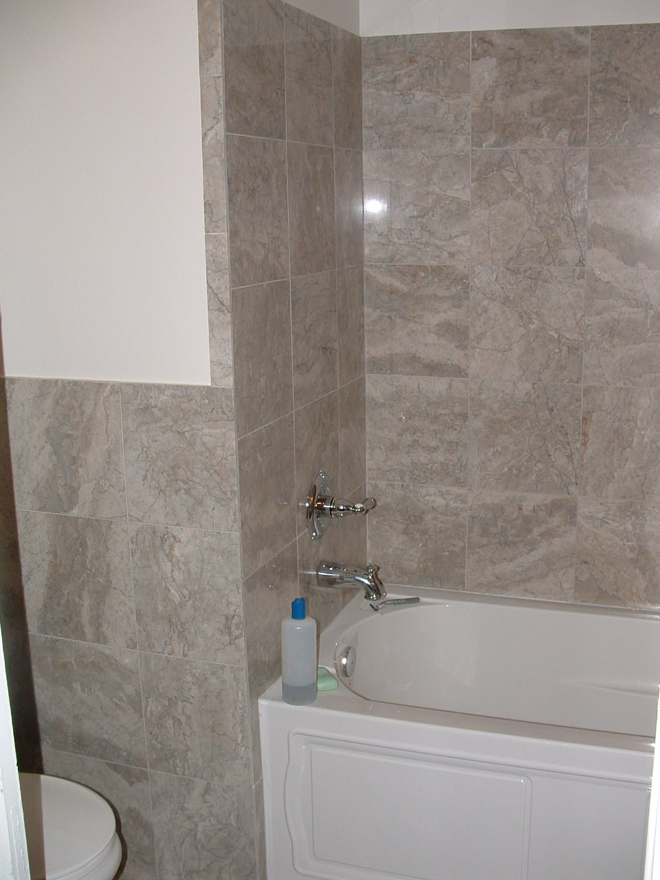

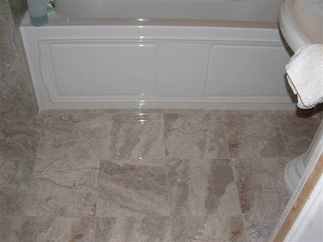

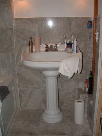

Chad Fabry Posted April 16, 2007 Report Share Posted April 16, 2007 What's the big deal, right, a little water seeping through an 1/8" gap? But I was in my basement one day, and saw anhydrous salts worming their way down a wall beneath the tub. I pulled back the insulation, which was damp and smelly, and saw that mold was already growing on the insulation and rim joist. How'd you get the water to defy gravity and go up over the tile lip on the tub? I hate caulking the tub to tile juncture. It keeps the water in the wall. Download Attachment: guestbath4smguestbathsmall4.JPG 22.08 KB Download Attachment: guestbath2Small.JPG 31.14 KB Download Attachment: guestbath5.JPG 326.76 KB Download Attachment: guestbath6.JPG 19.12 KB Our guest bath..No caulk, No leaks. Quote Link to comment Share on other sites More sharing options...

ozofprev Posted April 17, 2007 Report Share Posted April 17, 2007 Looks nice, Chad. How much space is between the wall and the toilet? Looks a bit cramped. Originally posted by Chad Fabry Our guest bath..No caulk, No leaks. Quote Link to comment Share on other sites More sharing options...
Chad Fabry Posted April 17, 2007 Report Share Posted April 17, 2007 It's the guest bath...36 inch wide stall. We don't have fat guests. Quote Link to comment Share on other sites More sharing options...
ozofprev Posted April 17, 2007 Report Share Posted April 17, 2007 Chad, I'm just laughing because toilet space was a topic here or at ASHI recently - don't remember which. I said then, I believe it's a feature for the reason you mention. BTW, what's it look like this emoticon is doing?[:-nonono] Originally posted by Chad Fabry It's the guest bath...36 inch wide stall. We don't have fat guests. Quote Link to comment Share on other sites More sharing options...
Bain Posted April 17, 2007 Report Share Posted April 17, 2007 +/- 80 year old tub, Chad. Veerry slight tile lip. Ummm, and someone may have removed the gpm gasket from the shower-head. Your bathroom wicked cool. Quote Link to comment Share on other sites More sharing options...
