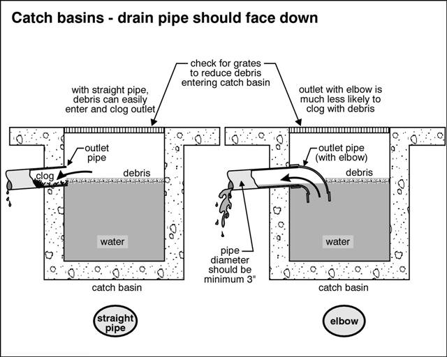

Jim Katen Posted June 29, 2007 Report Share Posted June 29, 2007 Originally posted by Brandon Whitmore So from what I am understanding, this is a catch basin that just allows water to permeate into the ground beneath the garage? Seems a little odd to me that they would install a catch basin directly beneath the slab(living space directly above garage). There was only one visible pipe that appeared to come from the driveway slab and then the sewer line that ran in there- am I missing anything? I did not see any pipe installed that would prevent overflowing if the moisture could no longer seep into the soils below. Does anyone know of any site I can go to that will let me study up on these? No, I think you misunderstand. There's usually a pipe that's turned down as it enters this box. That's the drain. As water fills the box, it flows out that pipe to a dry well or storm sewer. The box serves as a settling pit so that debris doesn't enter the dry well or storm sewer. You're supposed to clean out the muck every so often. At least that's how I understand them to work. - Jim Katen, Oregon Link to comment Share on other sites More sharing options...
Chad Fabry Posted June 29, 2007 Report Share Posted June 29, 2007 The pipe is turned down so that only water goes out the drain. Oil floats on top. Link to comment Share on other sites More sharing options...

Brandon Whitmore Posted June 29, 2007 Author Report Share Posted June 29, 2007 I understand how newer systems work, it just appeared to me on this one that the only open pipe entered from the driveway drain (could be wrong). This one looks more like a drywell to me, but probably wrong again. The pipe entering the catch basin appears to slope downward into the basin. Thanks for all the explanations, I think I will just have to assume that the drain I am seeing is for water to exit vs. enter. I wish I had a hose on that job to run water into that drain in the driveway to be sure. Link to comment Share on other sites More sharing options...

Jim Katen Posted September 16, 2008 Report Share Posted September 16, 2008 Originally posted by sirwig . . . Could there be a problem with water under the garage if I cap it with concrete? Also what's the best way to fill it (gravel, etc?). thanks again. If you want to fill it, use round river rock to within 4" of the top, then cap it with concrete. The round rock doesn't settle as gravel does so you won't have to worry about compacting it. Any water that enters the pit will move through the rock as if it weren't there. It'll also be easy to undo if you ever need to. - Jim Katen, Oregon Link to comment Share on other sites More sharing options...
