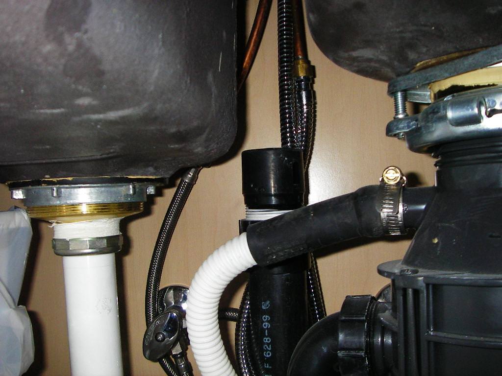

homnspector Posted July 3, 2007 Report Share Posted July 3, 2007 Should this AAV / vent be above the sink rim or at least above the bottom of the sink? Image Insert: 110.79 KB Quote Link to comment Share on other sites More sharing options...
Brian G Posted July 3, 2007 Report Share Posted July 3, 2007 Originally posted by homnspector Should this AAV / vent be above the sink rim or at least above the bottom of the sink? I was wondering about the elevation thing myself, just the other the day. I do know that isn't an AAV, it's a mechanical vent. AAV's don't use a spring and last much longer. That hereby exhausts my knowledge of both AAV's and mechanical vents. Brian G. Sometimes a Well, Sometimes a Mud Puddle [:-graduat[:-dunce] Quote Link to comment Share on other sites More sharing options...
homnspector Posted July 3, 2007 Author Report Share Posted July 3, 2007 Brian, thanks for clarifying that, I guess I never knew what the cheapie black ones were called. The only thing I can find says it must have a 100 mm rise but says nothing about having to be higher than the fixture. Quote Link to comment Share on other sites More sharing options...
Kyle Kubs Posted July 4, 2007 Report Share Posted July 4, 2007 Originally posted by homnspector Brian, thanks for clarifying that, I guess I never knew what the cheapie black ones were called. The only thing I can find says it must have a 100 mm rise but says nothing about having to be higher than the fixture. Yes, they must be above the flood rim of the sink. Also doing this will typically put them in the wall, which would then require an access cover (they can't be buried). Most jurisdictions don't allow Mechanical vents but do allow AAV's. Another factor is that it cannot be the sole venting means for the house - There has to be a main vent somewhere and these can be used on limited fixtures. Honestly I just don't like the things, either of them. They just wreak of bad craftsmanship and a totally half assed attempt at doing something right. Quote Link to comment Share on other sites More sharing options...
Bill Kibbel Posted July 4, 2007 Report Share Posted July 4, 2007 Originally posted by Kyle Kubs Yes, they must be above the flood rim of the sink. I don't think that is correct. For this situation, an air admittance valve (NOT a cheater vent) should be at least 4 inches above the horizontal/ fixture drain. Only "Stack-type" air admittance valves need to be 6 inches above the flood level rim of the highest fixture being vented. Quote Link to comment Share on other sites More sharing options...
Brian G Posted July 4, 2007 Report Share Posted July 4, 2007 I just received my copy of Plumbing by Rex Cauldwell I ordered last week (plumbing isn't my strongest subject). On page 151 he writes, in part: "The AAV needs to be around 4 inches above the trap weir (water line)." Is that also okay for mechanical vents? Who knows? He says not to use those at all. Brian G. The AAV: POS or A-OK? [?] Quote Link to comment Share on other sites More sharing options...

John Dirks Jr Posted July 4, 2007 Report Share Posted July 4, 2007 On a side note to this thread, in the pic I see the dishwasher discharge line looping downward. Just curious since the pic doesnt show it all. Does it either connect to an air gap in the counter top or loop all the way up to the counter top before dropping back down to the dishwasher? Quote Link to comment Share on other sites More sharing options...
homnspector Posted July 4, 2007 Author Report Share Posted July 4, 2007 AAV's and mechanical vents have been allowed here on site built homes for about 5 years. Obviously from the posts there are some problems with these things. Do they leak ? John, There was actually a very nice high loop on the dishwasher drain. Quote Link to comment Share on other sites More sharing options...
