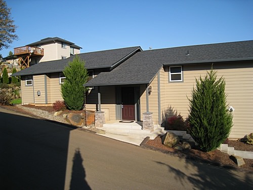

Chris Bernhardt Posted October 29, 2007 Report Share Posted October 29, 2007 Crawlspace: Silt (Dry fine mud) stains the top of the vapor barrier in the crawlspace. The silt indicates prior water in the crawlspace (which could either be from the time of construction, episodic or seasonal. Thereââ¬â¢s no way for me to tell). Check the crawlspace during the rainy season after extended rains. If there is water getting on top of the vapor barrier, first take a look and see if there is a simple explanation as to why water is filtering in and correct it (for example minor grading and drainage issues at the exterior). If there is no obvious point of entrance then have a small sump pump dewatering system installed to control the water to below the level of the vapor barrier. Such an installation should cost less than $500 to install if itââ¬â¢s needed at all. Image Insert: 78.9 KB Image Insert: 81.25 KB OK, would you kindly Katenize this. Chris, Oregon Quote Link to comment Share on other sites More sharing options...
Chad Fabry Posted October 29, 2007 Report Share Posted October 29, 2007 Crawlspace: There is silt on the vapor barrier in the crawl space. It may be left over from the construction phase or episodically deposited by certain weather conditions that cause the crawl to flood. When it's been warm and dry there's no way to tell. Try asking the current owners if they've ever noticed water in the crawl or if they know why the silt is there. Check the crawlspace during the rainy season after extended and /or heavy rains. If there is water on top of the vapor barrier, first take a look and see if there is a simple explanation as to why water is filtering in and correct it (for example minor grading and drainage issues at the exterior). that's your jobid="green"> If there is no obvious point of entrance and I didn't see any indication that there would be, have a small de-watering system installed to control the situation. Quote Link to comment Share on other sites More sharing options...

hausdok Posted October 29, 2007 Report Share Posted October 29, 2007 That barrier was put down before the home was framed and there isn't a water line. A lot of that silt could have accumulated over the time between installation of the barrier and when they finally got the roof over the whole thing and dried it in. Sometimes there can be a foot of water in the foundation with the plastic half-floating on top before they ever get the roof on. If that had happened, there probably would have been some kind of water line evident. When I see them with that much muck on top, no water line, and the exterior drainage and guttering seem to be fine, I recommend putting down a clean barrier over the existing one and then checking the crawlspace at least once during the rainy season. I don't specify January - usually I tell them 'sometime in the middle of the winter rainy season.' Unless you do that, it's probably going to be impossible for the client to know at some future point, unless he or she actually enters the crawlspace when there's water in there, whether the muck was left behind from flooding that took place before the home was framed in or water has entered since taking delivery of the home. Yeah, that is a form of monitoring, I suppose. I don't know whether I can totally agree with Chad; that's it's Chris' or any other home inspector's job to know what's causing it. Sometimes, there's no way an inspector can know anything except, "There's been water over the vapor barrier that's left silt deposits." If there's no evidence of current flooding, and it could have occurred during construction, or was caused by an issue that's been repaired, the only way to know and be 100% certain that it's not still occurring is to conduct a grading test around the structure. How many homeowners are going to allow that? So, you have to create a situation where the new homeowner at least has a way of knowing whether there's been flooding or not. The cost of a whole new barrier that's not completely sealed to the walls and piers and at overlaps can be less than $50 in materials and an hour or two of labor. That's a relatively cheap way of knowing in the future if you've still got water. I tell every client that he or she needs to either personally, or hire someone to, inspect conditions in their attics and crawlspace at least annually. If you're going to tell your clients to make sure they're checking and cleaning their gutters, telling them to make sure they check the roof for missing/torn shingles, telling them to ensure they keep vegetation off the structure, maintain proper earth-wood clearance, and periodically inspect and touchup the exterior paint and caulking, you need to tell them to make sure they periodically look at these areas as well. ONE TEAM - ONE FIGHT!!! Mike Quote Link to comment Share on other sites More sharing options...
