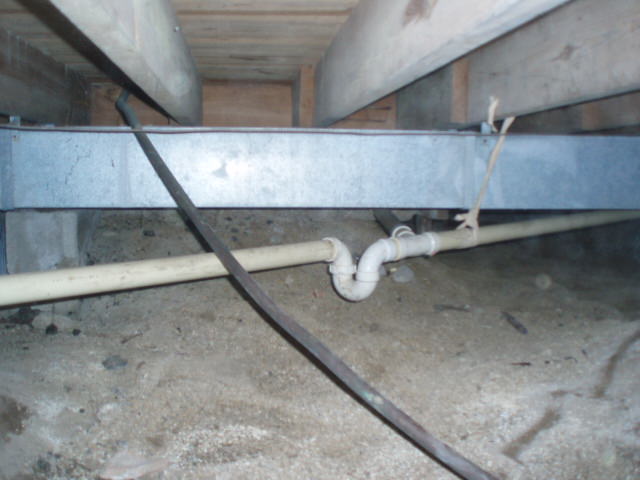

Jerry Simon Posted December 16, 2007 Report Share Posted December 16, 2007 Why would this trap be here? It's downstream from already-trapped kitchen sink and slop-sink waste lines. What problems does double-trapping cause? Siphoning-out both? Image Insert: 159.58 KB Quote Link to comment Share on other sites More sharing options...
hausdok Posted December 16, 2007 Report Share Posted December 16, 2007 That's not going to siphon any trap dry, it's too far away from the first trap to do that. Don't know why anyone would put a trap there. OT - OF!!! M. Quote Link to comment Share on other sites More sharing options...
Bain Posted December 16, 2007 Report Share Posted December 16, 2007 Plumbers call that a "running trap," and it isn't allowed here. It's shinier than the other PVC; probably a well intended improvement by a Bubba. Quote Link to comment Share on other sites More sharing options...
Jim Katen Posted December 16, 2007 Report Share Posted December 16, 2007 Perhaps it was someone's attempt at constructing an expansion offset. Was the trap in the middle of a particularly long, straight run? - Jim Katen, Oregon Quote Link to comment Share on other sites More sharing options...
fqp25 Posted December 16, 2007 Report Share Posted December 16, 2007 Somebody could have installed that running trap to serve a floor drain or condensate drain they added "after the fact". (Post Construction). I've seen that a lot. Is that Tee a vent or another drain line? Quote Link to comment Share on other sites More sharing options...
Jerry Simon Posted December 16, 2007 Author Report Share Posted December 16, 2007 Originally posted by Jim Katen Perhaps it was someone's attempt at constructing an expansion offset. Was the trap in the middle of a particularly long, straight run? - Jim Katen, Oregon Yes. Quote Link to comment Share on other sites More sharing options...
Jerry Simon Posted December 16, 2007 Author Report Share Posted December 16, 2007 Originally posted by fqp25 Somebody could have installed that running trap to serve a floor drain or condensate drain they added "after the fact". (Post Construction). I've seen that a lot. Is that Tee a vent or another drain line? Drain. Quote Link to comment Share on other sites More sharing options...
Chris Bernhardt Posted December 16, 2007 Report Share Posted December 16, 2007 I have seen the use of a running trap on the laundry drain alot here on older construction. When I see it done in ABS or PVC it means that Bubba replaced the line and was just copying what was there before. The functional issue is that the velocity of water entering the trap is not enough to scour the trap and keep it clean. Ideally you want your traps at the end of a vertical drop so that turbulence occurs and scours the trap. Chris, Oregon Quote Link to comment Share on other sites More sharing options...

AHI in AR Posted December 16, 2007 Report Share Posted December 16, 2007 Just out of curiosity in trying to guess why that was done that way...is it possible that the drain just upstream of the trap is coming off a clothes washer? The photo doesn't show its full length. If that was a remodel, it may have seemed easier to the installer to put the trap there since he had to cut the drain anyway. After all, when you see the drains strapped up with rope slopped over the duct work you have to wonder... Quote Link to comment Share on other sites More sharing options...
msteger Posted December 18, 2007 Report Share Posted December 18, 2007 The reason the trap was installed where it is located is because Bubba ran the pipes from either end and cut the pipes before realizing that he was a little short. All he had left over was some small fittings and a trap, so Bubba primed and glued them to make the two PVC lines meet. Quote Link to comment Share on other sites More sharing options...
