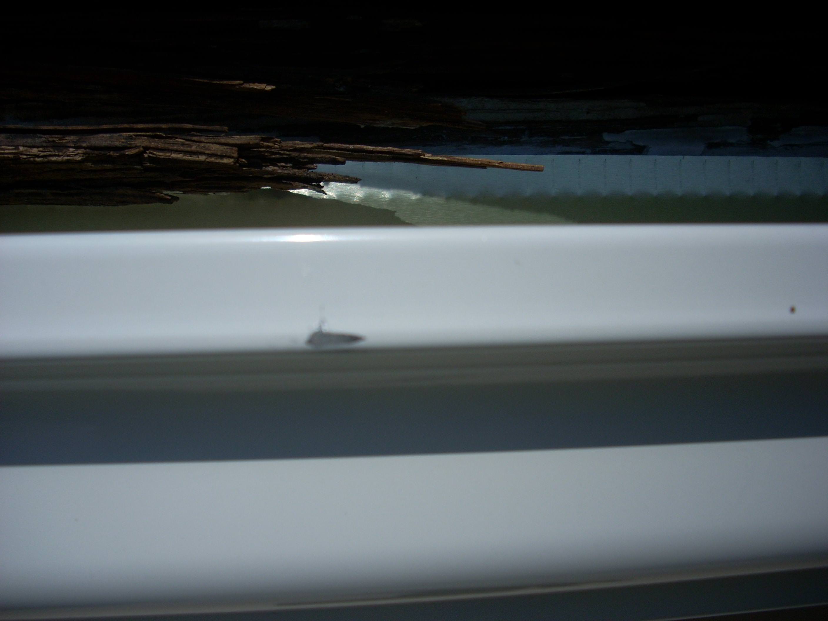

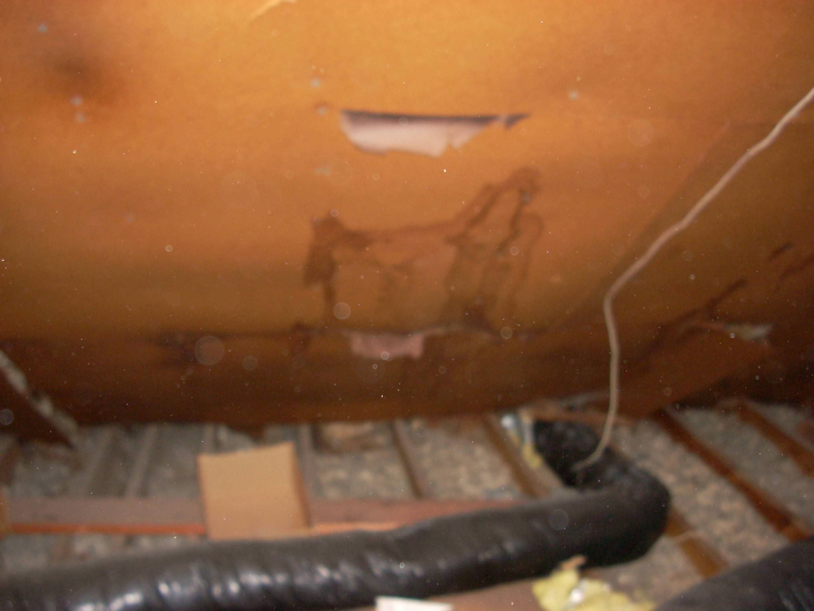

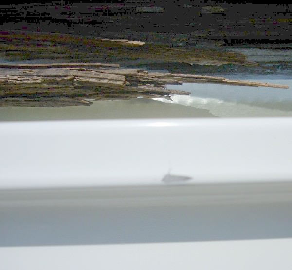

sepefrio Posted March 13, 2008 Report Share Posted March 13, 2008 Did a house today and as I drove up I had the mistaken assumption of "Cool, a brand new roof, this is going to be easy." Well, I was only partially right. The shingles were new, but the wood underneath was probably still from 1954 when it was built. At the roofs edge I peeked under the shingles touched the wood and it crumbled. I moved my ladder again and again, every place I looked, the wood was rotten. In the attic, the roof has insulation covered with a 1/4inch think paper board type material covered with multiple water stains. As such I could not get a good look at the roof material. The exhaust vents were insulated over, no soffit vents and only one gable vent. From the attic, I could see daylight around the edges of all the plumbing vents. I was asked by the buyers Realtor if I would be willing to back up my report in court if needed. It seems he called the sellers agent when I found this, who in turn called the seller who then called the roofer who said tuff luck, no warranty. BTW the roof was replaced only 22 days ago. I told them I would tell what I saw, but that the majority of the roof was hidden from view. I recommended, STRONGLY, that they get a new roofer to come out and provide their opinion as it would hold more weight in any legal action. The amazing part is the buyers still want the house. I would run as fast as I could, but I think these people are downsizing their house as they couldn't afford their last one. Actually the most amazing part is that there are contractors out there that do this kind of work and when called on it tell the client "Tuff luck". This is one of the reasons I became a HI. Here are some pictures, some are not the best of quality but if you look good you can see it. Image Insert: 678.45 KB Image Insert: 336.1 KB Image Insert: 366.56 KB Image Insert: 341 KB Link to comment Share on other sites More sharing options...
Les Posted March 13, 2008 Report Share Posted March 13, 2008 John, that paper board material is Upsom board and fairly common in most of the mid-west. Link to comment Share on other sites More sharing options...

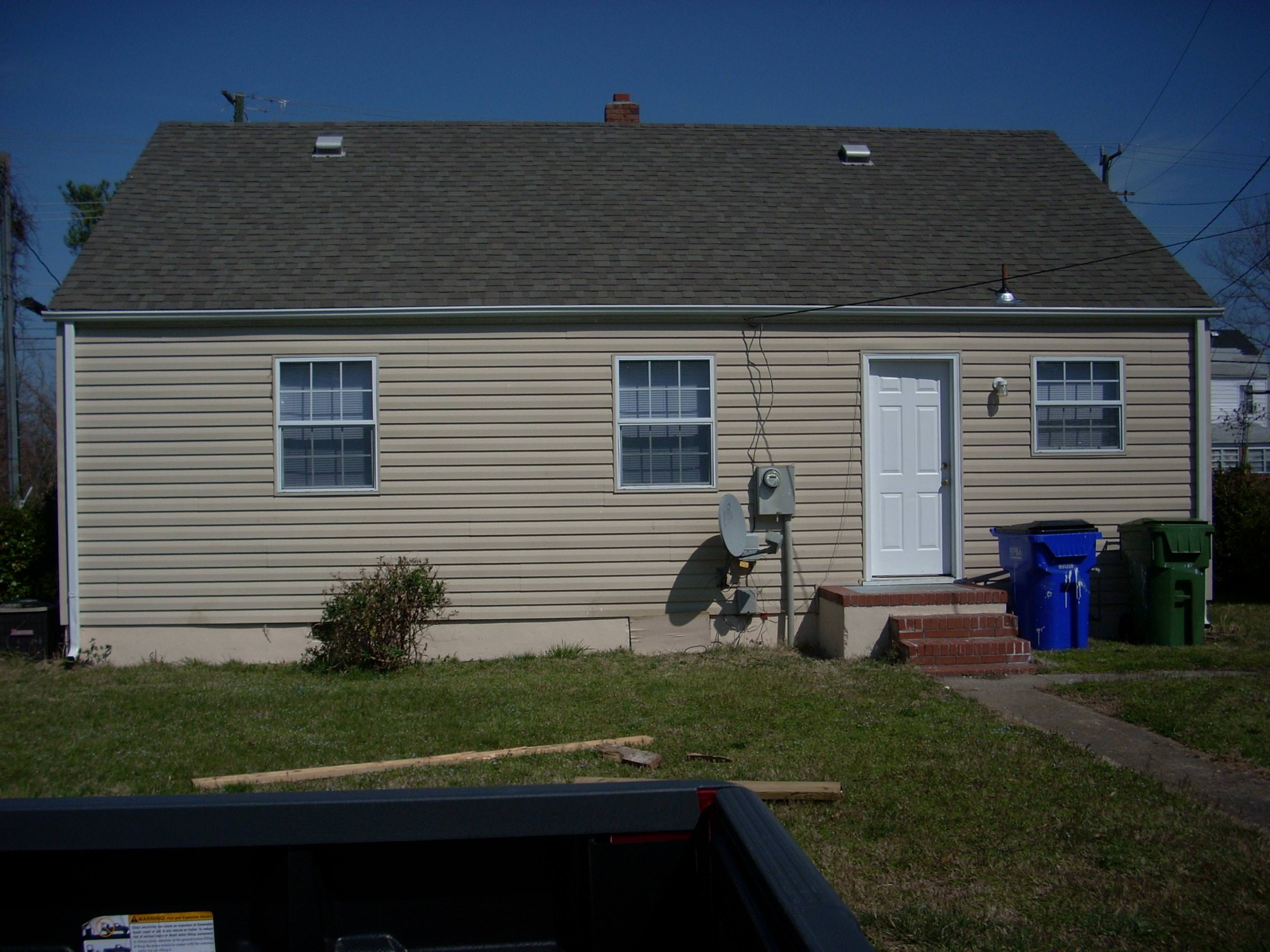

Richard Moore Posted March 14, 2008 Report Share Posted March 14, 2008 Image Insert: 62.65 KB Man...if that is typical of the roof decking, it's hard to imagine a good roofer doing this, although I'm sure some cowboys would. New shingles, new gutters, and just hope it doesn't get inspected! [:-bigeyes BTW...I'd find it very annoying to lose my TV signal every time someone takes out the garbage. That's the best location they could come up with for the dish? Image Insert: 110.1 KB Link to comment Share on other sites More sharing options...
