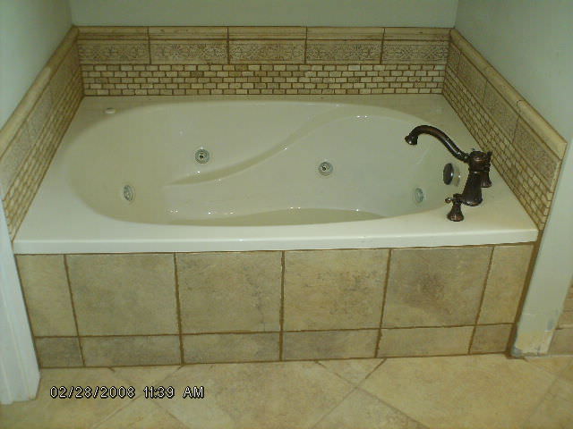

Phillip Posted March 15, 2008 Report Share Posted March 15, 2008 I have been writing the lack of access to get under the whirlpool tubs to get to the pumps and the electrical. New construction. Builder says that the access is the large marble panel that runs the length of the tub. Says all you have to do is to cut the caulking and remove the panel. I don't think so. Do you think that set up is an access panel. Link to comment Share on other sites More sharing options...

Phillip Posted March 16, 2008 Author Report Share Posted March 16, 2008 I don't have a photo of that tub. This photo is the same tub set up, same builder,and no access. They used tile here instead of marble. Image Insert: 75.71 KB They have the GFCI for it in the bathroom closet Link to comment Share on other sites More sharing options...

AHI in AR Posted March 16, 2008 Report Share Posted March 16, 2008 Originally posted by Darren Kevin, Do you cut the caulk and remove the panel to conduct your inspection? After all, there are many items that need to be checked: bonding if it's needed pumps not supported correctly leakage missing insulation on an exterior wall If the access is not present or easily removal, I call it out. Darren--I WOULD write up the situation in Phillip's photo with the tile. To gain access there for repairs or maintenance would require removing the tile facing or cutting a hole in the drywall at the end of the tub. In my mind, neither of those qualifies as a panel, and repairs would be much more costly than replacing a bead of caulk. As for your other concerns, I don't cut the caulk myself. That's a little too invasive. The panel does not meet the definition of readily accessible in the SOP. As I see it, I am not required to remove it. In fact, I'd have sellers pretty hot at me if I did take them off. And looking for leaks? If the home is on a suspended floor, a leak will be visible from underneath, same as a one-piece standard tub. You don't need to remove the panel to see it in the crawlspace. If it's on a slab, you can't see anything underneath that one-piece standard tub either since it has no panel whatsoever. The same is true about missing insulation. You can't see it behind a cast iron tub or shower/tub...or a fiberglass one, either, once drywall is up. So that just leaves wiring issues and pump support. I'll admit that those items are not inspected if the panel is caulked in place. However, this is a new home we're talking about here. I don't know about all jurisdictions, but around here, the plumbing inspector and the electrical inspector won't sign off their finals without being able to see underneath. I've built homes for 25 years, and it's been that way as long as I can remember. So long as it's on a dedicated GFCI protected circuit and the outlet is readily accessible elsewhere, I don't make an issue of a caulked but otherwise easily removable panel which won't get damaged in the process. Oh yeah-- The panels we're talking about are 3/8" thick cultured marble. They're light weight and removing them is a one man operation. Link to comment Share on other sites More sharing options...
