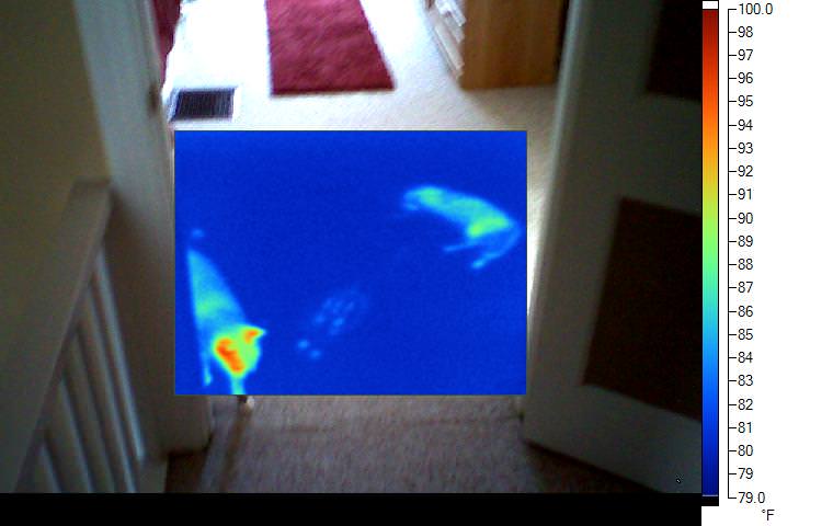

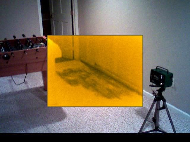

Chris Bernhardt Posted May 21, 2009 Report Share Posted May 21, 2009 The laser pointer is important; I use mine all the time to pin point anomalies for scanning with my moisture meter. I have heard that the picture in picture thing is not used for scanning so much as for taking the shot for the report. You can do picture in picture with the flir Bcam, you just need to do it offline in the computer with some freeware that allows you to overlay photos. As far as the resolution, more will get you better pics, but you can easily get by on the Bcams resolution for trying to uncover wet walls, ceilings and floors, etc. Chris, Oregon Quote Link to comment Share on other sites More sharing options...
Tom Raymond Posted May 21, 2009 Report Share Posted May 21, 2009 Chris, My b60 b40 (oops) has a picture in picture mode on the camera. I don't like it much because it resizes one of the images and the targets don't line up. The orange rectagle at the top of the IR image is the bottom of the cabinet you can see at the top of the background image. Click to Enlarge 13.43 KB What is the freeware you use to fuse images? Quote Link to comment Share on other sites More sharing options...
Chris Bernhardt Posted May 22, 2009 Report Share Posted May 22, 2009 I use "Merge". You have to fiddle with it a bit. You bring the first pic in and size it, then the IR pic and scale and position it, which shows up in a third window as the composite pic. It's not perfect. You have to try and take the photo and the IR pic at the same azimuths. Chris, Oregon Quote Link to comment Share on other sites More sharing options...
