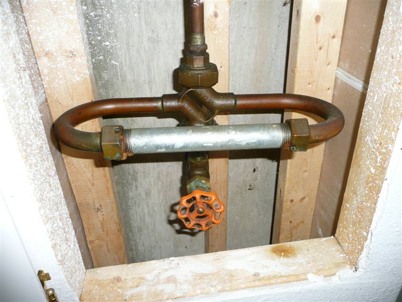

Mark P Posted April 10, 2008 Report Share Posted April 10, 2008 I've had a strange week with a number of first, but this one peaks my interest the most. This is where the main water line enters the foundation wall. What is with the circle / loop thingy? House is around 50 ââ¬â 60 years old. Download Attachment: 1.jpg 86.11 KB Link to comment Share on other sites More sharing options...
Bill Kibbel Posted April 10, 2008 Report Share Posted April 10, 2008 The galv. pipe is where the water meter is supposed to be. Link to comment Share on other sites More sharing options...
Mark P Posted April 10, 2008 Author Report Share Posted April 10, 2008 Gee Bill once you say it, it makes so much sense and is so simple. Thanks. I was thinking some kind of funky water hammer, but it just did not make sense. I guess they moved the meter down by the road. Being a meter reader back then must have been a pain. Knocking on everyones door to come in and read the meter. They must have had to return to the same house often. Link to comment Share on other sites More sharing options...

RickSab Posted April 11, 2008 Report Share Posted April 11, 2008 OK, so did you find a meter? Is this an illegal hook-up? Rick Link to comment Share on other sites More sharing options...
Mark P Posted April 11, 2008 Author Report Share Posted April 11, 2008 In my area the meters are buried in the front yard near the street, under a steel lid - I never look for them. Link to comment Share on other sites More sharing options...
Brandon Whitmore Posted April 12, 2008 Report Share Posted April 12, 2008 In my area the meters are buried in the front yard near the street, under a steel lid - I never look for them. I check them to make sure there is no leakage in the service pipe between the street and house. I have found several so far that had issues. Link to comment Share on other sites More sharing options...
