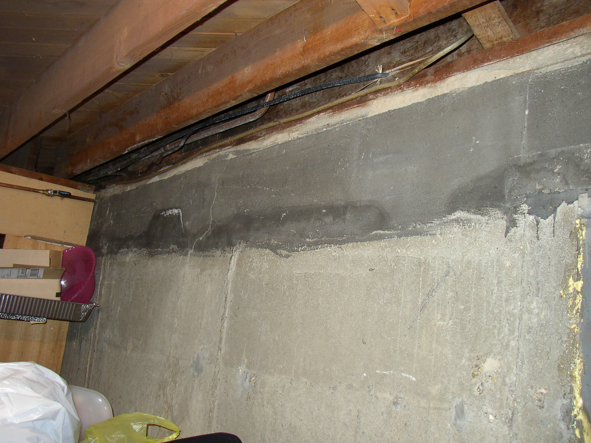

inspectorchris Posted April 14, 2008 Report Share Posted April 14, 2008 Hey Guys, I performed an inspection yesterday and along the entire perimeter of the foundation I saw this ( the Picture ). This is well above the soil line and there was a small crack at one point in the foundation that I was able to see that it is not a patch or parging of the interior foundation wall but is indeed part of the upper section of the foundation. The one thing I thought was maybe the builder build the original foundation to low and had to raise the level. I don't think it could be different pours on the original build because the level is to consistent around the entire perimeter. I wasn't too concerned about it, but more curious. My question is should I be? Image Insert: 718.17 KB Link to comment Share on other sites More sharing options...
kurt Posted April 14, 2008 Report Share Posted April 14, 2008 How old is the house and how high are the bsmt. ceilings? Reason I ask, is I recall when a lot of foundation contractors only had 8' forms. If one wanted 9' ceilings in the bsmt., an 8' wall was poured, and after it had set up, they came back to add another 12". Whatever the reason, I'm guessing it's original, where the builder added on another section to "raise" the 1st fl. elevation. Link to comment Share on other sites More sharing options...
inspectorchris Posted April 14, 2008 Author Report Share Posted April 14, 2008 The house was built in the 50's and the ceiling was 9' high. That does make alot of sense. There are alot of these style homes in this area and this is the first time I've seen this. It maybe that the cement is so different that this one is more noticeable. Link to comment Share on other sites More sharing options...

kurt Posted April 14, 2008 Report Share Posted April 14, 2008 Yep, concrete. On second look, it looks there's cracks that might be consistent w/a 12" block laid on top of the original poured wall in that parging. I bet they laid a block course and parged it. Either way, I think someone just added a foot to make the bsmt. ceiling taller. If there are no other distinguishing conditions, I'd say it's fine. Link to comment Share on other sites More sharing options...
inspectorchris Posted April 16, 2008 Author Report Share Posted April 16, 2008 Thanks. Thats what I thought but I figured I would ask just because it seemed a little off but wasn't sure if it was anything or not. Link to comment Share on other sites More sharing options...
