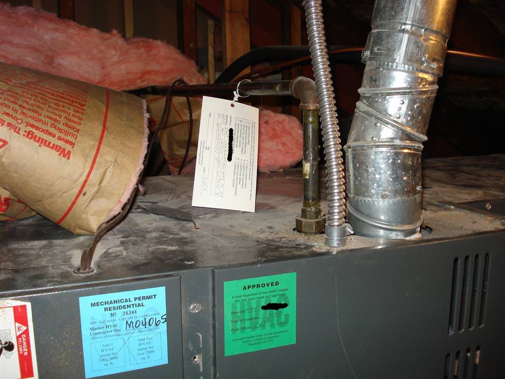

Bain Posted May 19, 2008 Report Share Posted May 19, 2008 Yes, it's difficult sometimes to know who to trust. This new furnace was installed by an HVAC contractor, inspected and approved by the local AHJ, and soon thereafter red-tagged by the local gas utility because the vent didn't terminate 18" above a dormer wall within 8' of the vent. Nevermind that the primary and secondary condensate drains discharged directly into the crawlspace. Image Insert: 127.54 KB Quote Link to comment Share on other sites More sharing options...

Darren Posted May 19, 2008 Author Report Share Posted May 19, 2008 Eric, Letting it go may result in a death. Attached is a picture of an attic installed vent (single wall vent in attic is not allowed); 6 years old. Oh yeah, house was inspected about 18 months prior. I believe this is a serious problem that we call out but will probably never get properly repaired because no one will do the proper calculations. With the software, all that is needed is to plug in the numbers. As Neal pointed out above, it will even ask the question if the masonry chimney is interior or exterior. Somewhat depressed in NJ Image Insert: 227.86 KB Quote Link to comment Share on other sites More sharing options...
