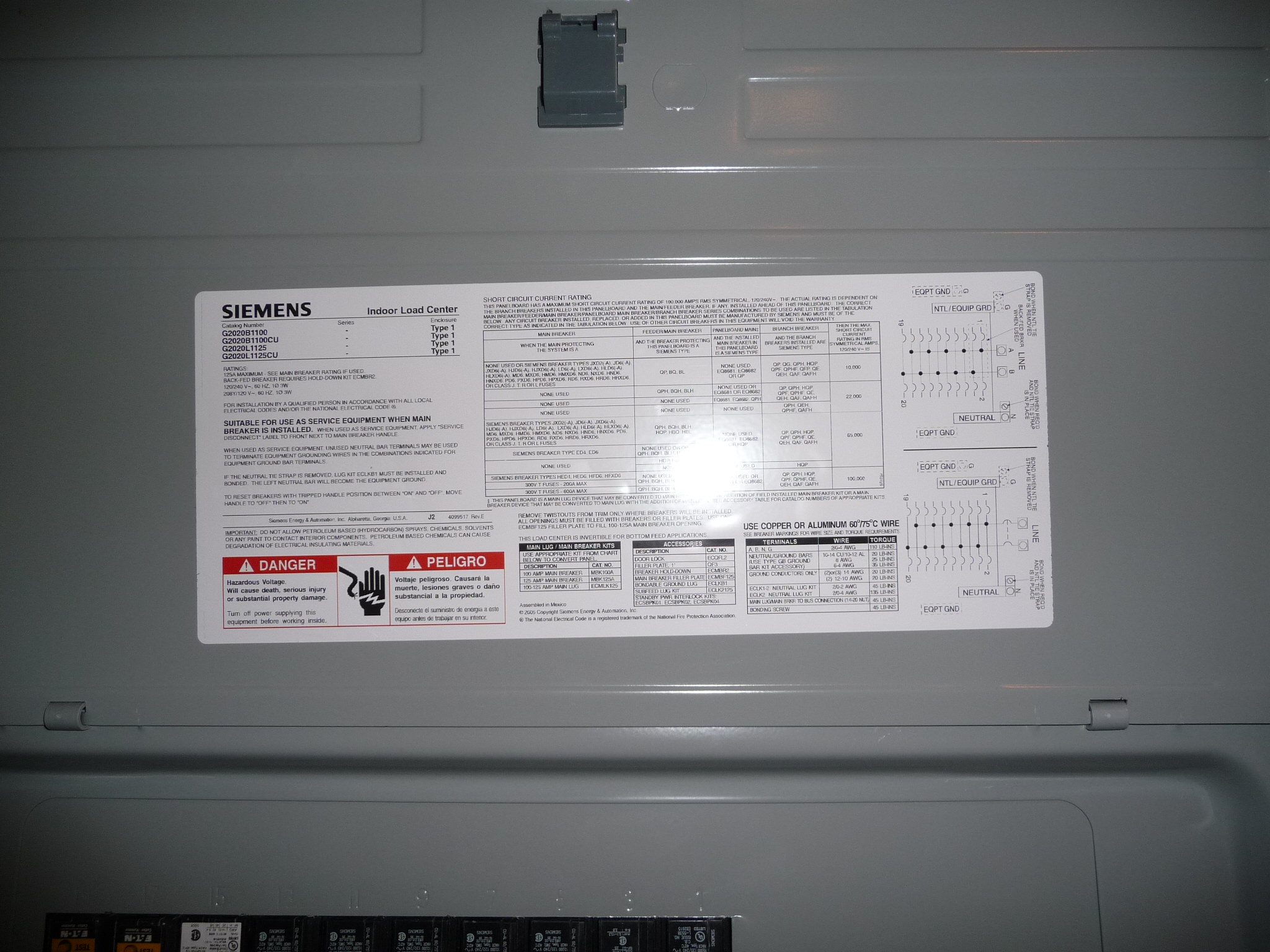

Mark P Posted November 11, 2008 Author Report Share Posted November 11, 2008 It is a 100 amp service and there are 20 slots. They have 3 - 240v breakers and 18 120v breakers - 8 of which are tandum breakers so there are 2 circuits on each slot. Quote Link to comment Share on other sites More sharing options...
Jim Katen Posted November 11, 2008 Report Share Posted November 11, 2008 Originally posted by AHIS It is a 100 amp service and there are 20 slots. They have 3 - 240v breakers and 18 120v breakers - 8 of which are tandum breakers so there are 2 circuits on each slot. Cheezy but probably adequate. - Jim Katen, Oregon Quote Link to comment Share on other sites More sharing options...
Brian G Posted November 11, 2008 Report Share Posted November 11, 2008 Originally posted by AHIS It is a 100 amp service and there are 20 slots. They have 3 - 240v breakers and 18 120v breakers - 8 of which are tandum breakers so there are 2 circuits on each slot. I would bet money that violates the maximum number of circuits allowed by the manufacturer of the panel. If I count that correctly you have 32 circuits there, and I've never heard of a 100 or 125 amp panel that allowed more than 24 (most stop at 20). You'd have to check the label on the panel to see exactly what they had in mind. Brian G. Pile 'Em In [:-crazy] Quote Link to comment Share on other sites More sharing options...

Mark P Posted November 11, 2008 Author Report Share Posted November 11, 2008 Originally posted by Brian G Originally posted by AHIS It is a 100 amp service and there are 20 slots. They have 3 - 240v breakers and 18 120v breakers - 8 of which are tandum breakers so there are 2 circuits on each slot. I would bet money that violates the maximum number of circuits allowed by the manufacturer of the panel. If I count that correctly you have 32 circuits there, and I've never heard of a 100 or 125 amp panel that allowed more than 24 (most stop at 20). You'd have to check the label on the panel to see exactly what they had in mind. Brian G. Pile 'Em In [:-crazy] I can't find where the label states the max # of circuits allowed. I'll upload the pic, but you'll have to zoom in to read it. Download Attachment: 1.jpg 1530.21 KB Quote Link to comment Share on other sites More sharing options...
hausdok Posted November 11, 2008 Report Share Posted November 11, 2008 Originally posted by Jeremy Is the new construction a whole house or addition to existing home? I just thought all new homes were getting at least a 200 Amp service with all the modern day appliances going into them. Maybe a cop out from doing the load calculations? There are condominiums being built around here with 100 amps systems and houses with 125-amp systems and folks don't seem to be having any problems handling what look to be very normal loads to me. I agree that a 200-amp service provide a whole lot more wiggle room but I don't think it's essential. Heck, FHA just increased it's requirement and that's only 100 amps. ONE TEAM - ONE FIGHT!!! Mike Quote Link to comment Share on other sites More sharing options...
Jim Katen Posted November 12, 2008 Report Share Posted November 12, 2008 Originally posted by AHIS Originally posted by Brian G Originally posted by AHIS It is a 100 amp service and there are 20 slots. They have 3 - 240v breakers and 18 120v breakers - 8 of which are tandum breakers so there are 2 circuits on each slot. I would bet money that violates the maximum number of circuits allowed by the manufacturer of the panel. If I count that correctly you have 32 circuits there, and I've never heard of a 100 or 125 amp panel that allowed more than 24 (most stop at 20). You'd have to check the label on the panel to see exactly what they had in mind. Brian G. Pile 'Em In [:-crazy] I can't find where the label states the max # of circuits allowed. I'll upload the pic, but you'll have to zoom in to read it. Download Attachment: 1.jpg 1530.21 KB The schematic on the right shows only 20 breakers. No tandems or wafers are permitted in this panel. - Jim Katen, Oregon Quote Link to comment Share on other sites More sharing options...
Brian G Posted November 12, 2008 Report Share Posted November 12, 2008 Originally posted by Jim Katen The schematic on the right shows only 20 breakers. No tandems or wafers are permitted in this panel. Agreed. It may or may not be overloaded in terms of amps, but it's definitely in violation of the manufacturer's specs on maximum number of circuits. It happens a lot. Brian G. Warranty, Thou Art Null & Void [:-wiltel] Quote Link to comment Share on other sites More sharing options...
Mark P Posted November 12, 2008 Author Report Share Posted November 12, 2008 It is only 0647 in the morning and I've learned something already. Its the schematic that shows the max and type of breaker. I'm going to take a picture of every panel label I see for the rest of the month (maybe year) and study it carefully. Thanks Jim / Brian Quote Link to comment Share on other sites More sharing options...
