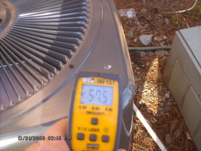

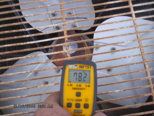

Phillip Posted December 27, 2008 Report Share Posted December 27, 2008 Here in Alabama we do not have that much cold weather. Sunday and Monday was cold and the rest of the week has been up in the 60s and 70s. This time of year I will shoot the temp on the compressor casing before I test it. If the temp is too low I will not run them. On todays inspection I shot the casing and it was 111.3. I shot the fan housing and it was 78. What would cause this higher temp?Click to View 53.96 KB Click to View 59.62 KB Quote Link to comment Share on other sites More sharing options...

energy star Posted December 27, 2008 Report Share Posted December 27, 2008 The crankcase heater was on. A heater, either wraps around or is installed in the compressor to prevent the the migration of liquid refrigerant to the compressor (out side) R-22 will always go to the coldest area in the system. A compressor is designed to pump gas not liquid. (Scroll compressors have less of a problem) So after a long sit in the cold, and the first start up occurs a gas is present, not liquid that will slug up the compressor and perhaps damage it. I do not know why the the fan shroud or casing was a bit warmer? Heat gain from the sun. I would not think that the crankcase heater would generate the much excessive heat, but I could be wrong. I find I do get things wrong more than I would like. Ha ha. Quote Link to comment Share on other sites More sharing options...

Phillip Posted December 31, 2008 Author Report Share Posted December 31, 2008 To day the sun is shinning and the temp is 59 degrees. I when out and shot the temps on my heat pump unit. It is one year old Goodman. The exterior of the unit was 57.5 Click to View 60.93 KB The fan housing was 77.5 Click to View 73.81 KB The compressor casing was 75.2 after being on and running today. Click to View 86.63 KB Quote Link to comment Share on other sites More sharing options...
steve morris Posted January 4, 2009 Report Share Posted January 4, 2009 On a TRANE unit of that vintage the mfg. uses the start winding in the compressor as a crankcase heater.(I believe this is a bad idea,Florida being the lightning capital of the country, a lot of shorted start windings) The temp. you stated is a little high, it may have other problems and the compressor is cyling on the internal t-stat embeded in the winding. When the control contactor goes bad some a/c tech.(for lack of a better name) may have miss wired the new one in, I found them all the the time when I was in the business. Quote Link to comment Share on other sites More sharing options...
