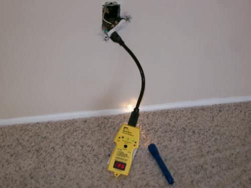

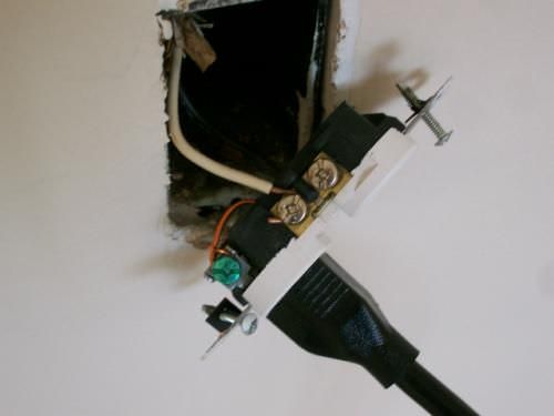

hausdok Posted April 9, 2009 Report Share Posted April 9, 2009 Editor's Note: The following was submitted via email by Jim Simmons; user name - Mr. Electric. Jim is a Master Electrician and regularly provides electrical training to home inspectors in the northwest. After you check out the photos, you might want to enter the raffle for a custom chopper that Jim is sponsoring for Ronald McDonald House Charities; the information is below. Hi All, I ran into this situation yesterday. It is a house that the owner installed 3 wire outlets in the house illegally. Thought you would enjoy the pictures. There is no ground with the branch circuit wiring. The pictures show an outlet (all of them in the house were the same way) where the owner tapped off the neutral on the outlet so the plug would look like it was grounded. IT IS NOT GROUNDED! A simple $7 tester will test this outlet as OK. The Ideal tester I use clearly shows FG on the display, or False Ground. I have seen it many times over the years but this is the first time I got good pictures of it. You can see the copper jumper from the ground terminal to the neutral. Click to Enlarge 17.44 KB I use an Ideal - Sure test. It will find this situation (FG). I do not recommend that home inspectors go further than this with the tester (it will check voltage drop and other things) without a clear understanding of the tester, and what the additional information means to the customer. Click to Enlarge 19.2 KB Finding the false ground issue is important. The tester will also test GFCI and proper wiring so you don't also need the $7 tester. The other thing nice about it is the flexible cord (you can also use it without the cord). Click to Enlarge 14.94 KB Jim P. Simmons Mr. Electric 360-705-4225 WIN A CUSTOM CHOPPER!!! Buy a ticket for yourself or a friend! Only $25. See the Mr. Electric Custom Chopper and enter at this link. All proceeds go to Ronald McDonald House Charities. Quote Link to comment Share on other sites More sharing options...

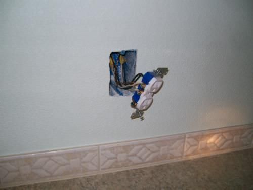

Mr. Electric Posted April 9, 2009 Report Share Posted April 9, 2009 Just a note - The first picture is showing a grounded outlet (although the grounds should have a crimp sleve or green wirenut to meet code). Quote Link to comment Share on other sites More sharing options...
Terence McCann Posted April 9, 2009 Report Share Posted April 9, 2009 Jim, what is the model number of your Ideal tester? Will it show numerous faults IE. False Ground and Reverse Polarity? Quote Link to comment Share on other sites More sharing options...

AHI in AR Posted April 9, 2009 Report Share Posted April 9, 2009 Jerry-- The manual that came with my Sure Test states that a properly grounded receptacle within 15' of the service panel may incorrectly show as having a false ground. Quote Link to comment Share on other sites More sharing options...
Chad Fabry Posted April 10, 2009 Report Share Posted April 10, 2009 False Ground and Reverse Polarity? That's a nasty combination... hot covers and screws. My older Sure Test will not identify that condition. I think it's a 61-155? or maybe 61-151 I know it won't because ITA provided a panel with various mis-wired receptacles and GFCI's for us to use in our class. The panel was plexiglass and if one studied the wiring (it had to be studied because I'm pretty sure Hansen wired it and it wasn't that easy to follow) one could spot a receptacle that was FG and reverse polarity, SureTest says "all good". Quote Link to comment Share on other sites More sharing options...
hausdok Posted April 10, 2009 Author Report Share Posted April 10, 2009 Hi, Like Jim says; you have to have a clear understanding of what information the device can give you. The manual that came with mine is very clear that within about 15ft. to the service eguipment it may give a false ground reading, even when there isn't a false ground, and it can't diagnose more than one problem at a time. For instance, if you've got reversed polarity it can't tell you whether there is a ground or not unless you correct the polarity. It's still infinitely superior to one of those 3-light testers though. ONE TEAM - ONE FIGHT!!! Mike Quote Link to comment Share on other sites More sharing options...

Terence McCann Posted October 21, 2009 Report Share Posted October 21, 2009 To pick this back up again... Besides a booltleg ground what would be some of the other conditions that would cause the Ideal tester to show false ground? I had a condo about a week ago where every outlet on the 2nd floor of the home showed a false ground while every outlet on the first floor was OK. The panel was in the garage so it was a lot more than 15' away. The home was built in the late 80's so proper grounding shouldn't have been an issue. Quote Link to comment Share on other sites More sharing options...
hausdok Posted October 21, 2009 Author Report Share Posted October 21, 2009 To pick this back up again... Besides a booltleg ground what would be some of the other conditions that would cause the Ideal tester to show false ground? I had a condo about a week ago where every outlet on the 2nd floor of the home showed a false ground while every outlet on the first floor was OK. The panel was in the garage so it was a lot more than 15' away. The home was built in the late 80's so proper grounding shouldn't have been an issue. Did you pull one cover and look? Are you sure it was built in the late 80's? Somewhere around the middle of summer I had a building they told me had been built a little more than a decade ago. Outwardly, it looked like it was about a decade old but when I started digging into it I started noticing things like 5-panel doors, 70's vintage stoves, old service panels, etc.. It turned out that the ground floor was new but that the second level was nearly 80 years old and that the original one-story triplex had the original roof torn off, been jacked up and a new truss roof installed; so they could shove a series of garages and another unit beneath. So, there were lots of ungrounded 3-holers on the second level and 1970's panels where they'd replaced the fuse boxes; and on the ground level everything was newer and properly grounded. ONE TEAM - ONE FIGHT!!! Mike Quote Link to comment Share on other sites More sharing options...
Terence McCann Posted October 21, 2009 Report Share Posted October 21, 2009 Hi Mike - actually I did take two covers off. The wiring was 3-wire romex. The date of the townhouse was accurate - it was a complex of 48 units. Quote Link to comment Share on other sites More sharing options...
Jim Katen Posted October 22, 2009 Report Share Posted October 22, 2009 To pick this back up again... Besides a booltleg ground what would be some of the other conditions that would cause the Ideal tester to show false ground? I think that it shows FG in reaction to very low impedance between ground and neutral. That pretty much means that they must have made a connection between the two somewhere nearby, perhaps in a j-box. I had a condo about a week ago where every outlet on the 2nd floor of the home showed a false ground while every outlet on the first floor was OK. The panel was in the garage so it was a lot more than 15' away. It could be that the electrician let his apprentice wire the second floor and he joined some neutrals to some grounds here & there. The home was built in the late 80's so proper grounding shouldn't have been an issue. Hah! Yeah, right! It seems to me that, from 1973 to 1989, the motto of most home builders was, "Build it as stupid as you can." - Jim in Oregon Quote Link to comment Share on other sites More sharing options...
