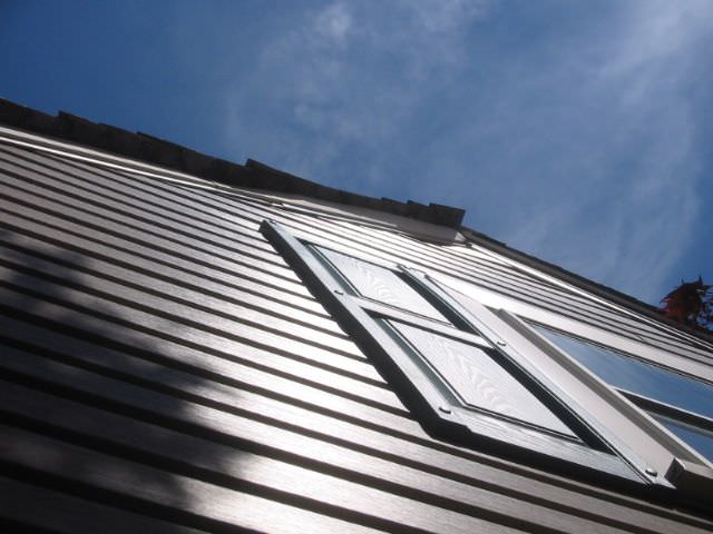

Inspectorjoe Posted April 26, 2009 Report Share Posted April 26, 2009 This is a long shot. Is there a name for the little section of roof left when a shed dormer is added to a cape cod? Click to Enlarge 53.74 KB I'm admiring the exquisite application of shingles, and am particularly enraptured by the genius of using the asphalt shingle itself as flashing. Sheer minimalist brilliance! Gotta love that inward pitch, too. That must have taken some planning. Quote Link to comment Share on other sites More sharing options...
Inspectorjoe Posted April 26, 2009 Author Report Share Posted April 26, 2009 That's exactly what I did - at the inspection. Now I'm writing the report and would like to use the proper name for it. I don't see a downside to being specific. If I found a problem with a pent roof, writing "There's a problem with the pent roof" sounds a whole lot smarter than "There's a problem with the little roof attached to the front of the building". Don't ya think? Quote Link to comment Share on other sites More sharing options...

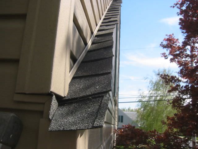

Brandon Whitmore Posted April 26, 2009 Report Share Posted April 26, 2009 That's a real beauty of a rake edge line, and some sweet kick out flashing work at the siding installed in contact with the roofing. There's plenty of contractors? to blame for that workmanship. Quote Link to comment Share on other sites More sharing options...
Inspectorjoe Posted April 26, 2009 Author Report Share Posted April 26, 2009 That's a real beauty of a rake edge line, ... It is a thing to behold, isn't it? Click to Enlarge 53.95 KB and some sweet kick out flashing work at the siding installed in contact with the roofing. Look closer - the roofing IS the kickout flashing. There's plenty of contractors? to blame for that workmanship. I hope that wasn't the work of contractors. More like buddies working for beer. You should have seen the rest of the place. Quote Link to comment Share on other sites More sharing options...
