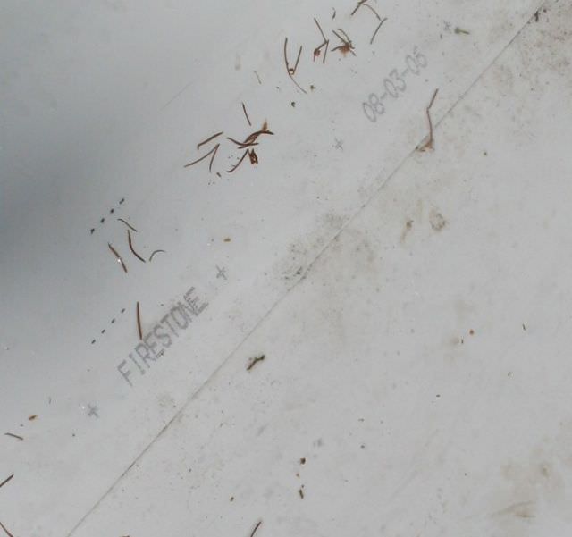

Robert Jones Posted August 5, 2009 Report Share Posted August 5, 2009 Sorry guys, I don't get to many of these and want to be sure I am calling it the right product. Would this be EPDM? Click to Enlarge 34.32 KB Click to Enlarge 42.56 KB Quote Link to comment Share on other sites More sharing options...

Richard Moore Posted August 5, 2009 Report Share Posted August 5, 2009 I generally refer to that stuff as "TPO" (Thermoplastic polyolefin), but I believe it is interchangable with "PVC". I've sometimes found printing along the sheet edges on newer stuff. Click to Enlarge 29.04 KB It does look like you have some (relatively minor?) ponding issues in that 2nd photo. Quote Link to comment Share on other sites More sharing options...
Bill Kibbel Posted August 5, 2009 Report Share Posted August 5, 2009 TPO is not PVC. Although TPO, PVC and CPE are all thermoplastic roof membranes, it's important to be able to identify each. For one example, there's been many issues with TPO formulations, resulting in failures not seen in PVC. Anyone inspecting commercial or apartment buildings should really consider taking a course in commercial roofing. I certainly wasn't qualified to identify materials and their installation requirements before finding the proper training. Quote Link to comment Share on other sites More sharing options...
exploreparadise2 Posted August 5, 2009 Report Share Posted August 5, 2009 Richard's photo probably is TPO because Firestone manufactures TPO and not PVC (PVC is not currently listed on their website). We can't assume that EPDM will always be colored black like an inner tube anymore. Firestone makes an EPDM with a white coating for decreased heat absorption. http://www.firestonebpco.com/roofing/ Quote Link to comment Share on other sites More sharing options...
Richard Moore Posted August 5, 2009 Report Share Posted August 5, 2009 TPO is not PVC. Although TPO, PVC and CPE are all thermoplastic roof membranes, it's important to be able to identify each. For one example, there's been many issues with TPO formulations, resulting in failures not seen in PVC. Anyone inspecting commercial or apartment buildings should really consider taking a course in commercial roofing. I certainly wasn't qualified to identify materials and their installation requirements before finding the proper training. OK...my bad. I need to read up some more. I don't do commercial or whole complexes but I will get on condo roofs, when possible, for a quick gander at the common area roof. I may have mis-identified some stuff in the past, but I'm mainly looking for bad seams, ponding, etc. So I have a question...What's in the photos that would make the first few responders believe it is PVC and not TPO? Quote Link to comment Share on other sites More sharing options...

kurt Posted August 6, 2009 Report Share Posted August 6, 2009 TPO is more smooth surfaced than PVC; this is a fairly subjective analytical method, as the differences are very slight. You can see a little more scrim/fabric texture in PVC. Honestly, I've been fooled a couple times as the differences are minimal. TPO was developed to blend the positive characteristics of EPDM and PVC. It has the UV and heat resistance of EPDM with the hot air weldable feature of PVC's. And, it's white, so it's viewed as a more "green" roofing material. I can't tell which it is from the photo. Quote Link to comment Share on other sites More sharing options...
Bill Kibbel Posted August 6, 2009 Report Share Posted August 6, 2009 TPO is more smooth surfaced than PVC My experience has shown the complete opposite. I can't tell which it is from the photo.Neither can I. Quote Link to comment Share on other sites More sharing options...
kurt Posted August 7, 2009 Report Share Posted August 7, 2009 Yeah, trying to tell them apart by the scrim texture is pretty vague, or impossible. I had a rep try to show me and honestly, I'm not sure I could tell the difference even with him standing there pointing out the differences. If it's newer, I'd guess TPO simply because that's the big push around here instead of PVC. If it's older, I'd guess PVC. Quote Link to comment Share on other sites More sharing options...

kurt Posted August 7, 2009 Report Share Posted August 7, 2009 OK, self correction because this is sort of a vague pathway...... Bill is right. The TPO has a slightly more visible scrim texture than PVC. I checked up, and I was wrong. At least, I think I'm wrong. It's really hard to tell the difference between the two. I do know that some of the early TPO's had a mega-problems with delamination/scrim separation, and none of the installers were welding it correctly. If it's older TPO, beware. Quote Link to comment Share on other sites More sharing options...
Jim Katen Posted August 8, 2009 Report Share Posted August 8, 2009 Sorry guys, I don't get to many of these and want to be sure I am calling it the right product. Would this be EPDM? My guess is TPO. I've seen a ton of PVC roofs and some TPO roofs. Every TPO roof I've seen has had plumbing vent boots that looked like the ones in your picture (the little stair-step jobbies). Some of them even had the letters TPO thoughtfully embossed on them. Not one of the PVC roofs I've seen has had that style of boot on it. - Jim Katen, Oregon Quote Link to comment Share on other sites More sharing options...
