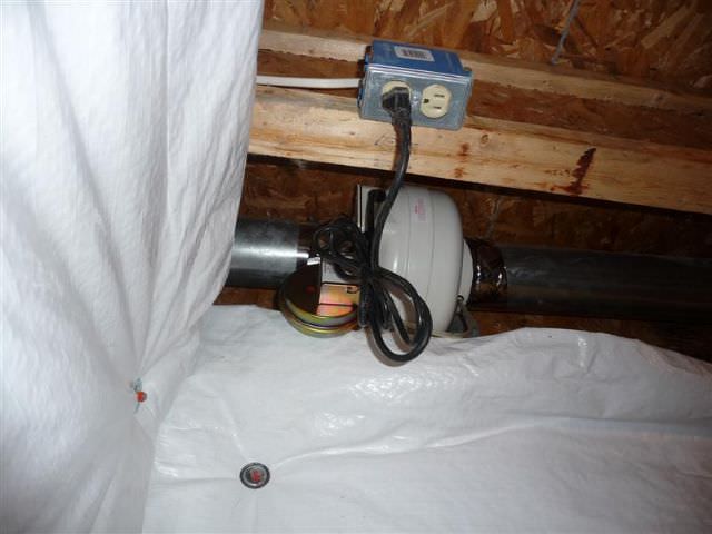

gtblum Posted October 23, 2009 Report Share Posted October 23, 2009 Any exception to the 25 foot vent pipe rule rule when one of these here thingys is added on? This vent was just over 40 feet long. Click to Enlarge 32.35 KB Click to Enlarge 40.14 KB Click to Enlarge 40.05 KB Quote Link to comment Share on other sites More sharing options...
Bill Kibbel Posted October 23, 2009 Report Share Posted October 23, 2009 The first time I saw one, I contacted the manufacturer. They assured me that it can go a max. of 60' with 6 elbows. Also, be sure the fan is a min. of 15' from the dryer. Why you flippin' us the finger? Quote Link to comment Share on other sites More sharing options...
Terence McCann Posted October 23, 2009 Report Share Posted October 23, 2009 Looks a lot like a fan used on Radon systems.. Quote Link to comment Share on other sites More sharing options...

Brandon Whitmore Posted October 24, 2009 Report Share Posted October 24, 2009 There's the booster fan exception as well as the exception that it can be longer if the dryer manufacturer says so. Quote Link to comment Share on other sites More sharing options...
msteger Posted October 24, 2009 Report Share Posted October 24, 2009 Looks a lot like a fan used on Radon systems.. It is indeed very similar to a radon fan. If you look closely in the photo, you will see it does say "dryer exhaust booster system" on it. Quote Link to comment Share on other sites More sharing options...
