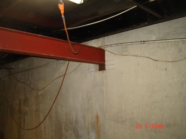

hoosier inspector Posted December 30, 2009 Report Share Posted December 30, 2009 This beam pocket in a 9' basement wall was saw cut instead of cast. All of the beam pockets are simular. The original pockets were cast, but for some reason were lowered (9' wall maybe?)I haven't come across this method and was wondering if it is acceptable or deficient. This area has a crack that has leaked where it intercepts a cold joint but shows no movement. This foundation is 9 years old and holding up a manufactured home. In your opinion, how should I report this? Thanks for any help, Click to Enlarge 32.57 KB what should I report? P.S. Notice the professional plumbing and electrical installations. Link to comment Share on other sites More sharing options...

Greg Booth Posted December 30, 2009 Report Share Posted December 30, 2009 This is a typical installation for HUD code manufactured homes when installed on full basements. The defining element of the HUD code home being the full-length steel beams carrying the floor system. The transverse beams supported at the beam pockets carry the entire home load transmitted by the full-length beams of the home, of course double-wides will have a center lally column. The required number of transverse beams will be specified by the home manufacturer. There is routinely no support at home perimeter unless specified by snow load requirements. If this is a double-wide installation, a key item to note, that is often overlooked, is a support from the center of the transverse beam to the marriage wall band joists. Please excuse any posting errors as this is my first time! Link to comment Share on other sites More sharing options...

hoosier inspector Posted December 31, 2009 Author Report Share Posted December 31, 2009 Thank you all for your responses. I've only been inspecting a few years and sometimes worry too much when I see the unfamiliar. I was concerned about the radii of the overcuts somehow isolating the bearing surface. After thinking about what was discussed I don't see this as a problem anymore. Thanks again. Click to Enlarge 38.23 KB Link to comment Share on other sites More sharing options...
mgbinspect Posted December 31, 2009 Report Share Posted December 31, 2009 Hmmm.. Is that a square steel tube under the beam? That's what it looks like. That's funny. I also used to detail steel. (The ADD mind at work - a wanderer until I finally found a home in home inspections). We never would have found a tube as an acceptable bearing plate. A steel tube isn't designed to receive weight that way, but if it hasn't collapsed or mis-shapen yet, I guess it's ok. As Sargeant Schultz, of Hogan's Heros used to say, "I see nothing... " [:-bigeyes Don't worry about it Hoosier, I'm just surprised by the off the wall (or to put it more accurately 'out of the back of the truck') materials choice. It's fine... Link to comment Share on other sites More sharing options...
Jim Katen Posted December 31, 2009 Report Share Posted December 31, 2009 Hmmm.. Is that a square steel tube under the beam? . . . No, the installer prefers to think of it as an overload indicator. - Jim Katen, Oregon Link to comment Share on other sites More sharing options...
mgbinspect Posted December 31, 2009 Report Share Posted December 31, 2009 Brilliant, Jim!... I love it... You know? I really wish I hadn't seen that tube. The steel of the square tube is at least half the thickness of the web and flanges of the I-beam that was, most likely, engineered for that application. The tube, unfortunatly, truly is the overload indicator. What is happening to the trades? Are there any true tradesmen left or are there merely guys who made it through another week to collect another paycheck? I'm not a big union fan, but there is a LOT to be said for forcing a tradesman to go through a very structured deliberate apprenticeship with levels of accomplishment and earned designations, which instill a sense of pride in both the trade and the workmanship. Link to comment Share on other sites More sharing options...
Matt Klein Posted December 31, 2009 Report Share Posted December 31, 2009 Having inspected some 500 manufactured homes for FHA loan approval, I see nothing wrong with the pocket being cut out versus cast, as long as the job was done without cracking the concrete. At the least, the installer did not try chipping the pocket out. BTW, maybe some folks do not know that most manufactured homes are constructed to be supported on piers when installed over a crawlspace, in which case the perimeter wall is not load bearing, per se. The per se being that HUD rules, as adopted by the states, requires that some perimeter openings, such as doors and some windows, be supported. Many installers shim between the perimeter wall and the underside of the frame under the edges of these openings. When these homes are installed on basement (and some crawlspace) foundations, the foundation becomes load bearing. In most cases, transverse beams are used in place of piers under the carriage beams, which means about every 8 to 10 feet. These beams each must have a column or pier supporting the mid-point. Recently, more manufactured homes intended for basement foundations have been produced that are more like conventional homes in that the home is supported around the perimeter by the foundation and a central beam running the length of the home. The central beam is supported on columns or piers. However, I have another concern in looking at the picture, for homes supported on transverse beams, EVERY end of the beams are supposed to be anchored to the foundation. Additionally, a problem I often find is that the carriage beams are supposed to be welded or bolted to the transverse beam at EACH point where they cross to complete the anchoring of the home. I usually find transverse beams anchored to the foundation, but the home not anchored to the beams. For all purposes, if the home is not attached to the transverse beams, it is not anchored. For homes with a central beam, anchoring is to the foundation, usually using pipe strapping every 6 feet as required by the codes. If in doubt about how a manufactured home is installed, be sure to record the home's manufacturer, where the home was manufactured (because many MH manufacturers have multiple plants or used to before the bad times), and the serial and model numbers. Then call the manufacturer and ask for an installation (piering) diagram to be faxed to you. If the home is newer, the manufacturer might still have the diagrams. Some are better than others. Luck is usually involved, though. Link to comment Share on other sites More sharing options...
