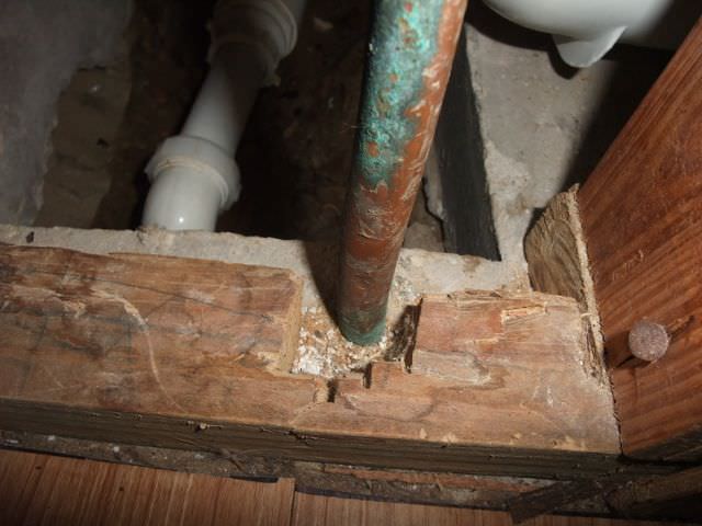

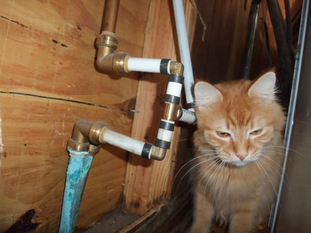

Marc Posted January 6, 2010 Report Share Posted January 6, 2010 Yesterday's inspection of a 30 year old, wood framed, slab supported dwelling revealed spotty but severe corrosion on some copper fresh water lines that were stubbing up through the slab. No vinyl tubing protects these stub ups. Additionally, one failure of a copper line seems to have occurred already about a year ago. PEX pipe was used to replace the isolated run of copper. Question is this: Is this not similar to the elemental sulphur that some claim is the culprit in Chinese drywall? How did this corrosive end up in concrete 30 years ago, assuming that's what the problem here is? The tabby is just pitching for a position as assistant inspector. Click to Enlarge 46.87 KB Click to Enlarge 50.49 KB Marc Link to comment Share on other sites More sharing options...

Chad Fabry Posted January 6, 2010 Report Share Posted January 6, 2010 Concrete is alkaline. It normally takes a while but moist concrete will be aggressive to copper. Just about every water service line I see is a lovely shade of verdigris at the penetration site. Link to comment Share on other sites More sharing options...

Les Posted January 6, 2010 Report Share Posted January 6, 2010 I have the same info as Mike O. Nothing documented. Also, a bizillion 3/4" brass water valves made in Poland, China and Mexico have defective casting and/or alloy. Again, I have nothing to document this, only review of 1000's of inspections. Marc, I suspect there is nothing amiss in that house other than copper vs concrete. Link to comment Share on other sites More sharing options...
Rob Amaral Posted January 7, 2010 Report Share Posted January 7, 2010 That first photo with the cat looks like self-sealed leaks at those fittings... Leaks can start out microscopic and eventually seal themselves. Link to comment Share on other sites More sharing options...
Jim Katen Posted January 7, 2010 Report Share Posted January 7, 2010 . . . Marc, I suspect there is nothing amiss in that house other than copper vs concrete. Well, that, and the fact that they own a cat. If the corrosion is caused by the concrete, why is the corrosion occuring where the concrete isn't? I think that Rob is onto something with his theory of a small leak. Either that, or the cat's been peeing on the pipes. - Jim Katen, Oregon Link to comment Share on other sites More sharing options...
