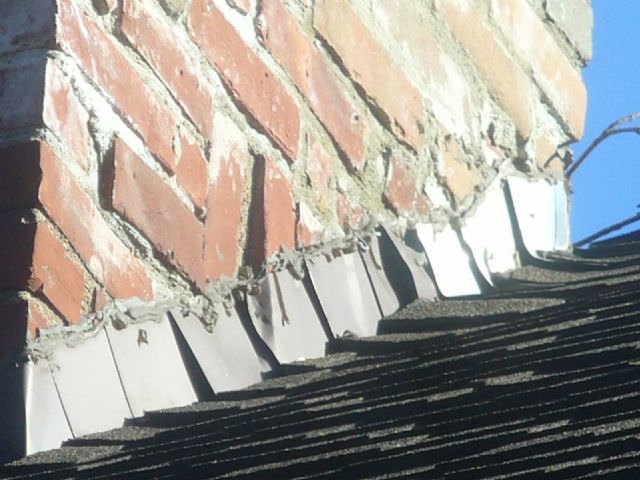

Neal Lewis Posted January 25, 2010 Report Share Posted January 25, 2010 What's the contractor's saying?- Can't see it from my house.[] The back of this chimney is barely visible from the ground. The chimney was extended up a few years ago. I like the vertical bricks thrown in there. My Lumix with the 30X zoom did a commendable job. Download Attachment: Phelps Rd.jpg 183.91 KB Link to comment Share on other sites More sharing options...

mgbinspect Posted January 25, 2010 Report Share Posted January 25, 2010 Flashing installation methods have gone to hell in a handbasket. Of course, the flashing here is a mess, but even in new construction, builders are just fine attaching counter-flashing to the surface and applying a sealant along the top edge, which drives me nuts. I used to have to rake out my mortar joints to accomodate properly installed counter-flashing or actually lay it into the brick work. Why in the world do builders abandon such tried and true systems and install something that they know sooner or later will leak. It's shameful. Link to comment Share on other sites More sharing options...
Brad Manor Posted January 25, 2010 Report Share Posted January 25, 2010 Flashing installation methods have gone to hell in a handbasket. Of course, the flashing here is a mess, but even in new construction, builders are just fine attaching counter-flashing to the surface and applying a sealant along the top edge, which drives me nuts. I used to have to rake out my mortar joints to accomodate properly installed counter-flashing or actually lay it into the brick work. Why in the world do builders abandon such tried and true systems and install something that they know sooner or later will leak. It's shameful. Our building code says the counter flashing must be let in to the masonry. I have never seen a new home in this area with embedded counter flashing. -Brad Link to comment Share on other sites More sharing options...
mgbinspect Posted January 25, 2010 Report Share Posted January 25, 2010 Brad, Maybe I have my terms wrong? The flashing in the picture is "step flashing" which would normally turn up under (what I call) counter-flashing. Maybe it's called something else. But I can say this - you won't ever see the upper piece of flashing merely fastened and pasted to an exterior surface on a school, prison, or any other building built to last a long time. Nor will you see flashing surface-mounted on older homes where an architect was involved. The upper component is always layed into the masonry which is totally unreliant on sealant and won't leak until the day water can flow uphill. You can find some fantastic flashing details in Architectural Graphic Standards, which is one heck of a book and has probably been the Bible of Architecture forever. It's an amazing book. Link to comment Share on other sites More sharing options...

Brad Manor Posted January 25, 2010 Report Share Posted January 25, 2010 Brad, Maybe I have my terms wrong? The flashing in the picture is "step flashing" which would normally turn up under (what I call) counter-flashing. Maybe it's called somehing else. But I can say this, you won't ever see the upper piece of flashing merely fastened and pasted to an exterior surface on a school, prison, or any other building built to last a long time. Nor will you see flashing surface mounted on older homes where an architect was involved. The upper component is always layed into the masonry which is totally unreliant on sealant and won't leak until the day water can flow uphill. You can find some fantastic flashing details in Architectural Graphic Standards, which is one heck of a book and has probably been the Bible of Architecture forever. It's an amazing book. Yep - we're on the same page. For flashing to be effective for any amount of time, the counter flashing should (must) be let into the masonry. Unfortunately, in my area, it never happens. In the past couple years I have looked at hundred of newly built homes, and every one of them has it's counterflashing caulked in place. It's terrible. -Brad Link to comment Share on other sites More sharing options...

Jim Katen Posted January 25, 2010 Report Share Posted January 25, 2010 They are still doing them correctly out here. The only ones that I've seen dicked up were where some handyman was hired to redo them. OT - OF!!! M. Here too. In new construction, they're pretty much all done properly. What I'm seeing more and more of, though, is roofers who refuse to cut in new step flashing on older chimneys when they repalce an old roof. They tell me that their insurance companies tell them not to cut into old chimneys to protect against liability. Most of the roofers will tell the customers up front that they'll have to hire a chimney guy to do the counterflashings. Of course, the homeowners just blow it off. - Jim Katen, Oregon Link to comment Share on other sites More sharing options...

Chad Fabry Posted January 25, 2010 Report Share Posted January 25, 2010 Be careful condemning surface mount flashing. I'll be the first to agree that counter flashing let into a reglet is the best way to flash a chimney or brick wall, however, the NRCA endorses an applied counter flashing. Late last year I was involved in some litigation concerning a faulty roof installation (as an authority, not defendant) and I'm glad I forced myself to research accepted flashing methods. I very nearly embarrassed myself. Link to http://www.nrca.net/consumer/types/asph ... #flashings Link to comment Share on other sites More sharing options...
mgbinspect Posted January 25, 2010 Report Share Posted January 25, 2010 That's a nice detail for surface mounted flashing with a nice lip for sealant. Looks great and I could live with that! Most of what I'm used to seeing is merely the cut edge of copper or aluminum with sealant applied to the junction. I have no problem at all with the detail you've posted a link to - an equally beautiful thing. And, now that you have brought that particular detail up, I have seen it in some of our larger projects - something large enough to have an architect involved. I've never seen such a nicely designed surface mounted flashing on a home. Link to comment Share on other sites More sharing options...
kurt Posted January 25, 2010 Report Share Posted January 25, 2010 Standard issue here. It works if the brick is prepped satisfactorily and a decent caulk, Vulkem or equal, is used. I still don't like it. Link to comment Share on other sites More sharing options...
