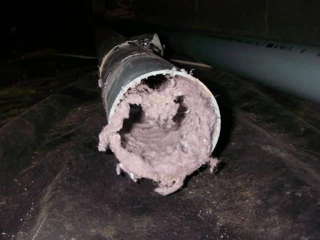

fqp25 Posted February 7, 2010 Report Share Posted February 7, 2010 Uh, when did Sewer pipe become approved for dryer vents??? At least they didn't use screws... Click to Enlarge 42.39 KB Click to Enlarge 52.57 KB Link to comment Share on other sites More sharing options...
Phillip Posted February 7, 2010 Report Share Posted February 7, 2010 You will have to check with the AHJ. They can allow this. I know they allow it where the vent is run in/under the slab foundation but not in other areas of the house like out of the wall or the roof. It would not be allowed like it is run in your photos in my area, but I have seen it done. Link to comment Share on other sites More sharing options...
Chad Fabry Posted February 7, 2010 Report Share Posted February 7, 2010 They can't allow that; the vent must be smooth walled metal. Link to comment Share on other sites More sharing options...
John Dirks Jr Posted February 8, 2010 Report Share Posted February 8, 2010 It's not metal but I bet it flows better than the accordion style crap one usually sees. Link to comment Share on other sites More sharing options...
RobC Posted February 8, 2010 Report Share Posted February 8, 2010 Static electricity would be a concern. Link to comment Share on other sites More sharing options...
plummen Posted February 8, 2010 Report Share Posted February 8, 2010 Click to Enlarge 44.04 KB Link to comment Share on other sites More sharing options...
plummen Posted February 8, 2010 Report Share Posted February 8, 2010 picture wont post! [:-weepn] had a nice shot of piece of 4" pvc that started breaking down inside and gluing lint inside of self Link to comment Share on other sites More sharing options...

plummen Posted February 8, 2010 Report Share Posted February 8, 2010 Click to Enlarge 44.05 KB Link to comment Share on other sites More sharing options...
