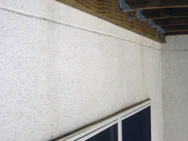

Inspectorjoe Posted March 12, 2010 Report Share Posted March 12, 2010 Has anyone ever seen this blue foundation damp-proof material before? It's a first for me. It obviously has not adhered. The house is 3 years old and never occupied. The buyer is freaked out about moisture/mold issues (she had a guy there running around taking air samples during the inspection). Click to Enlarge 59.04Ãâ KB Not related, but just for laughs, here are two more issues (of many) that this million dollar house had. It was originally listed for 1.5 million when it was completed 2 and a half years ago. The patio under the deck is below the surrounding grade. As if that's not enough, it slopes back to the building. Click to Enlarge 41.78Ãâ KB Above the patio, the deck ledger board is attached to the stucco. Click to Enlarge 52.21Ãâ KB I won't even mention the roof issues! Quote Link to comment Share on other sites More sharing options...

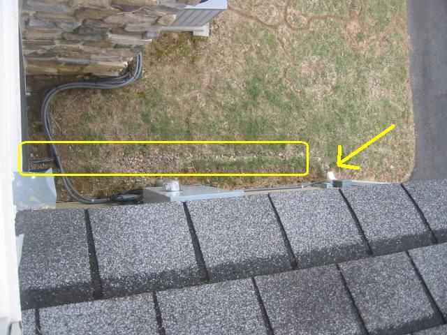

Inspectorjoe Posted March 12, 2010 Author Report Share Posted March 12, 2010 You've got a point there, Marc. The last time she was in the house, she said there was a big puddle where this stain is. Click to Enlarge 28.94 KB Jeez, I wonder if it had anything to do with the missing gutter at the roof over the rear half of the 4 car garage. The water dropping down scoured a nice gravel channel that ran back toward the house. As a bonus, the downspout that drained the other half of the garage roof was perfectly positioned to take advantage of that gravel lined channel to make a beeline back to the foundation. That took some real planning! Click to Enlarge 77.86 KB Quote Link to comment Share on other sites More sharing options...

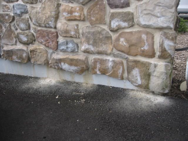

Inspectorjoe Posted March 12, 2010 Author Report Share Posted March 12, 2010 Ben: The black line is meant to be exposed. It's supposed to make the roof resemble slate when viewed from a distance. You can sort of see the effect here. Nice valley, eh? Click to Enlarge 101.49 KB Terry: It's masonry stucco. Since we're on a roll, here's another goody. This is the wall that shields the driveway from the road: Click to Enlarge 39.19 KB Click to Enlarge 60.9 KB Here's an overall shot: Click to Enlarge 52.88 KB Quote Link to comment Share on other sites More sharing options...

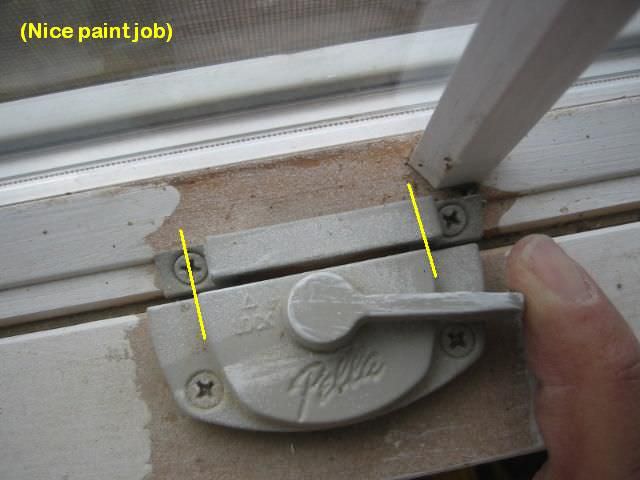

Inspectorjoe Posted March 12, 2010 Author Report Share Posted March 12, 2010 Thanks Mike! Before I posted, I tried finding it on Google, but I guess I didn't use the correct terms. I just uploaded the report. Six hours at the inspection and another 5-6 to do the report. At least I had a little fun with it. This picture was included in the report to illustrate how some window lock sections don't align. I couldn't help but include a little unrelated editorial comment.[:-slaphap Click to Enlarge 41.42 KB Quote Link to comment Share on other sites More sharing options...

Erby Posted March 12, 2010 Report Share Posted March 12, 2010 Maybe it just doesn't line up becaue you're one of them there left handed photographers!! - Quote Link to comment Share on other sites More sharing options...
Terence McCann Posted March 12, 2010 Report Share Posted March 12, 2010 Thread drift alert... Your avatar cracks me up a bit Joe... from that picture it looks like you're getting ready to take a big bite out of a shingle and snow pizza. Quote Link to comment Share on other sites More sharing options...
Ben H Posted March 12, 2010 Report Share Posted March 12, 2010 Thanks Mike! Before I posted, I tried finding it on Google, but I guess I didn't use the correct terms. I just uploaded the report. Six hours at the inspection and another 5-6 to do the report. At least I had a little fun with it. This picture was included in the report to illustrate how some window lock sections don't align. I couldn't help but include a little unrelated editorial comment.[:-slaphap Click to Enlarge 41.42 KB That is too funny.[] Quote Link to comment Share on other sites More sharing options...
kurt Posted March 13, 2010 Report Share Posted March 13, 2010 I'm not even sure how it's possible to install a window that badly. What'd they do? Load 'em in a cannon and shoot 'em at the wall? You can imagine how well the flashing pan and dams are installed........ Quote Link to comment Share on other sites More sharing options...

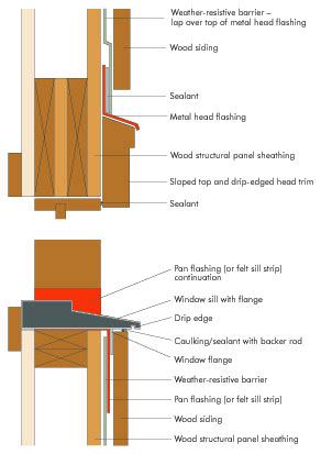

Jim Katen Posted March 14, 2010 Report Share Posted March 14, 2010 If you asked a builder around here about flashing pans and dams he wouldn't have even the feintest idea what you were talking about. It's probably just a difference in terminology but just to get on board with everybody else here, what the heck is flashing 'pans and dams'? Marc He's talking about sill pans for windows - a sheet metal flashing that goes over the bottom of a window's rough opening. It should include end dams and, sometimes but not always, a rear dam. I recommend them all the time on doors, but no windows so much. I feel that flexible peel & stick is fine there. - Jim Katen, Oregon Download Attachment: Pan Flashing.JPG 32.03 KB Quote Link to comment Share on other sites More sharing options...

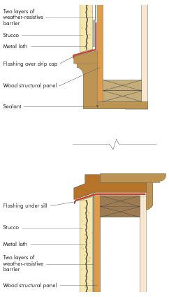

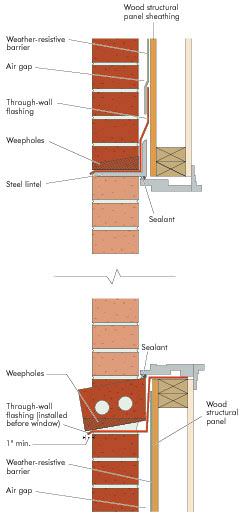

hausdok Posted March 14, 2010 Report Share Posted March 14, 2010 Like these: Click to Enlarge 182.17 KB Nobody bothers to learn this stuff anymore. ONE TEAM - ONE FIGHT!!! Mike Quote Link to comment Share on other sites More sharing options...
Marc Posted March 15, 2010 Report Share Posted March 15, 2010 Like these: Click to Enlarge 182.17 KB Nobody bothers to learn this stuff anymore. Thanks Jim. Interesting drawing Mike! That's the first time I've ever seen or heard of a wooden sill and header installed on brick veneer. Is this drawing suggesting that today's 'drainage plane/brick sill/weep hole' configuration is inadequate? Anyone have a picture of one on a house? Marc Quote Link to comment Share on other sites More sharing options...

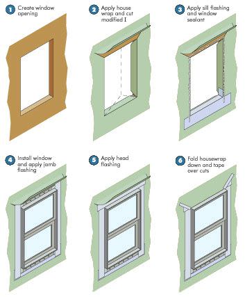

hausdok Posted March 15, 2010 Report Share Posted March 15, 2010 Hi, Here are some more recent variants: Click to Enlarge 32.61 KB Click to Enlarge 27.2 KB Click to Enlarge 14.59 KB Click to Enlarge 19.81 KB Click to Enlarge 19.32 KB ONE TEAM - ONE FIGHT!!! Mike Quote Link to comment Share on other sites More sharing options...
