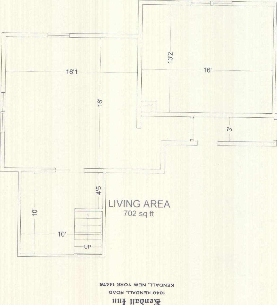

Chad Fabry Posted November 15, 2004 Report Share Posted November 15, 2004 This winter I'm finally going to update my master bathroom. In the past, while my wife and I were in the bathroom at the same time, using the commode was less than private. I'd like to install the reading chair in a "cubby" but it'll be only 32 inches wide. I thought I remembered a code saying that the walls had to be 18 inches from the center of the toilet, making the minimum width 36 inches. Is that true? There'll be no door on the toilet area. Link to comment Share on other sites More sharing options...
hausdok Posted November 15, 2004 Report Share Posted November 15, 2004 Hi Chad, I think you're okay. New York adopted the IRC last year, right? I'm looking at my Code Check and seeing: Bathroom, Toilet & Bidet, 30in. wide clearance, 21 in. at front IRC 2705.1. ONE TEAM - ONE FIGHT!!! Mike Link to comment Share on other sites More sharing options...
kurt Posted November 15, 2004 Report Share Posted November 15, 2004 Code sez what it sez. What you want is >30". The average toilet needs 28", you build to 30" and you got the space, but no elbow room. If you can find 36", go 36". Install FanTech fan system to ventilate same. Link to comment Share on other sites More sharing options...
Chad Fabry Posted November 15, 2004 Author Report Share Posted November 15, 2004 Thanks guys, I'm torn between having the aisle between the shower and toilet 4 inches narrower making it 36" or the cubby @ 32 inches. I may just make the cubby walls two inches thick..that'd solve the problem. Glue up some plywood or use some solid surfacing material. Already decided on the fan tech. There'll be two bathrooms back to back and it's the perfect solution. Link to comment Share on other sites More sharing options...
crusty Posted November 15, 2004 Report Share Posted November 15, 2004 There is a clearance issue between the separation wall and the tub/shower if I am reading this right. Link to comment Share on other sites More sharing options...
Chad Fabry Posted November 15, 2004 Author Report Share Posted November 15, 2004 With a 30' wide stall the aisle between the wall and the sgower will be 40 inches.. I'd like to keep it that wide. I'll see if I can post a plan from my cheap cad program. Link to comment Share on other sites More sharing options...

Bill Kibbel Posted November 16, 2004 Report Share Posted November 16, 2004 I believe it is a minimum 16" of clear floor space on either side of the centerline of a toilet to walls or other fixtures. I think the 18" from centerline is for a lavatory. If it is in the original old part of your home, I wouldn't worry about it anyway. Since most homes I see weren't built with indoor plumbing, bathrooms are often created in spaces smaller than most modern closets. Link to comment Share on other sites More sharing options...

Chad Fabry Posted November 18, 2004 Author Report Share Posted November 18, 2004 Here Steven, make me feel humble. Download Attachment: bath1.JPG 62.9 KB Download Attachment: master1.JPG 71.69 KB Either bathroom door can be moved on the wall they're installed on. The door to the master bath is a doorway, not a door. The funky little rectangle is a chimney. There are no interior walls in the room yet. Link to comment Share on other sites More sharing options...
