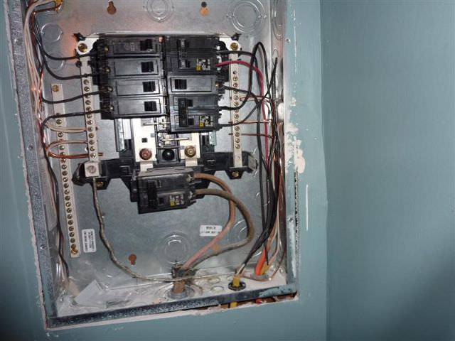

CheckItOut Posted April 3, 2010 Report Share Posted April 3, 2010 Anyone know what year they required sub panels to have four wires (hots, ground & neutral) and neutrals and grounds to be on separate bars? Inspected a 1956 house that had a new sub panel (not sure of the year but in the last 15 years for sure). I would think that the new sub panel would be required to have the separate ground and neutral wires from the main panel right? Can't imagine how they would get around the requirement here (other issues in the box as well). Two separate questions. Thanks. Click to Enlarge 52.6 KB Link to comment Share on other sites More sharing options...

Jack Davenport Posted April 3, 2010 Report Share Posted April 3, 2010 That panel is fairly new. Newer then 15 years thats for sure. I'll bet it's no older then 8 or maybe 5 years. I see incorrect breakers, multiple neutrals per terminal, grounds and neutrals on the same bterminal bar. I am going to say that if you are replacing the panel, you must install it to the code in force at the time of installation. That means the feeder cable must be correct also, both in size and number of conductors. Using the old cable that does not meet the code when the panel was installed, means that the panel can not be up to code either. So yes the feeder cable shall be replaced !! Leaving like it is creates a dangerous situation, a possible deadly situation. By having the neutral bonded down to the panel, you have created a parallel path for the neutral currents. Grounds are not designed to carry current, thats why they can be bare. Neutrals DO carry current back to the source. By having the neutral bonded to the panel can you have now allowed those neutral currents to flow on the exposed metal can, the metal panel cover, and any thing else that is grounded,( water pipes and such) In a fault there can be an extremely large amount of current going across those metal parts. be Smart and cover you r butt- Call it out as dangerous and incorrect. Link to comment Share on other sites More sharing options...

Jim Katen Posted April 3, 2010 Report Share Posted April 3, 2010 Anyone know what year they required sub panels to have four wires (hots, ground & neutral) and neutrals and grounds to be on separate bars? 1923. There were exceptions for dryers & ranges and for separate buildings, but those exceptions went away in 1996 & 1999. Inspected a 1956 house that had a new sub panel (not sure of the year but in the last 15 years for sure). I would think that the new sub panel would be required to have the separate ground and neutral wires from the main panel right? Can't imagine how they would get around the requirement here (other issues in the box as well). That's the sort of thing for which the AHJ might make an exception. However, yes, if someone were actually to follow the rules, a sub panel from that time period would certainly have needed a 4-wire feeder unless it was in a different building. - Jim Katen, Oregon Link to comment Share on other sites More sharing options...

Jack Davenport Posted April 3, 2010 Report Share Posted April 3, 2010 I read the original post as having the subpanel in the same structure/building as the main(service) panels is located in. That being the case article 250.32 does not come into play as that is for a separate buildings / structures. Article 250.32 (A) - tells us that buildings or structures fed by a feeder or branch cicuits SHALL have a grounding electrode OR a Grounding electrode system. This means a ground wire ran with the feeder or a grounding electrode system installed as per article 250.50. The ONLY exception to this is when a single branch circuit is ran to the structure. The original post shows neither of these. So either way there must be a grounding electrode conductor or a equipment grounding conductor The original post shows neither of these Also don't forget, the feed to a sub panel is a FEEDER Article 215 tells us about Feeders. 215.12 tells us about Identification for Feeders 215.12(A) Grounded Conductor (neutral) The grounded conductor of a feeder SHALL be identified in accordance with 200.6 200.6 Tells us that the grounded conductor (neutral) needs to be INSULATED. The original post shows a BARE grounded conductor (neutral) So that install is incorrect on a multitude of different levels. NO grounding Conductor ( or ground electrode conductor if in a separate structure) The use of a bare grounded conductor Grounding conductors and grounded conductors in the same terminal Multiple grounded conductors in the same terminal incorrect circuit breakers I can tell by the picture, but if that main back fed breaker is a snap in and is not held in place by a fastner that requires other then a pull to release it, it needs to have one installed according to article 408.36 I would also question the size of that grounded conductor, looks small to me but it may not be. Link to comment Share on other sites More sharing options...
