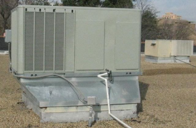

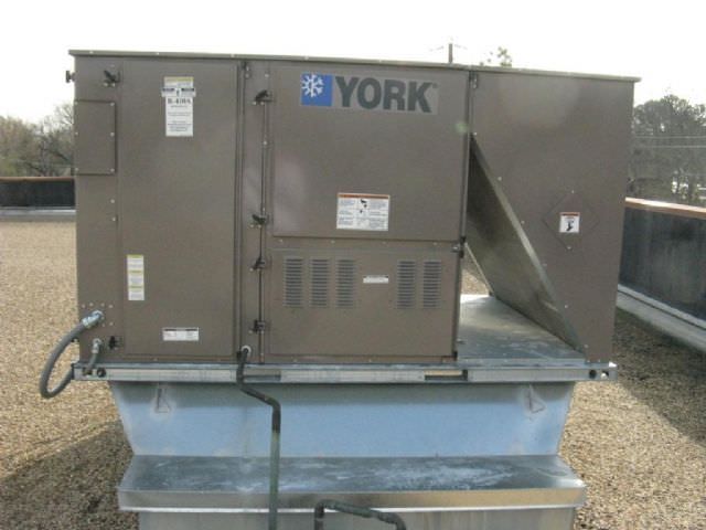

MPdesign Posted April 6, 2010 Report Share Posted April 6, 2010 Hello All, I know that I have some pretty lame brain questions sometimes so why should this be any different? [:-dunce] Is it possible to tell visually if a unit has an economizer or not without opening the unit and looking inside at the damper? I have included a few rooftop package unit examples. Click to Enlarge 44.89 KB Click to Enlarge 42.09 KB Quote Link to comment Share on other sites More sharing options...
Terence McCann Posted April 6, 2010 Report Share Posted April 6, 2010 The short answer is no Joe. You can have o/a dampers that are just used for 10% makeup/fresh air into the building. If you are writing a report, and need to verify the presence of an economizer, you really should pull a panel to look and also have a peek at the wiring diagram/control logic. Quote Link to comment Share on other sites More sharing options...
