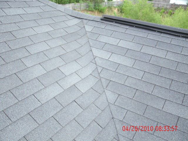

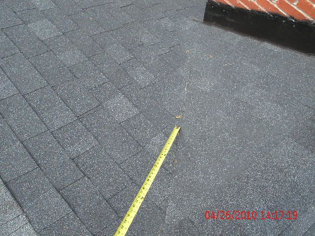

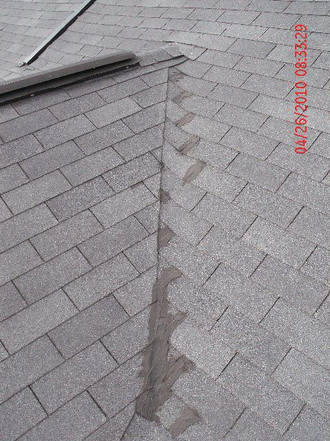

Phillip Posted May 2, 2010 Report Share Posted May 2, 2010 In my area they are called cut valley. I write them up if they are not cut where the greater water slope or greater pitch. I had 2 of them on the same day last week. The first one is where they repaired around the chimney. Click to Enlarge 115.78 KB Click to Enlarge 86.52 KB The other one was on a 4 year old town house. The cut was 4 inches from the center line and someone had patched on it. Click to Enlarge 110.92 KB Click to Enlarge 78.75 KB Quote Link to comment Share on other sites More sharing options...

David Meiland Posted May 3, 2010 Report Share Posted May 3, 2010 The other one was on a 4 year old town house On that one I would have cut the other roof plane, since it extends above the one that they chose to cut. And, what are we looking at there, it appears to be Cor-a-vent nailed over the top of the cap shingles? Quote Link to comment Share on other sites More sharing options...
Jim Katen Posted May 3, 2010 Report Share Posted May 3, 2010 . . . This is what I'm talking about. . . I call those kind of roof sections "funnels." I see at least one a week. The better roofers install them with mod bit membranes that run a couple of feet up the adjacent steep roof and at least a foot up the opposite sidewall. The bozos don't treat them any differently than a regular roof. They do fine until a tennis ball gets lodged in the narrow end. - Jim Katen, Oregon Quote Link to comment Share on other sites More sharing options...
Phillip Posted May 3, 2010 Report Share Posted May 3, 2010 The other one was on a 4 year old town house On that one I would have cut the other roof plane, since it extends above the one that they chose to cut. And, what are we looking at there, it appears to be Cor-a-vent nailed over the top of the cap shingles? That the way they install ridge vents here. Quote Link to comment Share on other sites More sharing options...
