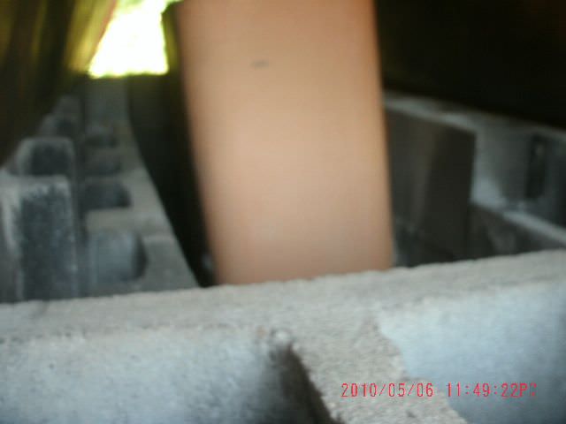

John Dirks Jr Posted May 5, 2010 Report Share Posted May 5, 2010 The top section of liner was raised by stacking it on bricks. Was this done because lazy builders did not want to cut an additional piece to make the liner the right height? It serves a gas furnace only and this gap is above the roof line. Is this a problem that should be written up? I know it's shoddy workmanship, but what else? Click to Enlarge 31.29 KB Quote Link to comment Share on other sites More sharing options...
kurt Posted May 5, 2010 Report Share Posted May 5, 2010 Good find. I'd for sure put it in my report, and tell them to get a tech out to line it or otherwise repair it. Reality says it's a very unlikely problem given the particulars, but there's reasons the liner is supposed to be tight and continuous. And, I've heard back that I missed something like this (once that I know of, and probably more times that I haven't). The customers weren't pissed because I pointed out a lot of other stuff that said the heating system was nasty, but I hate hearing stuff back. Always put stuff like this in the report. Quote Link to comment Share on other sites More sharing options...
John Dirks Jr Posted May 5, 2010 Author Report Share Posted May 5, 2010 Thanks for the quick feedback. I'll put it in the report and let them sort it out among the rest of the stuff. Another thing, the fireplace (different liner but same chimney) had a gas log added. It's a masonry unit with a huge ash dump pit that can be see looking through a door in the basement. The pit was full of ashes from way back when. Are those ashes hurting anything by being left in there? It's a pretty big pile. Quote Link to comment Share on other sites More sharing options...
Bill Kibbel Posted May 5, 2010 Report Share Posted May 5, 2010 The top section of liner was raised by stacking it on bricks. Was this done because lazy builders did not want to cut an additional piece to make the liner the right height? Yep - a common cheat. It serves a gas furnace only and this gap is above the roof line. Is this a problem that should be written up?Yep. The T/C flue liner is looking quite pitted as well. Probably about due for relining anyway. Was this chimney venting an oil-fired system previously? Quote Link to comment Share on other sites More sharing options...
John Dirks Jr Posted May 5, 2010 Author Report Share Posted May 5, 2010 Bill, I'm pretty sure its been nat gas all along. Quote Link to comment Share on other sites More sharing options...
Neal Lewis Posted May 5, 2010 Report Share Posted May 5, 2010 Some chimney guys who do video scans will "fail' the liner if the joints aren't fully mortared. I see that exact situation frequently. I tell them exactly what Kurt said, and advise that a chimney pro can decide what the best course of action is. Bill, the pitting seems to be very minor on the surface. chimney guys I know wouldn't even blink at that amount of wear. John, did you take a cap off to check the liner? Several HI's have told me not to take the cover off- liability, etc., but there's a lot of good stuff to see by taking them off. Quote Link to comment Share on other sites More sharing options...
John Dirks Jr Posted May 5, 2010 Author Report Share Posted May 5, 2010 I took it off. Click to Enlarge 49.76 KB Quote Link to comment Share on other sites More sharing options...
Bill Kibbel Posted May 5, 2010 Report Share Posted May 5, 2010 Bill, the pitting seems to be very minor on the surface. chimney guys I know wouldn't even blink at that amount of wear. I would agree, specifically if it's only the top section. Once the vitrified "surface" is breached however, it will spall fairly rapidly. Unfortunately, many sweeps here will insist on relining, even if the pitting/spalling is only to the top section. They will also call a liner unsafe if the flue tiles are misaligned at the joints more than 1/8"! Most sweeps here will not "fix" what John has pictured and will insist on relining. Some will use it as an opportunity to condemn the entire chimney and insist on rebuilding. Quote Link to comment Share on other sites More sharing options...
kurt Posted May 5, 2010 Report Share Posted May 5, 2010 Yes. All the "new" NFPA and IRC guidelines regarding flue liners has created open season for all sweeps and chimney repair folks. Plenty of guys running around condemning flues that just aren't all that bad. Quote Link to comment Share on other sites More sharing options...
John Dirks Jr Posted May 5, 2010 Author Report Share Posted May 5, 2010 I think I remember a similar discussion not too long ago. Sooner or later, someone will call it out. Since I just looked at it, it might as well be me who calls it first. Quote Link to comment Share on other sites More sharing options...

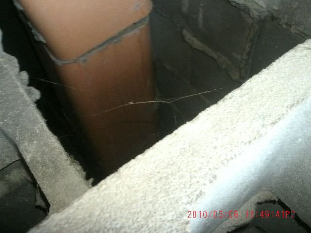

Phillip Posted May 6, 2010 Report Share Posted May 6, 2010 Here is a chimney from today. Click to Enlarge 92.32 KB Click to Enlarge 24.72 KB Click to Enlarge 40.81 KB Quote Link to comment Share on other sites More sharing options...
Marc Posted May 6, 2010 Report Share Posted May 6, 2010 That's the first time I've ever seen a masonry chimney without the cap. Marc Quote Link to comment Share on other sites More sharing options...
Tom Raymond Posted May 7, 2010 Report Share Posted May 7, 2010 I'm not sure I'd call that a chimney. Quote Link to comment Share on other sites More sharing options...
